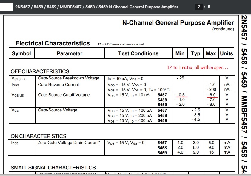

- your transistors are different than Aguilar's; odds are they bought 5 or 10 thousand from as many production lots as possible, then selected the ones meeting their Idss and Vgs(off) requirements (see included PDF excerpt); latter spec can be anywhere within a 12:1 range(!), and sets the operating point
- your pickups are not Aquilar; we're trying to adapt a design that seems to be pretty cleverly designed, from the ground up, for a very different pickup; If the same designer were tasked with designing for the pickup(s) you're using, a completely different design might result.

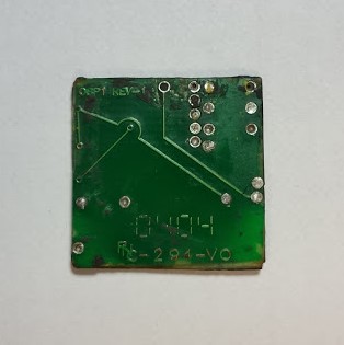

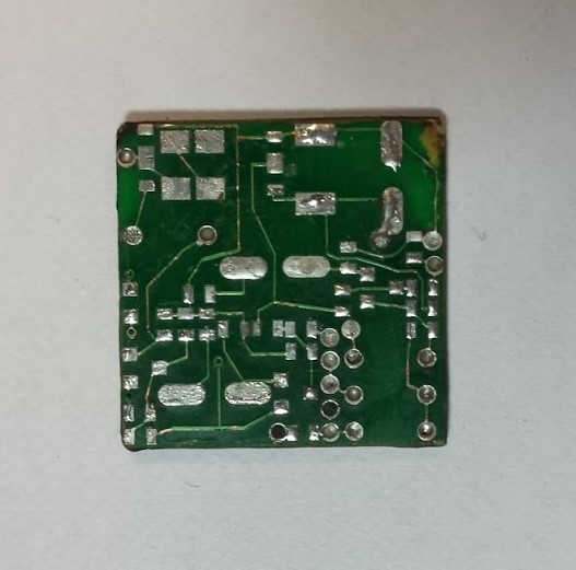

I don't think I realized that you owned an Aguilar preamp! Is it encapsulated, or could you take some measurements on it? Current draw at 9 and 18V would be a great place to start. Then Drain voltage of each stage would also be revealing (at 18V-only would be fine).

Could be different transistors, or they bought thousands of them and picked the ones that best fit the circuit. Anyway, we'll try to work with what we have, i got 10 more so i'll measure those. What is an accurate but simple way to measure them?
The bias trim is still there, not sure if i can swap the legs though, i got the PCB factory made already, I'll try to work it out as it is, i guess that won't be the biggest issue...

Yes i do own the Aguilar OPB-1 which is this circuit more or less, unforutnately it's not here with me in Australia, so i can't test anything �� And it's encapsulated in rock solid black epoxy. The only thing that i found is that some guy decided to completely destroy it to get inside and i only have a photo of the PCB. I'll attach it below but not sure it will be of any help, it's bare PCB.

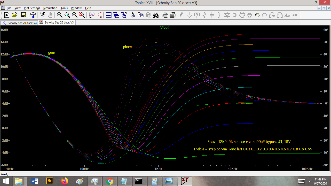

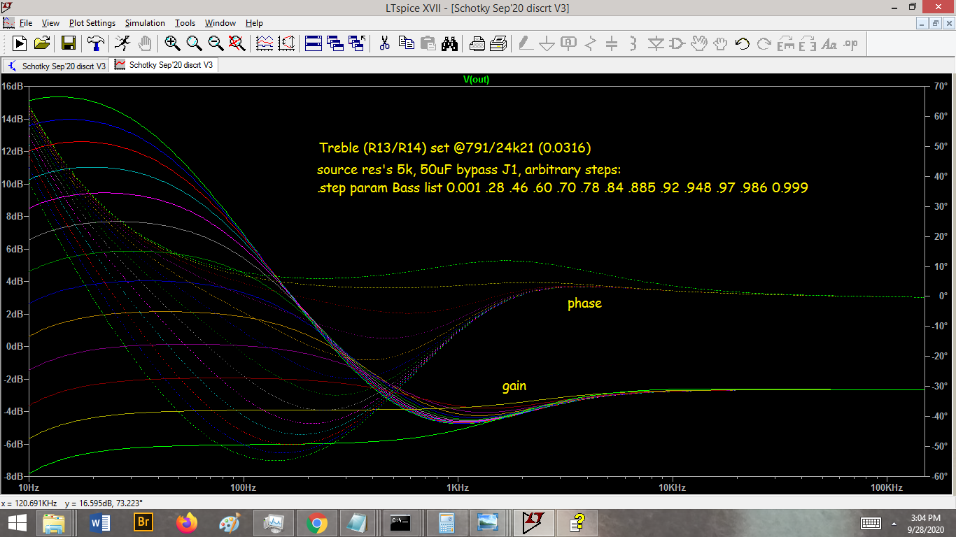

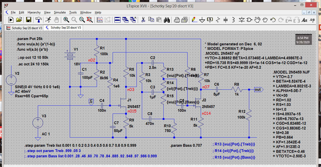

Some very interesting things have turned up playing with this circuit in LT Spice (besides that I'm not very good with it!😱). Here are some of the discoveries so far . .
- the transistors originally fitted are 'not very conductive'; according to LT Spice and the admittedly poor model, your Drains should be around 10 or 10-1/2 volts
- none of the combinations of bias voltage / Source resistance (collectively: 'operating point') / supply voltage (that I've tried) can produce the results you have so far
- when your 10 new transistors come in, we might want to devise a not-too-difficult-to-implement test to select a couple that might be more suitable
- if you keep the two first fitted we should bump up the Drain resistances - maybe 15, 18 or 22k; if I can figure out how to fiddle the 2N5457 model I have (or somebody on here tells me), I might be able to figure how much. It'd probably be good to simulate it first 'cause it'll almost certainly affect the response curves, which are already a little odd.
- The tone stack is producing a large dip, an octave or two wide, varying from 200 to 400 Hz. It may be exactly what you want. But if it were me I'd much rather apply it intentionally with an EQ, than to have it as an inescapable side effect of the tone controls. Especially since it varies in both depth and center frequency as they do.
The 'op point' file has some interesting data. Admittedly, sorting useful bits out of it is quite a challenge even with the LT Spice screen for the node references. But it does show a couple of options that only consume 1.2 and 1.7mA, so it is definitely possible to lower the battery drain.
Have a look at the FR curves. If I still have a minute before I upload this stuff I'll go back and annotate a few nodes (on the JPG of the LT Spice screen shot).
There's still a lot to simulate concerning the operating point; so far most of the sims have been using the 5k Source resistors and 1,48V bias divider. I'm pretty sure that is not optimum.

I got them a few days ago, labeled as Fairchild, hopefully are genuine but who knows.- when your 10 new transistors come in, we might want to devise a not-too-difficult-to-implement test to select a couple that might be more suitable

I think that tone stack (it's a Fender tone stack btw) is meant to function that way, the dip even matches the frequencies shift 200-400Hz you mention. When you adjust Bass/Treble, the mid scoop shifts its frequency a little. It sounds really good on bass though. I don't know how much effort there is to make this "on purpose" as you say, but we can leave it as is if too much time will take to get the same result actually, i don't know how this is done 🤔. If you use Duncan's Tone Stack Calculator, under Fender tab it will give you a nice simulation of the tone stack only. Below i have attached the Tone Stack Calculator file settings for Fender tone stack. Give it a check.- The tone stack is producing a large dip, an octave or two wide, varying from 200 to 400 Hz. It may be exactly what you want. But if it were me I'd much rather apply it intentionally with an EQ, than to have it as an inescapable side effect of the tone controls. Especially since it varies in both depth and center frequency as they do.

The curves looks somewhat similar what the Tone Stack Calculator produces, check the settings file i've attached and see how it looks. It's only the tone circuit though, not the whole preamp.Have a look at the FR curves. If I still have a minute before I upload this stuff I'll go back and annotate a few nodes (on the JPG of the LT Spice screen shot).
One thing though, I see you've put the Source cap in the first stage. When I do this in the circuit i'm getting distorted sound no matter the Source resistance or bias value. When I put the cap in the second stage, it sounds normal..... then, the resistor value in the second stage is about 5k with the cap in, and in the first stage the resistor is about 10k (no cap). This sounds pprobably at least 95% the same as with both Source caps out just much lower current draw. Less than 0.7mA. The only drawback is the frickin random RF, barely audible but randomly present.There's still a lot to simulate concerning the operating point; so far most of the sims have been using the 5k Source resistors and 1,48V bias divider. I'm pretty sure that is not optimum.

As far as the new transistors go, we'd better leave those aside for now. They'll only introduce more variables unless/until we can measure more accurately. And please, no more trimpots -- I LOVE the little stinkers, and have used many over the years. But the variables go up exponentially once you have several, quickly exceeding my ability to analyze and respond back. (You seem to be a much faster, more efficient writer than me.😉)
The only reason to consider the higher Drain resistors was when we thought there were only 1,56 and 2.92 volts across the 10k parts. Those are currents of 156 and 292 micro-amps if we ignore what additional load the meter may contribute. Either way it implies 'too high source resistance'. If we kept that it would have meant higher output impedance and lost dynamic range.
The bypass cap on the 1st stage was only to see how close LT Spice could get to the results you were describing. I don't (and hadn't intended to) recommend it/them. The 1st stage distortion is likely a combination of higher gain and lower operating current (Source resistors 5 and 10k at the time IIRC).
The RF leakage should be eliminated by a small capacitor from Source to Gate of the 1st stage; 100 or 150pF would work. Not my idea, but it's a good one.

Let's try fitting a fixed resistor for each Source, 1k5 (16,5dBV gain) to 2k7 (11,4dBV gain), setting the bias in the 0,35 to 0,8V neighborhood, fit the small cap Gate to Source on the 1st stage, and see if it gives acceptable performance and power drain.
I'll keep fiddling the simulator model.
I have put 100p on both stages, it eliminated the RF by at least 95%. With even more testing (the Source trimmers are hanging on a 10cm long wire though) I accidentally discovered that the trimmer's wires are the antenna of the circuit... I touched one of them and the radio signal got boosted by probably 5x! On the radio they said that Australia is very different in dating than the rest of the world... interesting info I think they're right xD, damn it was a litteral radio receiver. When I put resistors in instead of the trimmers I guess the rest 5% will go away too cause there will be no wires to the resistors to pickup RF.

Found a simulator model that seems to more closely resemble your FET's. (Yay!) Still have some testing loose ends to tie up, but so far I can safely suggest ..
- remove all 3 trimpots
- fit 1k8 or 2k2 fixed resistors in each Source leg; use leaded parts if necessary
- connect the free end of the bias 1 meg resistors to ground
- fit a 100pF to 220pF ceramic capacitor, Gate-to-Source on the 1st stage
- measure the Drain voltages with power applied, both 18V and 9V
- measure the Source voltages, same as Drain
- measure the current draw
Then we'll do some arithmetic to confirm how trustworthy the values are. (Remember, the S and D currents are identical -- the voltage drop must be proportional to the respective resistances. It should also be reasonably close to the same current draw at 9V as at 18V.
If it looks like meter loading is still a problem, we'll devise a buffer -- either using one of the batch of new transistors, or use the 2nd stage (to measure the 1st).

Did that and results are:
On 18V:
- current draw: starts at 0.4mA and then stabilises to 0.23 in about 20-30 sec
- D voltages: 16.8V on both
- S voltages: 0.2V on both
On 9V:
- current draw: starts at 0.25mA and then stabilises to 0.18V in also about 20-30 sec
- D votages: 8.1V on both
- S voltages: 0.14V on both
Sound vise: clips and compressed, not a lot but is clealry audible, something like a staring level of an overdrive. With 1k8 S resistors gain is a little less than 1.
