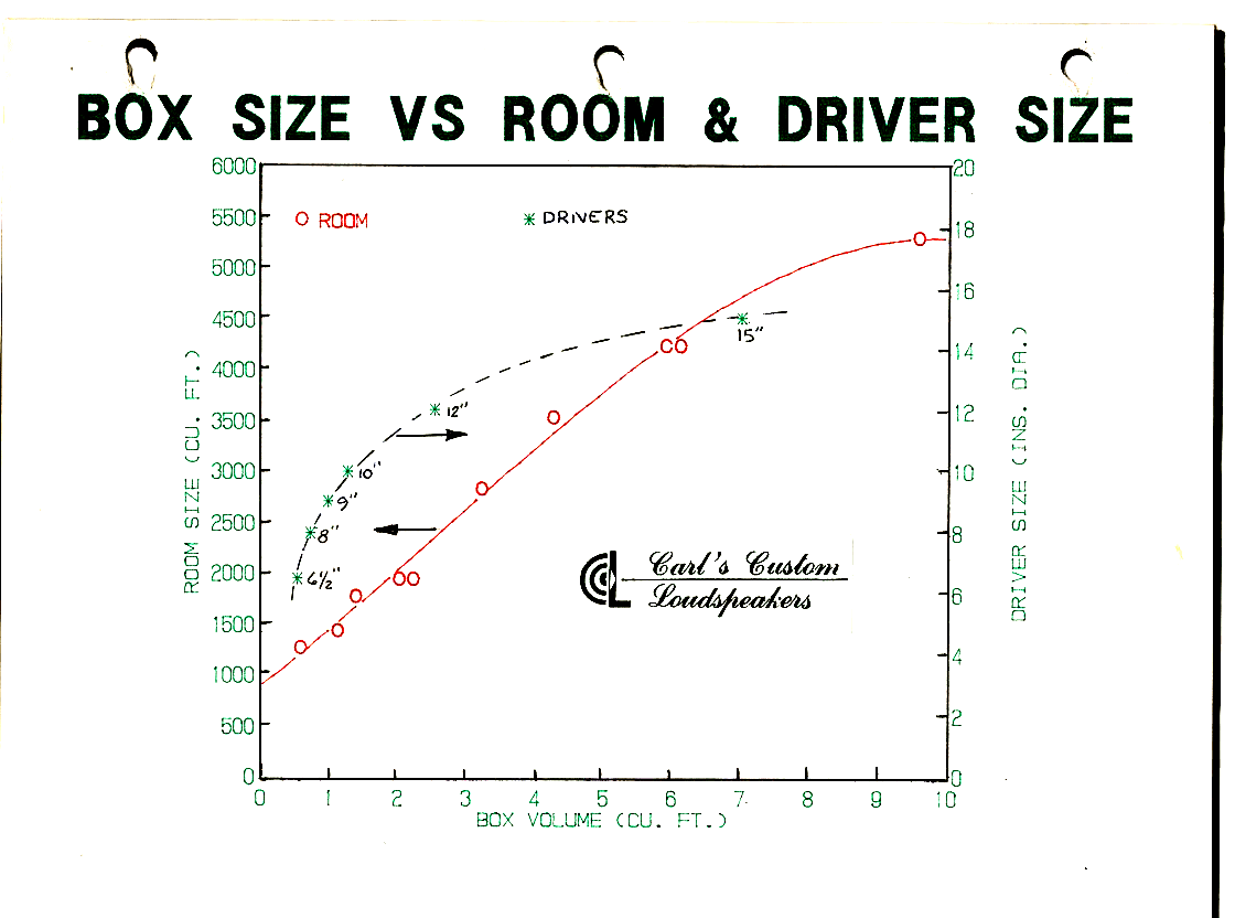

My listening area is 15ft 6in long, 11ft 3in wide and 7ft 6in high. I like the sound of big speakers and before I move forward with the bass section of my 3-way (1.4in CD with 10in mid) need more info about drivers vs room size. Btw I'll be using minidsp to bring the room under control.
Larger drivers couple with the room better and I'd happily have a 18in driver but was wondering: Is it better or is there any harm/benefits to have more bass capability than is needed for your room and dial it back? Is there any sort of bass driver/multiple driver total radiating area vs room size correlation?
Larger drivers couple with the room better...Is it better or is there any harm/benefits to have more bass capability than is needed for your room and dial it back? Is there any sort of bass driver/multiple driver total radiating area vs room size correlation?
When you come from the perspective of minimizing distortion, larger woofer areas move less for a given SPL at low frequencies. The types of distortion that are prevalent include the familiar harmonic distortion, of which it's been shown that only the higher harmonics are typically audible (i.e., 4th-10th harmonics, etc.). But those harmonics also turn into higher frequencies that modulate with the fundamental frequencies, producing non-harmonic sideband peaks. For woofers, the predominant type of modulation distortion has shown to be AM distortion, i.e., not Doppler--otherwise called FM distortion--which is the predominant modulation distortion type for higher frequency drivers: midrange, tweeters (see Klippel's paper on modulation distortion measurements, also Nelson Pass's article on distortion in amplifiers, pg. 6ff). AM distortion is due to nonlinear properties of the much greater woofer diaphragm motions than midrange/tweeter diaphragms.
So larger is better in order to reduce distortion during music peaks and low frequency impulses, like kick and bass drums. The penalty of using smaller woofer areas is not being able to turn the SPL up to anything much above fairly low listening levels, and having to ignore those modulation distortion bursts during LF transients (which people that haven't been exposed to live instrument sounds have learned quite well to ignore).
The best kind of bass, IMO, is horn-loaded, because the AM and FM distortion products move about 15-20 dB lower than the same drivers used in direct radiating mode. That's why horn-loaded bass sounds as good as it does (when done well).
I once had the opportunity to listen in-room to direct radiating ported cabinets having 1, 2, and 4 (15" diameter) woofers per side, and also a very good corner-loaded fold horn cabinet. The single and dual woofer cabinets had a definite "edginess" and artificial quality to their sound, while the quad woofer cabinet had a much more natural sound, albeit with the sound of "splintering wood" when driven hard. The horn-loaded cabinet sounded like the real thing.
So to address your question: there are no limits to woofer area/size of room, although at some multiple of woofer area size, the effects of direct radiation begins to disappear, except for the impulsive transients. Larger total woofer areas are better.
The tradeoff, of course, is a lower high-frequency roll off of larger diameter woofers, and the need to cross to the midrange drivers at a lower frequency. One way to get around this is to use multiple smaller woofer drivers, but then the 1/4 wavelength separation distance between the drivers playing at their highest frequencies start to create polar lobing issues. The other part of the tradeoff is size.
So the discussions about room coupling are mostly related to the small size of the diffuse region of the room (which is at a quite high frequency in a small listening room). I look at this situation differently: at what frequency do you need to start adding extra surround channels to add apparent spatial width/depth, and how many absorption panels to control early reflections around the loudspeakers themselves? The type of acoustic absorption panels used by virtually everyone however don't have much effectiveness below 100 Hz (and about 70 Hz for bass traps). This is the real limitation of smaller listening rooms--controlling early reflections, and usually not at the lowest woofer frequencies, i.e., usually above ~100-200 Hz for small rooms practically.
So my experience is to use as much "woofer area" as is tolerable in-room. For horn-loaded woofers that means horn mouth size: the larger, the better to control AM distortion and to lower the effective "Fc" of the room-loudspeaker array.

Again, larger the cone area the better, as soon as a speaker starts to move it distorts, the more it moves the more it distorts, as far as I'm aware there is no way around this. So, logically a horn would be best? I would like to try one for clean low bass, at the moment I have 4 12in woofers in U frames, without EQ and for the levels I listen at I don't ask them to move much. Room size doesn't really come into the equation
Again, larger the cone area the better......... Room size doesn't really come into the equation

I'm going 3-way because I want the benefit of having 150-1500hz handled by one driver and the crossovers being outside of that important range. So my bass enquiry only covers say 200hz downwards.
If piston area is king, what would be the practical difference between a single 18inch and a dual opposed 12inch setup?
Also Is there anything important to weigh up regarding driver size matching the midrange 10inch driver?
