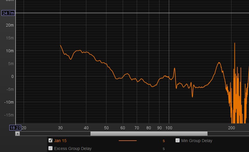

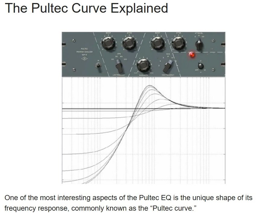

To get the kick, I think you need: To be able to move plenty of air without too much distortion. Then, similar to what others have suggested, add a HPF with a peaking response that reduces some of the lowest bass frequencies below about 60Hz and adds a peak in the 80Hz to 100Hz region. The filter tricks the brain into thinking there's more bass when there may actually be less. It's a common studio technique to use peaking HP/LP filters like the Pultec in this way or flipped to cut before boosting for other effects. Another way is to place the speaker driver in a (un)suitably tuned box, that's what the cheaper subs do to get the same result ie a peak before a roll-off. Here's a thing I pulled from the interweb, fair use?
Cheers, Ralph

Indeed! Though I am not sure about the distortion. Because it creates higher order content, that has the potential to be faster, making it sound kickier and more structurated. When I hear the drywall ceiling to rattle in the bass, it is somewhat satisfying to have sharper noises added to it, than just hummm. "Raaarrrr" bass is appealing. :-D
In addition to chest kick, there can be tactile feel on skin and eyeballs as some one already mentioned. fun stuff. For example arpeggio / rhytmic synth on Kraftwerk's The robots has such tactile feel to it. Sufficiently intact impulse, enough pressure variation to make some touchy feel to it, or something. I bet bad group delay could reduce this peak pressure and effect, while added distortion (harmonics) without time smear could enhance some. Just speculation, perhaps it's something else. I think kimmosto has talked something along the lines of skin feel at some point, likely many others too 🤔
