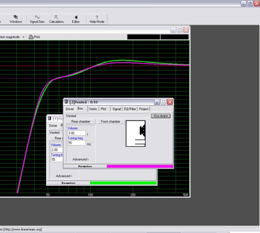

The problem with the 8 ohm version is high Qts, 0.77 compared to the 4 ohm 0.56.
Theory is one thing, finding a driver with the right parameters so you can use it another.
Ideally we want something around 0.45 with low Vas.
The 4 0hm Visaton models fairly well in a 2 litre box with a port
tuning of 55Hz and high pass filter with f = 55Hz Q=2. The mild
1.3dB peaking at 165Hz will be fairly irrelevant after you have
added EQ for Baffle Step Compensation (active again!).
Bass power handling will be fine for a 15W 4ohm amplifier.
No point making the box bigger than 2 litres.
Also note there should be some taper to the bass as above.
Trying to be flat to cut-off will sound boomy and one-note.
🙂/sreten.
using 3 litres decreases the hump at 165 hz and
reduces the boost needed at 55Hz from 6dB to 3dB.
The two responses for the two cases are almost identical.
Without the boost the 3 litre is obviously superior for bass.
🙂/sreten.

you ignore the manafacturers curve in the bass,
response is derived from parameters.
in WinISDpro you add the boost using the
"peaking 2nd order highpass" option.
This will give you the bass response.
shown are the curves for the figures I stated previously.
🙂/sreten.

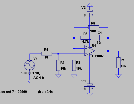

the next area to address is baffle step compensation.
This is easily implemented again in the fedback loop using a RC
series combination in parallel with the higher of the gain setting
resistors, this resistor is also increased in value to suit.
The parallel value of the two resistors = previous gain setting value.
Centre frequency of the baffle step depends on the baffle width.
I recommend 3dB of BSC.
(they aren't going to be used on stands in free space)
It is easy to make this adjustable with a pot, if so, 0 to 6dB BSC.
Its also possible to include a passive treble control by using an RC
in parallel with the lower of the gain setting resistors, again 0 to 6db ?
🙂/sreten.

the effect of BSC depends very much on the size of the driver you
choose in a simulator, I've heard in practical terms if the driver is
more than half the baffle width BSC is relatively smooth.
In most commercial 2 way speakers the bass units inductor is
oversized and comes in early to effect baffle step compensation.
As I said before you can mod the the feedback resistors to give
you around 4dB BS, a simple RC circuit will have a slope very
near what is required.
For some measured results of BSC, always good for a sanity check,
see : http://zaphaudio.com/
🙂/sreten.

now I've assembled (err, only at my computer) the thing I thought you meant to compensate for the baffle step.
It could be about right for my box, and I'll leave fine tuning until I'll have assembled and measured the speakers in the housing.
Was it the circuit you were thinking of or did you mean something else?
Dominique
