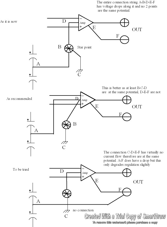

A final point
If we agree that the point on the module where all the grounds come together is the true reference then this is the true star ground point and all other points are referenced back to it. A true reference point connects to all the other points with a single wire so there is no current flow only the transfer of the absolute voltage. Obviously we can’t have this in this situation as we have many and various currents flowing into and out of this reference point. In order to transfer the absolute value of voltage from this reference point to another point we are calling the star ground it is very necessary that this particular connection not carry any current other wise the I/R drops will mean the star point is not at the true reference potential. To do this requires the extra connection to the cap tie point to carry the heavy output signal current. I will want to experiment and make this particular connection directly to the – speaker terminal using the connection from there to the module as only a low current reference ground tie point.
This gets hard to visualize so I will do a drawing.
I had to develop a good understanding of grounds when I designed a very high resolution scale system. LSD was 10nV! I did make it work but it took some effort.
Roger
How can I post with reasonable resolution? I keep getting rejected for too large a file.

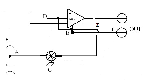

Hmmmmm,
First of all, I feel I know you well enough to say, curse you for making me spend time in MS Paint!
That's not really at all how I view the module. So I've edited your drawing to better reflect my vision of it, and how I would therefore implement it.
I also think this better depicts possibly why Hypex hasn't spelled out to use a star scheme. It's already there where it matters most.
In fact the true reference you're after is not simply earth potential, it's that which the source see's, anything less is a mean ground loop.
There's only one ground comming off the module, the other two are more like ground inputs, but they all interconnect within, forming a star if you will, which you then branch off to the main star with a single wire, and the node between PSU caps connects there as well, with the heavy gauge, short lead.
What do you think?
What do you think?

As to using paint, I refuse! Hate it! Try downloading a free trial version of SmartDraw. I don’t know if it turns off after the trial period or just adds the trial message at the bottom.
It is really nice the way you can output in just about any format. Too bad it is just too expensive for me.
http://www.smartdraw.com/product/ste/index.htm
Your drawing is essentially the same as the one I did only showing a further connection that I didn't. All the points I made about current flow still are valid! I/R drops along the path will degrade the reference to the point that output no longer is a true function of input if it is referenced to the external star point. The only place it would be correct is referenced to the point D on your drawing. Of course if the input is fully differential there should be no problem.
Like I said we may be picking nits here and need some input from Bruno. Wonder if he is back from his trip?
Roger

It's hard to tell without knowing how you wired it, but I'd say start by making sure you have all the phases of the secondaries in proper order. If you have a static shield with it make sure it's earthed. Is your center tap earthed? Double and triple check your rectifier connections as the next step.
Can give more help if you gave us a schematic of how you wired it or a picture maybe.
Oh, and for your own good, keep your modules disconnected until you get this sorted out.
classd4sure,
Thanks for the advice. I broke it all down and tested each transformer and rectifier stage separately. I was second guessing the ratio of the windings but my issue was sharing a couple connections on the secondaries in parallel. Dumb.
Boy it sure sounds different from the 300B. I am not sure if there is a break in period but it will take a bit of getting used to.
Thanks for your help.
