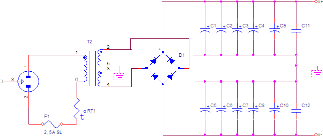

This gets hard to visualize so I will do a drawing.

How can I post with reasonable resolution? I keep getting rejected for too large a file.

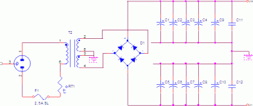

Hmmmmm,
First of all, I feel I know you well enough to say, curse you for making me spend time in MS Paint!
That's not really at all how I view the module. So I've edited your drawing to better reflect my vision of it, and how I would therefore implement it.
I also think this better depicts possibly why Hypex hasn't spelled out to use a star scheme. It's already there where it matters most.
In fact the true reference you're after is not simply earth potential, it's that which the source see's, anything less is a mean ground loop.
There's only one ground comming off the module, the other two are more like ground inputs, but they all interconnect within, forming a star if you will, which you then branch off to the main star with a single wire, and the node between PSU caps connects there as well, with the heavy gauge, short lead.
What do you think?

Very interestings thoughts from you guys though you got me a little lost techically speaking. I'm sorry about the quality of the photos above, so I drew this little thing to make it easier (signal connection is not represented):
In fact, i've used two small cable to connect supply ground from the UCD to the ground point (which is the srcew where the trafo is well .... screwed!). I should replace these very soon with proper speaker cable.
When I look at the UCD manual it's true that this wire goes from the module to the caps ground and then to the chassis ground, I'll try that, although classD4sure doesn't agree.
Apart from that, I checked all cables continuity and it's good, the blue LED on the module shows its soft light, so I guess I'm not so far from hearing sound coming ou of it 🙄

As to using paint, I refuse! Hate it! Try downloading a free trial version of SmartDraw. I don’t know if it turns off after the trial period or just adds the trial message at the bottom.
It is really nice the way you can output in just about any format. Too bad it is just too expensive for me.
http://www.smartdraw.com/product/ste/index.htm
Your drawing is essentially the same as the one I did only showing a further connection that I didn't. All the points I made about current flow still are valid! I/R drops along the path will degrade the reference to the point that output no longer is a true function of input if it is referenced to the external star point. The only place it would be correct is referenced to the point D on your drawing. Of course if the input is fully differential there should be no problem.
Like I said we may be picking nits here and need some input from Bruno. Wonder if he is back from his trip?
