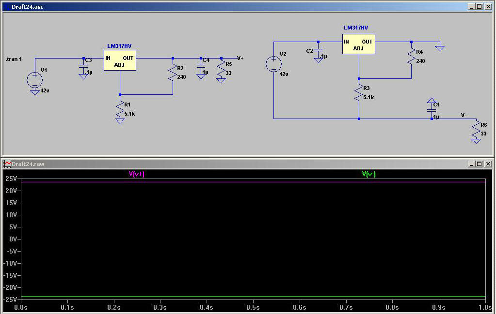

You could use the LM317HV which has the input/output differential voltage raised to 60V allowing you to regulate from 1.2V to 57V.

i actually considered the HV version but it looks not that widely available (newark has them) and also if the neg version would be the lm337hv, that's pretty much impossible to find :-\

With what you are doing you do not actually need the LM337HV.
The LM317HV are available at DigiKey see my link in previous post.

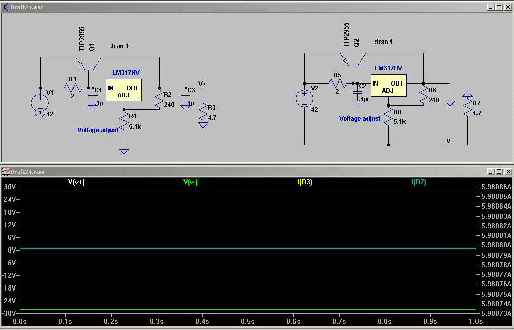

Assuming you're going to use a pass transistor since LM317's max current is only 1.5A -
Use some resistor divider to make a 36V supply for the LM317. If you can do zener regulated, even better. But not much current will be drawn from this supply. (You'll need to calculate the optimal resistor values.) Output of the LM317 will be regulated anyway.
Output of LM317 feeds the base of the NPN pass transistor (but this concept probably works for configuration with PNP transistor too). The pass transistor will eat 42V on the collector and Vout on the emitter, but now you can easily find a part that can handle that. LM317 will eat max 36V on the Vin pin. Find a transistor with sufficient current gain and select the right resistor values, and variation of Vin (at LM317) due to load current will be negligible.

RJM1, i forgot to mention, i want to do this at both sides, e.g. on the +V and on the -V (which would be a second supply hooked up in parallel to the first). Hence my need for the LM337HV if i went with an HV part on the +V side..

If you look at the attachment in my last post the right hand schematic shows how to use the LM317HV as a negative regulator.
RJM1, sorry didn't pay close enough attention to your post, that looks like it would work, but i am looking to do approx 6amp so i would need a series pass device to be able to handle that amount of current (and your post only had the HV lm317 doing all the heavy lifting).. guess what you posted could be adapted, but i'm rather proud of what i came up with as well 🙂
Here is the schematic with the pass transistors. R1 and R5 are 1/2W.
The LM317HV wil pass about 668mA.

Those two schematics (the pos/neg halves of your latest post) look eerily similar to each other.. why did they produce an LM 337 if you could just use an LM317 in almost the exact same way?
Can you help me understand the difference? Specifically my concern is, with the neg version, isn't it stepping down the common Ground (0v) of the neg half, lower toward the negative extreme? E.g. if you have a 0v @ gnd and -42v at the -Ve side, isn't it stepping down the 0v lower toward the -42v (instead of making the -42v go toward the 0, to -36v? I'm asking because this makes me think the gnd reference will be shifting between both supplies, and with my overall project, the Gnd on the +42v supply is going to be hooked up to the +42v of the second ground (to have that common point be the virtual ground).
I'm basically worried the neg version will make the Gnd really be, with an absolute reference, (as if it was an isolated 2nd supply), 0-42v becoming 0-36v (instead of what i think i need being 0-42v becoming "6-42v").
Sorry if i'm doing a crappy job explaining where i'm concerned, hopefully you get what i'm trying to ask 🙂

if you require a dual polarity supply and plan to use a centre tapped secondary, then you need a positive and a negative pair of regulators for the supply.
