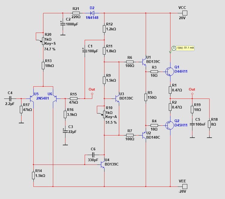

I myself is a fan of these type, I actually am playing with this one in sim I found the schematic from one of the threads here. It was mentioned that the original schematic was called Studio in Bulgaria. I made a version of my own using the standard EF, I've read that the Bryston type outputs (in the schematic posted) are known to be misbehaving.

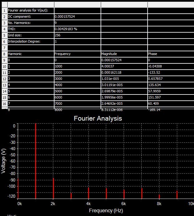

I worked a little on the circuit in post #40.(simulations)
DC offset at the output:
reduced by changing resistors R3, R4
clipping behavior:
terrible without D2, quite OK with 1N4007, good with BAT46.
gain margin 19dB
phase margin 71°
If C4(feedback) is increased to 270µF or more, the phase never becomes zero and you cannot read any value for gm.
pm is then displayed as 289°
Bias:
From 15-20 mA per output transistor the THD is acceptable.
Reactions: decramer and stv

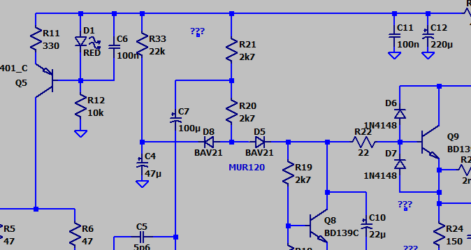

catd, you might like to put a resistor in the collector of T4.
Without it, T4 WILL die on overload and then kill T5, T7 & T9s in short order.
D2 prevents overdriving. But overLOAD will take out everything from T5 all the way to the output inductor. D2 or no D2, resistor in Q4 or no resistor in Q4. TIP35’s aren’t rugged enough to withstand even a momentary output short on +/-35V.
