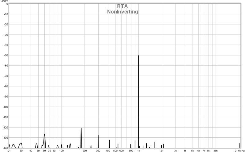

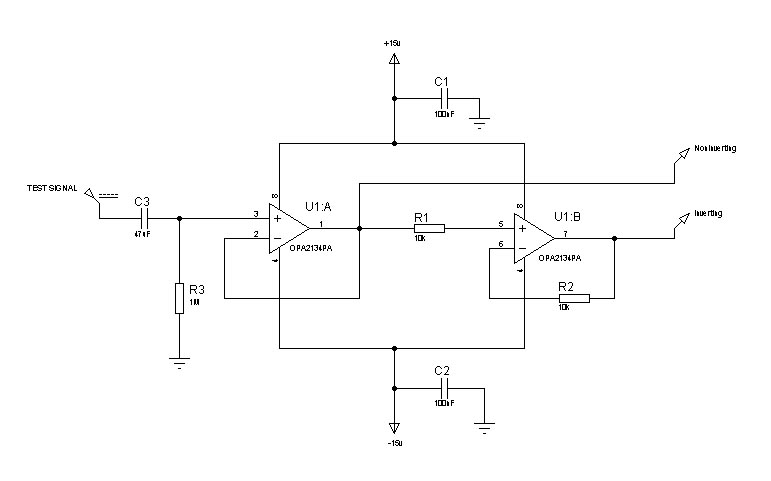

I am designing a circuit where I need to buffer some audio, outputting both an in phase as well as an inverted signal. The stage after this adds a lot of gain, so I need to get the noise floor as low as possible.
I used an opa2134 because it's a high quality audio opamp, with low noise and distortion figures.
Attached is the schematic as well as FFT grabs of the two outputs. Running a -50dbfs 1k test tone. For the initial buffer, I used a basic unity gain buffer. This output is great, the noise floor is about as good as a monster cable in this configuration.
The Inverting buffer is as basic as you could get, using the second opamp on the same chip. There is a 60hz hum+harmonics at least 25db louder than the nonInverting buffer. Can anyone explain why???
I tried changing the 10k resistors on the inverting stage to 1k, 500ohm and 100k. The behavior was about the same. A tiny bit of noise with the 100k's but still much quieter than the 60hz and it's harmonics.
I tried different dual opamp chips, and tried swapping the on-die opamps. I tried this on a PCB first, with ground planes, again without ground planes (star grounding), then on a breadboard. Same results. Lead length and circuit orientation don't seem to change anything. Tried more than 100nF decoupling caps, and the coupling caps are as close to the pins as possible.
Pretty weirded out by this. Thanks for your thoughts!
SEE NEXT POST FOR CORRECT SCHEMATIC. (unable to modify the one on this post for some reason.)

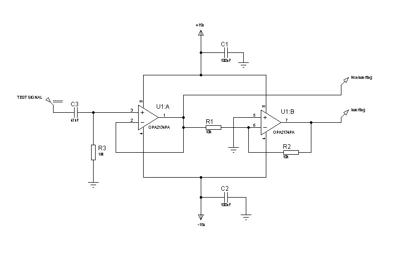

Here is the correct schematic, the one above is wrong. I re-drew it from a bigger design and made a second noninverting, when it is indeed a noninverting followed by an inverting.

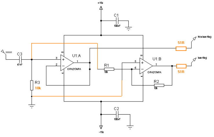

Hi, wierd ! It sounds like you're getting 60Hz injected through your common/ground track/s. Try rerouting as in my screenie. I also made a few other changes for the better 😉
Thanks ZeroD,
I think I'm making some progress on this.
The grounding I'm using is a star ground, so I'm pretty confident about the grounding scheme.
If I change that 1M to 10k, the RC filter changes and I'd lose all the bass, plus it would load the previous stage too heavily. I need a 1M input impedance or higher. Since there's no hum after the first stage I doubt that's the issue.
Running the two stages in parallel is also not possible, because there would be 20K impedance to the output of the second opamp, messing(essentially in parallel) with that 1M input impedance, so not possible without changing the other two resistors to a very high value, adding hiss to the circuit.
As far as the output resistors I'm actually doing that in the next stage, lol. Just didn't draw it, because it's not relevant to the noise.
On Another Note! I WAS able to get rid of the noise using 9v batteries instead of the power supply!!!

Apart from the other things, try moving the Inv + Input to where i showed & see if that makes a difference on it's own. The fact that batteries changes things, means that you DO have a common/ground loop issue. And/or getting 60Hz injected from the bypass caps, so move those common returns Directly to the star point on the pcb.

I have the label on that cap wrong, it's 47nF!! oops. Misunderstanding there.
I'm driving it with a passive instrument pickup, 1M is the standard input impedance of a guitar or bass. Piezo based instruments are actually better with 4.7M or 10M inputs (acoustic guitar or mandolin). Also there is a mode where it is driven by a vacuum tube stage (220k output impedance). Regardless, the spec for this design requires 1M input impedance.
The path through R1 and R2 would arrive at the very low output impedance node of the opamp U1:B (essentially ground). The input impedance of a noninverting stage is close (as is reasonable possible) to infinity. The input impedance of an inverting stage is essentially the two resistors added together.
The + of the inverting is tied to the same ground point as the 1M is. It's been star grounded the whole time, so all ground connections are at the same point. I can't imagine there being any loops in this case at all.

Ok, I got it figured out!
It WAS a ground loop. I powered off batteries (no hum), then connected the ground of my PSU to the circuit, and the hum came back. There was a loop between the power supply and the interface I was using to get an FFT of the test signal.
