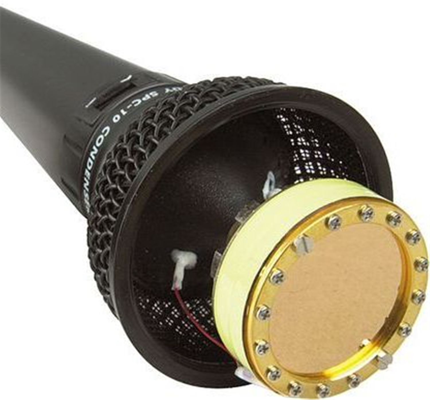

The attached image shows the mic capsule in the SPC-10. You can see it is a heavy-duty, well-made, machined solid metal housing carrying the usual Mylar diaphragm.
These NADY hand-held condenser mics seemed to hold a unique market niche as the only good-quality affordable condenser mics designed for live use. Those who were open-minded enough to try them as a vocal mic, usually found them superior to the world's most popular hand-held mic.
But I suspect not enough people were willing to trust their ears, and instead went for the safe choice, and the resulting low sales caused these to go out of production. It's sad to see yet another good product fail, while lower quality items continue to thrive. C'est la vie.
If anyone makes a condenser mic capsule suitable for live vocals, I may end up making my own DIY condenser mic one day. So far, I've only seen capsules designed for studio use (far too delicate and too sensitive for live sound applications.)
