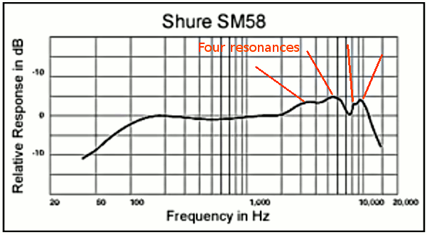

I have heard similar sentiments quite a few times before, and this widespread love for the SM58 truly leaves me scratching my head in puzzlement. This is one of those Twilight Zone experiences for me, because I have rarely heard a worse-sounding microphone, except in an intercom or a child's toy.
The factory frequency response looks to have been heavily smoothed to hide the worst of the microphone's sins, but even so, it shows multiple poorly controlled resonances (I can see at least four) between 3 kHz and 10 kHz. Peaks are up to 5 dB tall (!!). Above 10 kHz, the response falls like a rock. No wonder sibilants and "air" are destroyed by this mic.
In my experience, audio equipment with multiple closely spaced mechanical resonances in the midrange often sound "shrieky". The popular Bose linear array speakers and the SM58 both suffer from this "shrieky" sound quality.
The SM58 factory frequency response doesn't show the enormous bass boost that occurs due to the proximity effect - the microphone is so insensitive that singers are taught to "eat the mic". Directional microphones like the SM58 experience tremendous bass boost when closely spaced from the sound source, and this is why singers have that "singing from the bottom of a barrel" sound when they use an SM58; the sound guy/gal will routinely apply up to 15 dB of bass cut the moment he/she spots an SM58 on stage.

The SM58 frequency response simply confirms what my ears had been saying, except for the enormously boomy and boosted bass - that doesn't show in Shure's official frequency response. But plug in an SM58 into a mixer set flat, and connected to a reasonably accurate speaker, and there is no doubt about it. People who deal with live sound have become so used to dialling in an enormous 10 - 15 dB bass cut as soon as they see an SM58 on the far end of the cable that they no longer even question why they need to do so.
Keep in mind, even that horrid SM58 frequency response is the one published by the manufacturer, smoothed and prettied-up in an attempt to put lipstick on the pig. I expect an independent frequency response measurement by an unbiased third party would reveal even worse.

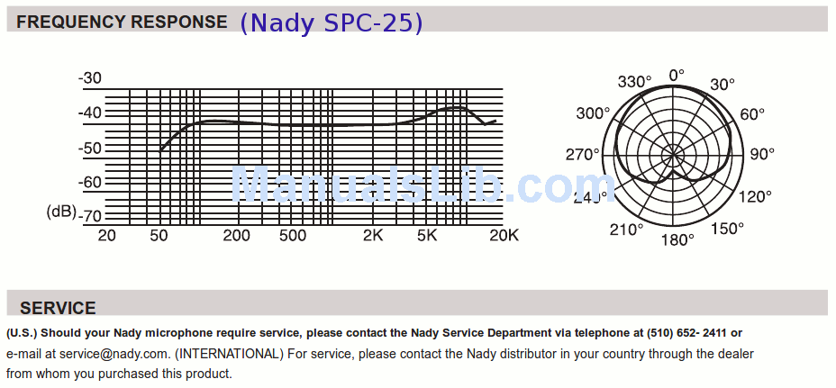

Since you asked, I will mention one very affordable live-sound condenser mic I am quite familiar with, which IMO sounds so much better than an SM58 that a side-by-side comparison with a few singers (and a decent-quality P.A., or better, studio monitor) is a real eye-opener. It's the Nady SPC-25 ( SPC-25 Professional Performance Microphone – Nady Systems, Inc. ).
Fair warning: the SM58 has a diaphragm apparently made of shoe-leather, which explains both it's durability, and its poor frequency response. The SPC-25 uses a wisp of very thin gold-sputtered Mylar film, and will not survive abuse, though it is quite rugged and durable if handled with reasonable care - I have one that's at least ten years old now, and which has been used for live singing approximately once a week for most of that time.
I'm attaching the frequency response Nady provides for the SPC-25. You can see for yourself that Nady has attempted to engineer in a similar "presence peak" to that found in the SM58, but it is a single smooth and well controlled resonance rather than a ragged cluster of at least four separate high-Q (poorly damped) resonances. The SPC-25's bass response is also much better controlled, and the treble response extends to higher frequencies than the SM58's does.
Just to be clear, I am not "touting" the SPC-25 either. Simply mentioning one example of an inexpensive mic intended for live sound that IMO produces much better-quality sound than an SM58.
-Gnobuddy

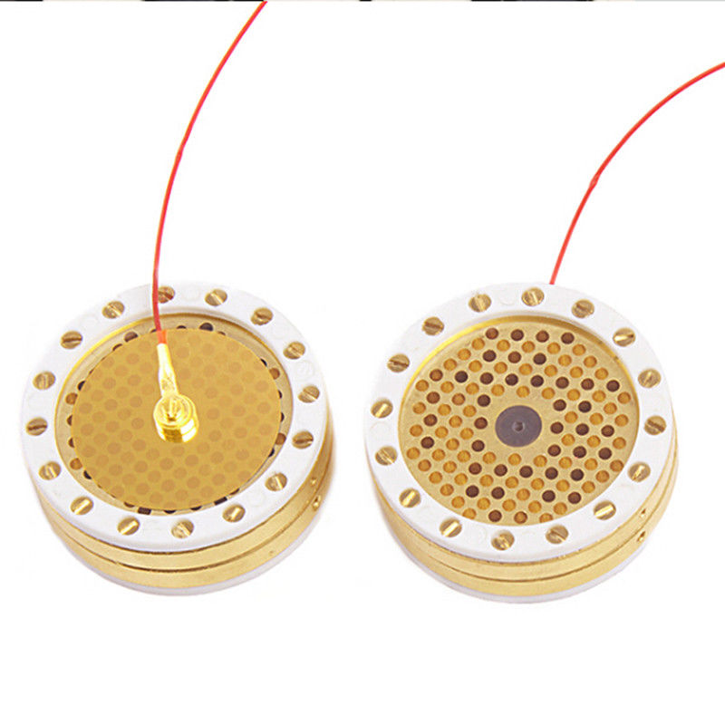

the resonance peak is made to help the poor articulation of many singers.itis created in a physical way,not electronically. a small column of air is created by forming a tubular structure,a rim on the capsule. that mass of air is adjusted to create a resonance.
a large membrane chinese condenser,as copied from neumann is a good candidate for DIY build, as well as WM61. I used the WM61 in sourcefollower mode,and it can handle 140dB acoustically that way,if you do the electronics right. I use it as for metering and response work as it is flat from 10hz to >10k dependingon the mechanical structures in front of the capsule,the peaking story..

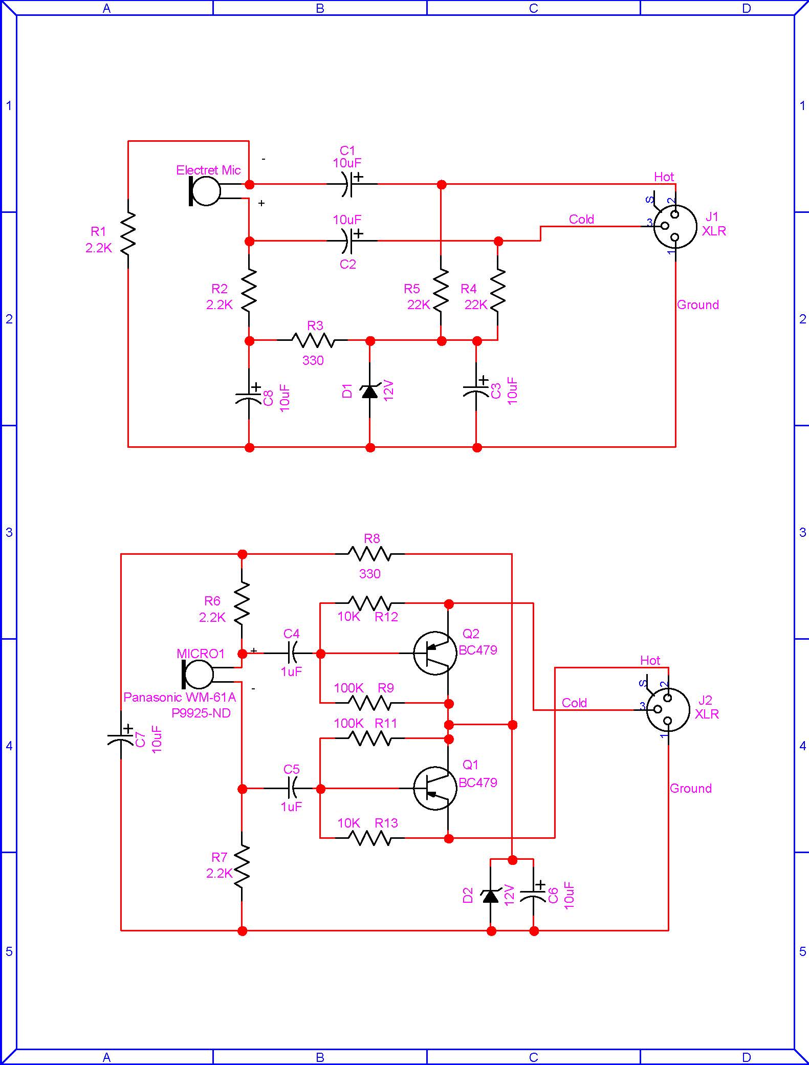

I've found some interesting information here:
Powering microphones
There are 2 circuit diagrams on the page and either one would seem to be just what I'm looking for.
I was thinking of getting a Chinese 34mm condenser module to have a play with and also a Panasonic WM-61A to see what happens.
Not sure if the pre-amp circuits mentioned could be used for any condenser though. Condenser modules seem to be cheap enough and being able to experiment with different types by connecting to the one pre-amp circuit would make life a lot easier.
The two pre-amp circuits you showed both require that an FET pre-pre-amp is already in the microphone capsule.
These circuits will work with capsules like the Panasonic WM-61a, which have the FET already built-in. But they will not work with bare electret capsules such as the two large-diaphragm ones you showed in your photos.
-Gnobuddy
the main source of distortion in the WM61 is the non-linear drain gatediode capacitance.
if you manage tokeep that voltage signal independent likeinthe B&K frontends, you're OK.
these are useful for your large membrane capsules. you need a low noise regulated dcdc stepup for the bias voltage, and a 10G resistor. you can control the HV as a way to control sensitivity or 10dB pad for large signal close range applications. (much better than adding a capacitor with a switch, that adds noise)
