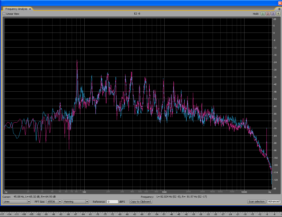

Everyone can try to listen on the drum attack after "Now you know that you are real...". It's clearly frightening on one of the file. You know how frightening a real drum attack is (I hear a real drum everyday this last week, friends are preparing a live performance for next 10 days)
The files Mooly had posted will make no hearing damage to anyone.

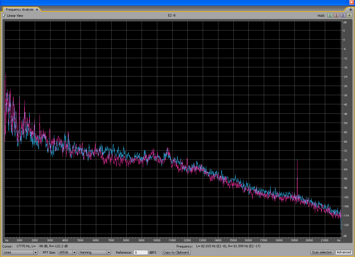

People can take a look and make up their own minds:
Your analysis is partial and flawed. The signal he posted will make no harm to anyone!!!
Such signal components are very often present in the music files people buy on CD or download from web shops. Just worse immunity to RFI. Very usual!!

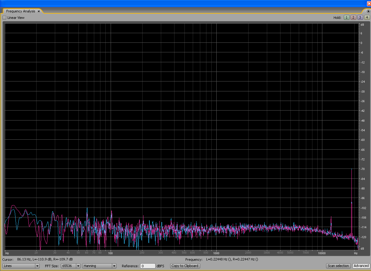

Not sure if this will work but here is a 30 second wav file of "silence" recorded on the Acer with the inputs shorted for anyone wishing to analyse it.
https://www.dropbox.com/s/xqqw9iwmpjy01uw/Silence.wav
That has to be an artefact of the Acer laptop used. The level of that spike is very low ? yes ?
The main audio of the file is at least -30dB so people will naturally raise the volume to compensate. After that, the spike might be higher volume than you would normally get at that frequency perhaps.
Maybe it's OK. But certainly worth being careful. I wouldn't do extended listening with these files.
Thanks Pavel.
Hi Mooly,
yes you have it there, quite usual in PC internal sound cards in the slots. Try to isolate connectors from frame or different slot position. It is a tough job sometimes.
Also, it looks like the card works in 16-bit mode. Drivers installed?
