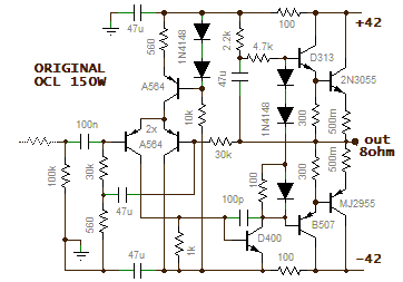

it looks like this has CCS for the LTP but the VAS has a bootstrap. Funny, the bootstrap cap is C4, same as AKSA !!

They similar but different, c4 is not the matter. But I think that both has same "secret". The secret is how it being favorite for home amp even if there are newer amplifiers with many new topologies, Also this amp makes Tubes has less choice here (in my country).
This AKSA 55 may did the same to being greater famous amp than ocl150w when everyone start to build it, and Hugh did very good to design it.
Anyone that need to built should find the crucial spots, to reach the best. The OCL shows some spots, but it still has common high freq sounding, and I think AKSA 55 is better at this.

OCL150W is not AKSA55 copy and AKSA55 is not OCL150W copy. There are many amplifier similar with this and using same technique, you may get more complex at sony TA1055 (even comercial did good start with it).

Looks like this thread is going valuable with secret imaging and "what happen with ClassD?". Thanks Hugh. I promise its the last secret I post here from OCL and not detail, it is feedback balancing (we says :nyeimbangno pantulan). Only clues 😛erfect balancing with 2 speaker in single box and common balancing with transformer elco and resistor. I see that someone rising baby here.

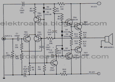

Also I see that the winner OCL150 schematic is modified by unexperienced MODer. Replacing R3 30K balancing resistor with 33K needs speaker or transformer balancing test to readjust the CCS current and then change R5 for lowest offset. I still have pair of them original, Here is the original schematic. Hehe... the WON!!

CCS help to deal with 5% resistor value and voltage range, because this amp is designed for mass production and fast built. For example, with CCS, R3 perfect value is 28.5Kohm and start gaining with 26Kohm, they are far, and 30Kohm will not reach 26Kohm.it looks like this has CCS for the LTP but the VAS has a bootstrap.
