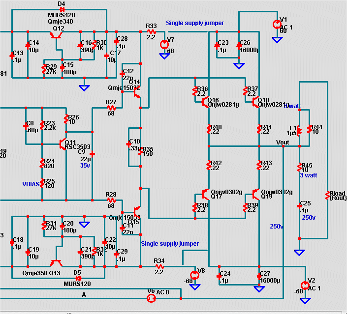

Al's schematic (#531) is using 2SC 2500s in the OPS. So is Sound Buster.(#532)

My schematic in #532 comes from Al's. Just MS Paint...

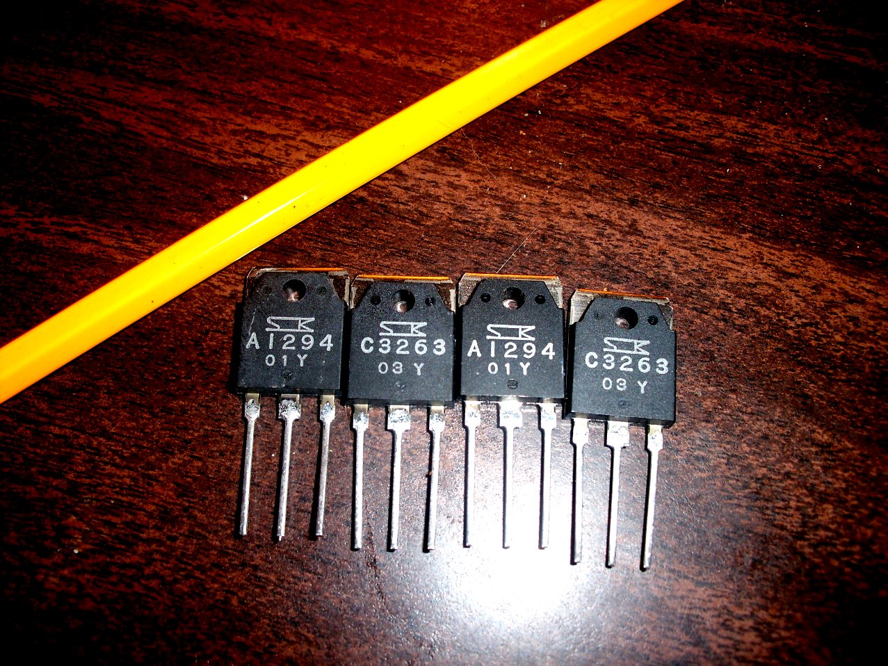

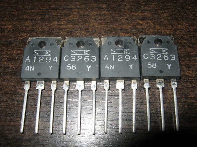

I am using a new pair (Sanken 2sc3263/2sa1294- below 1) , I could say they "sound better" but I know better .... they are just better matched and are especially made for audio.
These fine pieces of sand are nearly identical to 2sc5200's with a slightly higher SOA @60V.

Which wan,s are the Fake,s?

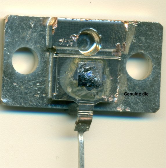

I know mine are NOT , pushed a single pair to 80W for hours. Besides breaking them open you would have to do this. If you DO break one open , a genuine one will have 6-7mm die , a fake will have a 3-4mm die. 🙁
One one right is fake. (actually both are fake)

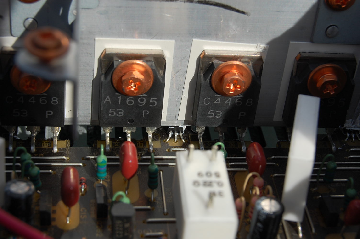

I bought a broken Yamaha AV amp from eBay for $20 last week. The amp does not power on, I suspected that the standby power transformer is broken, however the main Transformer is tested OK, so is the main filter capacitor.
The spec of this amp (HTR-5840) says it is rated at 6x 85W RMS.
Inside the Yamaha is 6 pairs (12 pieces) of these Sanken babies. I reckoned it is a good buy for 20 bucks and it will be my next project - retrofit this amp with some decent diy boards.
Your A1294/C3263 are better than the Sanken in my Yamaha, it is LAPT (Multi emitter for High Frequency) and higher power & Ic. The fonts on your Sanken is similar to mine, so it is a good indicator.

check polarity c10 & c12 , is opposite ?.
so check the gnda on c10, why connected with rail plus ?
Operator error. 😉
why Q7, Q9, Q10 use 2SC2500, the complement A1943 is 2SC5200.
Ditto. 😉
#9 Replace R3 with 43K resistor and 10K trimpot in series, to enable offset adjustment.
R3 should be 56K, in order to generate 1mA stage current from 62V rails. The pot trims the offset, so this series pair must be right.

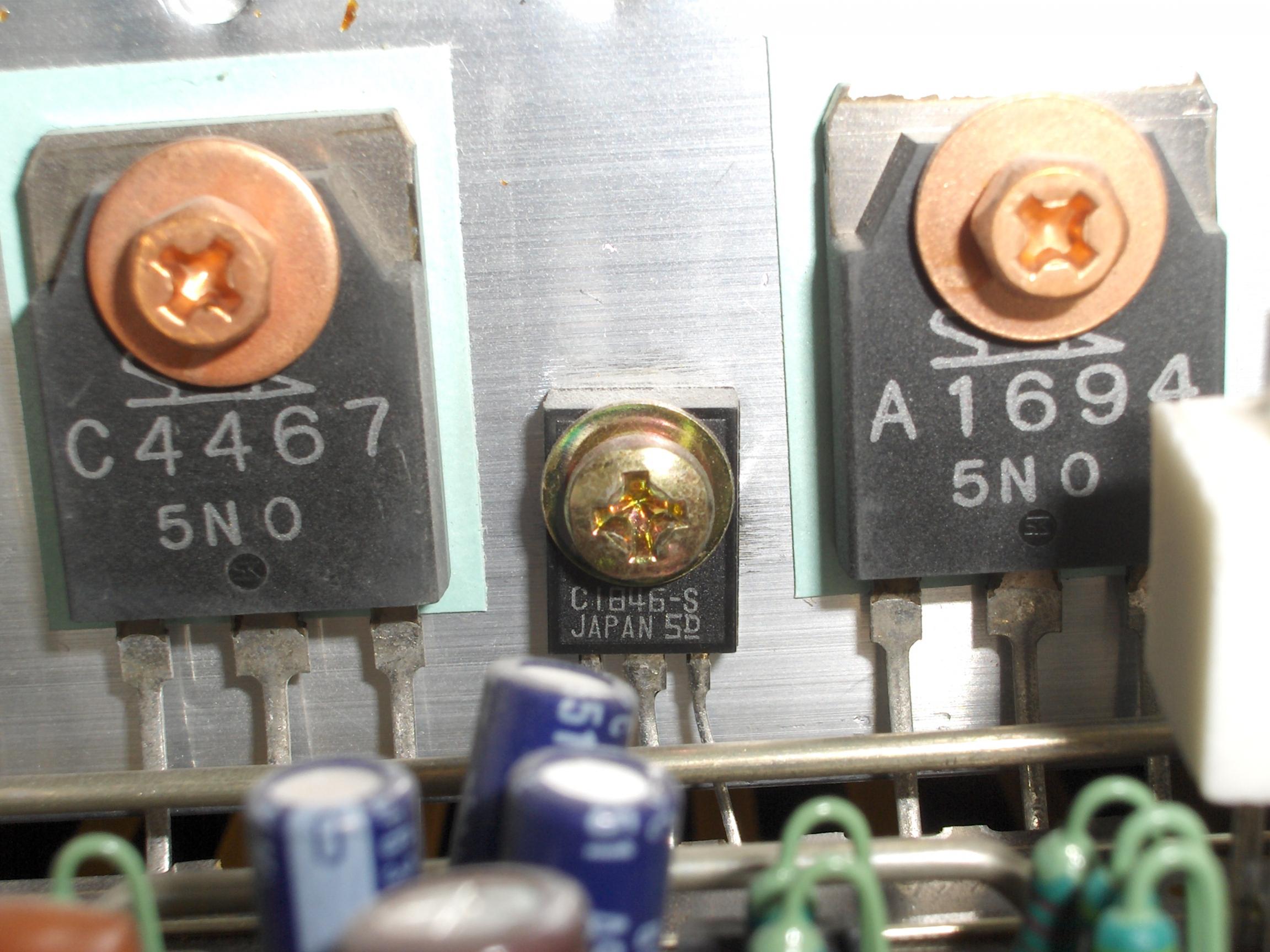

Yamaha RX-V2090

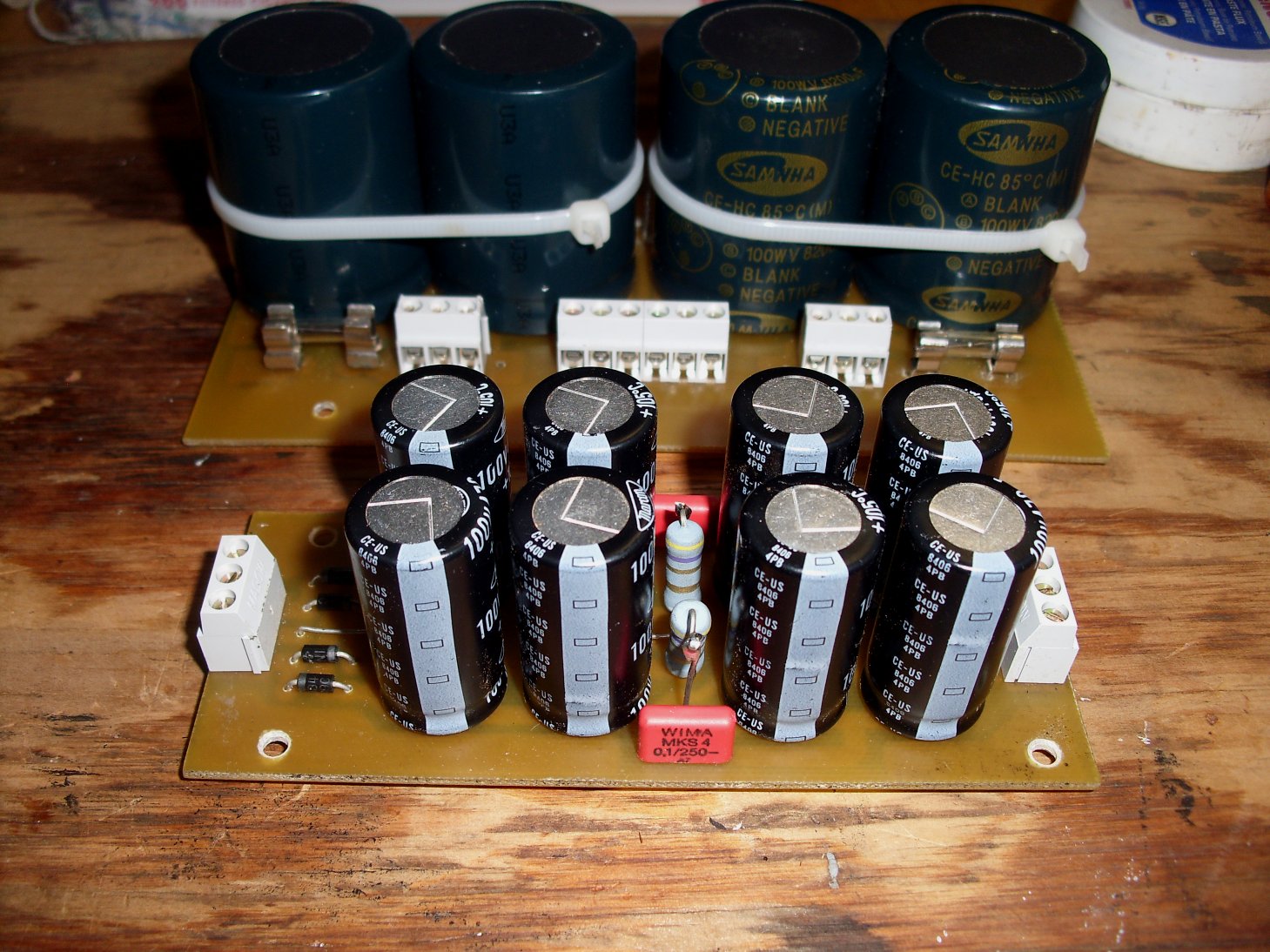

Nico RAS uses his own version of "ripple eaters" in his amps. You don't need anything that serious for this amp. I use a C-R-C for my drivers , the cap mult's for my IPS/VAS (all fed from a separate 68-0-68V supply). Even with 2v or more ripple on the "dirty" OPS supply ,(which NFB takes care of nicely) , I can get close to the 3'rd (-120+ db PSRR) plot I posted before.
Output stages can take "dirty" rails , input stages like clean ripple- free environments. The power supply is just as important as the design of the amp.
Below 1 is the simple multiplier schematic - pix 2 is the CRC (68-0-68v)... The "dirty" 60v OPS supply is behind it. 😀
All works nice with a 55 or my BX (similar bootstrap amp)
OS
