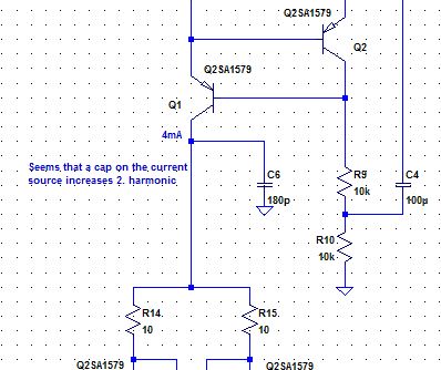

by all means .. .. especially if it could show the effect of back emf with VAS bootstrap vs. current source.
I have played some more with LTSpice, and I only finde minute differences (5. decimal in distortion!!) between CS and bootstrap!
Have though found another way of introducing primarily 2. ord harmonics:
Place a small cap at the current source output to GND for the LTP.
Hmm, you are introducing asymmetrical charge/discharge, which promotes H2, BUT, you are also using 1st order shunt compensation, which pulls back OLG at high frequency. This means you can ease off on the conventional CB lag compensation, which improves sonics somewhat.
Why not try it....
Hugh
Why not try it....
Hugh
The cap will increase H2 at high frequencies but not at lower ones. To have the same effect across the spectrum you could replace the CCS with a resistor, or replace the cap with a resistor. I agree with Hugh.
