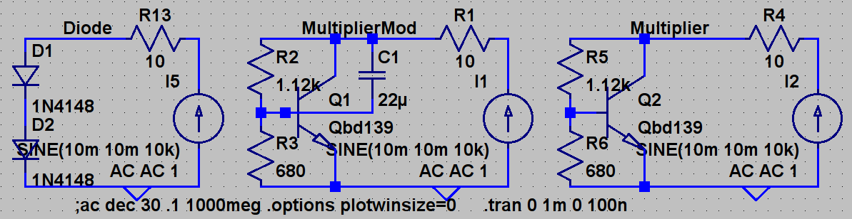

Also, in the last schematic posted, there is no capacitor bypass for the Vbe multiplier. Hmm.

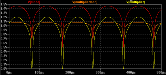

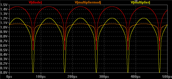

I remember in the days of HAKSA, the question was brought up about which was better, passive diode bias or Vbe multiplier. I brought up simulations and showed that the Vbe multiplier behaves weird owing to the type of transistor most often used (low Hfe 20W types) (AKSA responded with interest, which leads me to believe he hadn't tried it before). The surprising thing is that the multiplier's impedance was actually WORSE than the diode string's. A 22uF cap B-C really helps with this. Now impedance is markedly improved (by 16db), justifying its use over the trivial diode string. Plots attached.
Trivial, oh so trivial, but what the hell. Well the numbers are interesting to ponder. Upwards of 1KHz it doesn't matter when a 22uF bypass is used, but again for the 100Hz-1KHz region impedance is 16db less (owing to the higher impedance and longer RC constant seen by the B-C cap). The bass end can be extended easily by increasing the B-C cap (20Hz for 100u), an improvement which otherwise would require a much larger bypass cap (2500uF!). The appeal to me is that instead of walking with frequency, the impedance drops to some point early on and stays there for all of the audio band; very nonreactive. It would be nice for someone to test this sonically (trying not to lodge foot in mouth).
- keantoken

hi keantoken,
Very interesting and simple to try. I now have 5 B-AKSAs built, 4 identical so I will note this one down as a experiment. The cap across B-C rather than the traditional C-E will be easier on this PCB.
