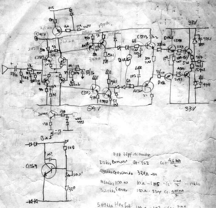

Back to solving this oscillation conundrum...
The first thing I tried was lowering the resistance of R24 & R27 to 1 k and R26 & R25 to 10 k. This didn't make any difference. 🙁
Well, I was right. With R25 disconnected from the output and grounded instead (to ensure equal resistance to ground for both inverting and non-inverting inputs) and a 1000 uF cap across R27, the amplifier saturated to +46 V. So I cannot measure open-loop response directly.
After the failed attempt to measure open-loop response, I left R25 grounded and disconnected from the output, and connected it to the junction of D4 and D5 instead. Oscillations were not present in this configuration.
So, do you guys think this is loop stability problem? Time to play capacitor roulette?

Hey Harry,
Ok, so you've proven that the oscillation is not a parasitic in the output. That means the outputs don't have enough phase shift or feedback to to make themselves oscillate. The outputs STILL could be contributing phase shift to the total loop though...
Check out post 4 in this thread... a good way to see if the input stage is the major culprit. If it is stable, then you could suspect that output section phase shift is adding to phase shift in the loop. If it is unstable... then you cut your problem in half.
Also... somewhere along EVA posted a method to prevent DC saturation when doing a loop test... kick that one around.

Hi poobah, thanks for the reply.
Yep, already tried that. It's the output stage poles that are the problem.
However, there are a few things that I don't quite understand if this really is a loop stability issue.
1) How come the oscillation is limited to around 5 volts pk-pk? Have I hit on almost exactly 0 dB gain margin?
2) I simulated the circuit and the simulation indicated that gain and phase margin were more than adequate.
3) Using almost exactly the same circuit, but with Sziklai output stage instead of EF, there is no loop stability problem.
Anyway, I'll try increasing the compensation capacitors and see what happens...

One thing that doesn't factor into traditional loop analysis is slew rate limiting. This is one thing that puts a cap on your absolute magnitude when oscillating.
So the step 4 thing made it stable? Proving that the output stage, while NOT parasitic, is at least a significant contributor to phase shift in the loop?
Sounds like roulette is the way to go here... remove the feedback cap entirely... then play with the feedback divider until she's just barely stable, keep track of the frequency of osc, and the feedback gain (attentuation) through this process... then you can make some assumptions about the loop gain at that point. If you can't find find the open loop function... you can at least find the closed loop 180 deg, 0 dB point. From there you can make some informed guesses as to how to compensate the beast.
You won't be able to "back out" the entire transfer function; but you will be able to nail it down around the feedback point; which is all you care about anyway...

poobah said:One thing that doesn't factor into traditional loop analysis is slew rate limiting. This is one thing that puts a cap on your absolute magnitude when oscillating.
Very good point, hadn't thought of that.
poobah said:So the step 4 thing made it stable? Proving that the output stage, while NOT parasitic, is at least a significant contributor to phase shift in the loop?
Yes.
poobah said:Sounds like roulette is the way to go here... remove the feedback cap entirely... then play with the feedback divider until she's just barely stable, keep track of the frequency of osc, and the feedback gain (attentuation) through this process... then you can make some assumptions about the loop gain at that point. If you can't find find the open loop function... you can at least find the closed loop 180 deg, 0 dB point. From there you can make some informed guesses as to how to compensate the beast.
Once again, thank you for your advice. I'll try this tomorrow.

Hi Harry
Try a electrolytic capacitor from the junction of the bases of Q3, Q1 , to the positive rail.
Without the decoupling capacitor , the two CCS formed by Q1 and Q3 can "talk" with each other... 😉

Diodes as base stoppers?
In the VAS output, this design incorporates 2x1N4148 in forward, series, before the bias scheme. This 2x1N4148 is placed before the 68ohm/1W base stoppers, before the VBE multiplier bias scheme.
What is the purpose of 2x1N4148 at VAS output here? Is it works the same as base stoppers? Why the designer uses diodes (that is 1 way path current flow) instead of R?

The purpose of all those diodes (two in series with the base and one to the supply rail) is to clamp the base drive voltage just one diode drop below the supply rails of the ouput stage, thus preventing all three output transistors from saturating and dramatically improving clipping behaviour.
These diodes have nothing to do with frequency stabilisation and may actually reduce phase margin a bit, particularly near clipping (1N4148 are advised).

Hi, EVA,
I think you are right. It's purpose is like what you said.
But the front end is+/-41V and output rail is +/-33V?
