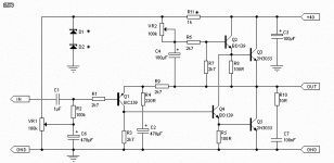

Hi HarryDymond !
You try to disconnect your pre-amp and test your power amp . You try to connect zobel circuit to right of choke .
You try to increase C6 and C7
I have no problem with normal darlington . With triple darlington , my amp is also unstable . I also use stopper resistor for output tst . It is helpful for stable but it increase distortion .I only use 1 ohm stopper resistor .
I dont use R15 , only use C3 .
a big C3 can decrease ocsilation but increase TIM with complex load

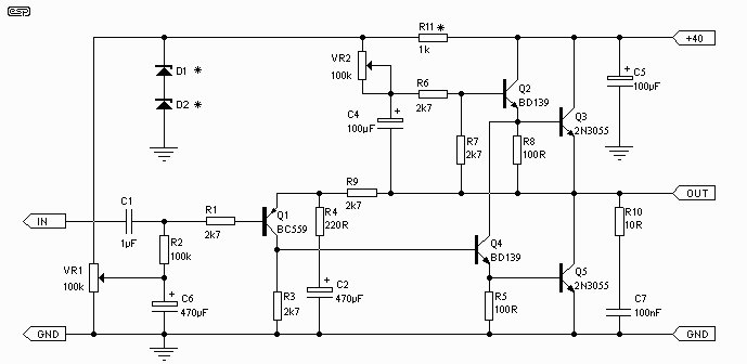

Originally published by Rod Elliott
Some interesting things came to light during testing, especially when I included the resistor (R6) from base to earth on Q2. With no resistor, I measured a distortion of 0.15%, and this was almost completely 2nd harmonic. There was a very noticeable degradation of the positive going slope on a 10kHz square wave, and a fairly low slew rate resulted. Adding the resistor improved this dramatically, and reduced the distortion to 0.05% - but it was now almost completely 3rd harmonic.
This will create a conundrum for some - would you rather have very low levels of 3rd harmonic distortion, or considerably larger amounts of 2nd harmonics (bearing in mind that the 3rd harmonics are still there). I cannot see any good reason to tolerate any more distortion than is absolutely necessary, so considering the much better slew rate (and therefore high frequency performance), I will be including this in the final design. You might want to leave it out if you want the 2nd harmonics, but I don't think the end result will be very satisfactory.
This is due to the transistor's turn-on and turn-off characteristics becoming more symmetrical by providing a base discharge path, but I did not expect such a large difference. The frequency response extends to over 100kHz at full power (6V RMS for these tests), and square wave response shows that the amp is both fast and stable - and this with a very ordinary switching darlington. I saw no evidence of measurable distortion above the 3rd - there must be some, but I have no way of measuring it. The 3rd harmonic appears to be an almost perfect sine wave, with some very small variations.
Death of Zen (DoZ) - A New Class-A Power Amp
Hi, Poobah,
I know that this sounds stupid, but I try to imagine what a "negative base impedance" is. I imagine that up to a certain high frequency limit, the transistor base is asking to have it's internal charge is discharged (in that frequency, from the outside, the NPN base seems to be giving current instead of sucking current), instead of able to receive another input charge. This is because the natural discharge of base internal charge is too slow (like EVA said). From outside world, this would appears as a pole, where the transistors seems to have a decreasing gain with frequency.
Hi, Lineup,
Thanks for mentioning the DOZ article. In the final DOZ, RodE is having R7 (2k7) infront of Q2. JLH classA don't use it.
It's hard to say for amps like DOZ or JLH. Their interinsic schematic is simple, having current feedback (feedback to emitors) as control system. They already very fast and stable. Their harmonic distortion is made intentionally.
If you read at the JLH article, he mentioned about picking different transistor for upper and lower output NPN. The bigger gain should be in the lower position. JLH seems to intentionally keeps the output stage not balanced, between upper and lower half.
Putting R7 in DOZ is making it more balanced, quite contrary to the JLH intention.
