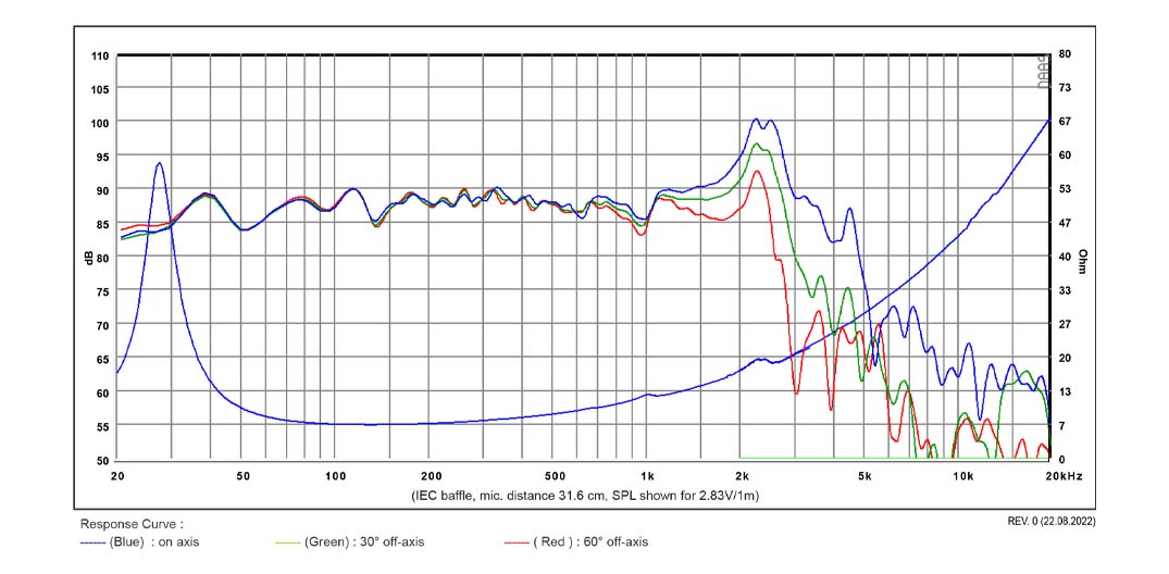

The SBA sb26sfcl38-8 seems quite interisting for the price; it is not suited for a BR though.

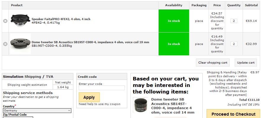

Had a Faital Pro 4FE42 as midrange in mind:
https://faitalpro.com/en/products/LF_Loudspeakers/product_details/index.php?id=401005105
Manufacturer data indicates that it might be a beast, found no alternative that catched me more. Have a Kartesian Mid120_vHE here running that plays faboulous to my taste, and the 4FE42 seems to be the budget brother of it.
As tweeter the SB Acoustics SB19ST:
https://sbacoustics.com/product/sb19st-c000-4/
Really flawless, and 1,75 Tesla in the gap!
All quite affordable here:

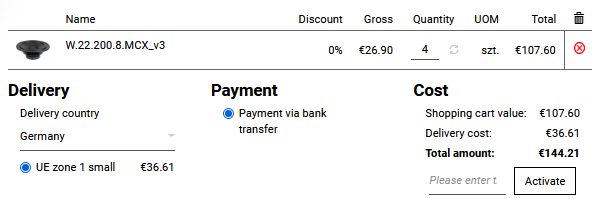

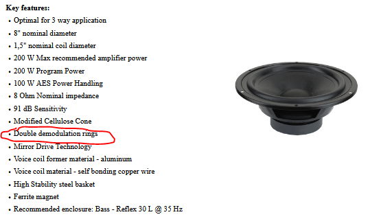

And as woofer the STX W.22.200.8.MCX_v3, eventually two of each per speaker in CB:
https://stx.pl/en/w-22-200-8-mcx-v2.html
Surprisingly well measurements: https://audiohorn.net/test/woofer/8inch/
Shipping costs are a bit high, ordering 4 instead of two makes sense for me (shipping is same):
For ~250.- € per pair of speakers for the drivers, this might give a serious floorstander hard to beat regarding performance, only looks. Xover @ >300Hz & >3kHz or similar. Costs might become very sensitive how easy the drivers are to tame, and how much xover parts you need if you want not take crap components.

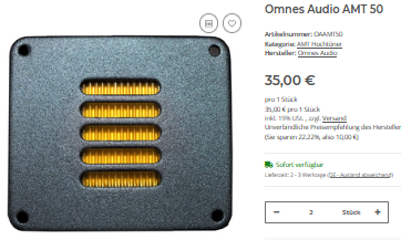

Alternatively, I had the Onmes AMT50 budget AMT on my list (very nice performance shown in HobbyHifi magazine measurements, if used >> 3kHz):
https://omnesaudio.de/Lautsprecher-...Air-Motion-Transformer/Omnes-Audio-AMT-50html

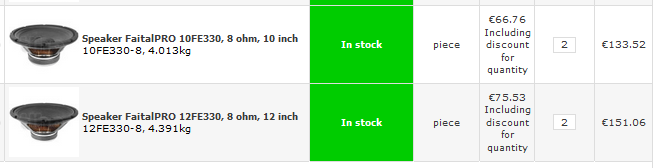

Faital 10FE330 or 12FE330 as woofer might be another option for a fat bookshelf shaped speaker:
