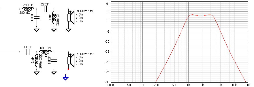

The order of components makes a difference. Maybe a sim could point things in the right direction (this sim doesn't figure in the specific impedance, response or overall purpose, and guesses at inductor resistance). Which circuit variation do you have?
Also note that the filter responses go above 0dB, connected with the interaction.

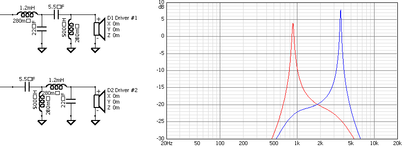

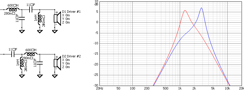

On second thoughts it occured to me what you were trying to do - invert the effect by overlapping (reversing the positions of) the high and low pass filters.
This is not what will happen. Their interaction represents a resonance with a bandpass effect on the speaker due to the topology of the circuit. Changing the values affects the resonance.
If you look closely you can still see there is an upper and lower knee.. they are just in disarray (at least in this presumptuous sim)
In this sim I overlapped them by halving the low pass frequency and doubling the highpass frequency. Also note that other Q values could be arranged around the same frequencies.
Notice that the primary band is still centred around 2kHz.
