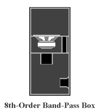

8th order banpass
BP boxes have a sealed box rate rolloff rate on the low end and a well-designed bandpass therefore has the transient response advantages of a sealed box. The upper rolloff obscures analysis and to really compare apples to apples you need to calculate step or impulse response of a sealed box with a HF rolloff at the same frequency as the bandpass box.
Playing around a number of years ago, I concluded that you frequently can get the F3 of a vented box and the rolloff of a sealed box in the same size box (4th order BP) as a typical vented box for that woofer.
One disadvantage not often stated for 4th order BP) is that max excursion occurs near the lower F3 and this is where minimum excursion happens for a vented box, so theoretically the vented box should have better output here.
Below F3, the 4th order bandpass has some protection from overexcursion due to the stiffening effects of the rear enclosure,.
6th order BP boxes have minimum excursion near the lower F3, but no protection below this point - similar to the vented box.
