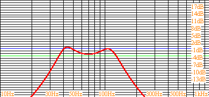

Response can be flat. Here is a response chart for the Rockford Fosgate RFP 3408 for two configurations of 4th order bandpass.
Red is: Front chamber, .2 cubic ft, vented to 61 Hz. Rear chamber, .4 cubic ft, sealed.
Green is: Front chamber, .28 cubic ft, vented to 61 Hz. Rear chamber is .4 cubic ft, sealed.
As you can see, both give flat response. The more sensitive box has a bandwidth that is one octave between 3 dB down points, the less sensitive box has a bandwidth of 1.5 octaves.
Try this yourself on WinISD. So the response can be flat, but yes, the box can be more sensitive with a bandpass over a vented or closed box system.

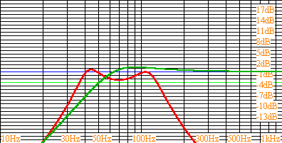

Quote Chris8 on bandpass boxes: "No superiority as compared to sealed OR ported designs, excpet when a significant amount of gain is designed in, to raise efficiency significantly. However, this narrows the already limited bandwidth and creates steeper cutoff rates, which in turn causes poor transient response, and peaking. Read: One-Noted bass! "
Beg to differ. First, a ported design is more efficient than a sealed one, so if you are of equal efficiency to a ported design, then you are ahead of the sealed.
The bandpass box consists of a sealed chamber feeding a ported chamber. If the sealed part of the bandpass has a Q of 1 or above, it will give superior bandwidth, at equal sensitivity, to a ported box.
The 3 dB down point of a ported box is given by the following equation:
F3 = [The square root of (Vas/Vb)] times Fs.
So in a ported speaker, when placed into a box equal to it's Vas, will be 3 dB down at Fs.

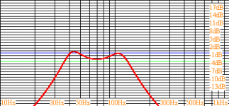

Here is an Audax woofer placed in a bandpass enclosure that is equal to it's Vas, but it's F3 is half an octave BELOW Fs.
Don't let those two humps fool you. This woofer is plus or minus 1.5 dB between cutoff points-a smooth response.
The woofer is the Audax AP210MO.

When the sealed box portion of a bandpass has a Qtc of 1 or above, it seems to outperform the ported box in terms of cutoff frequency. When the Qtc is lower, it does not.
