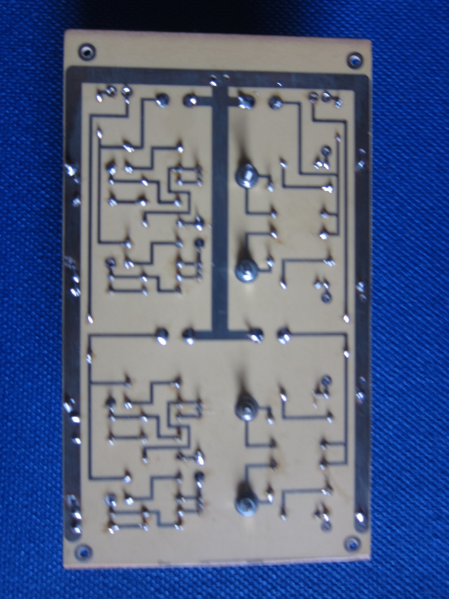

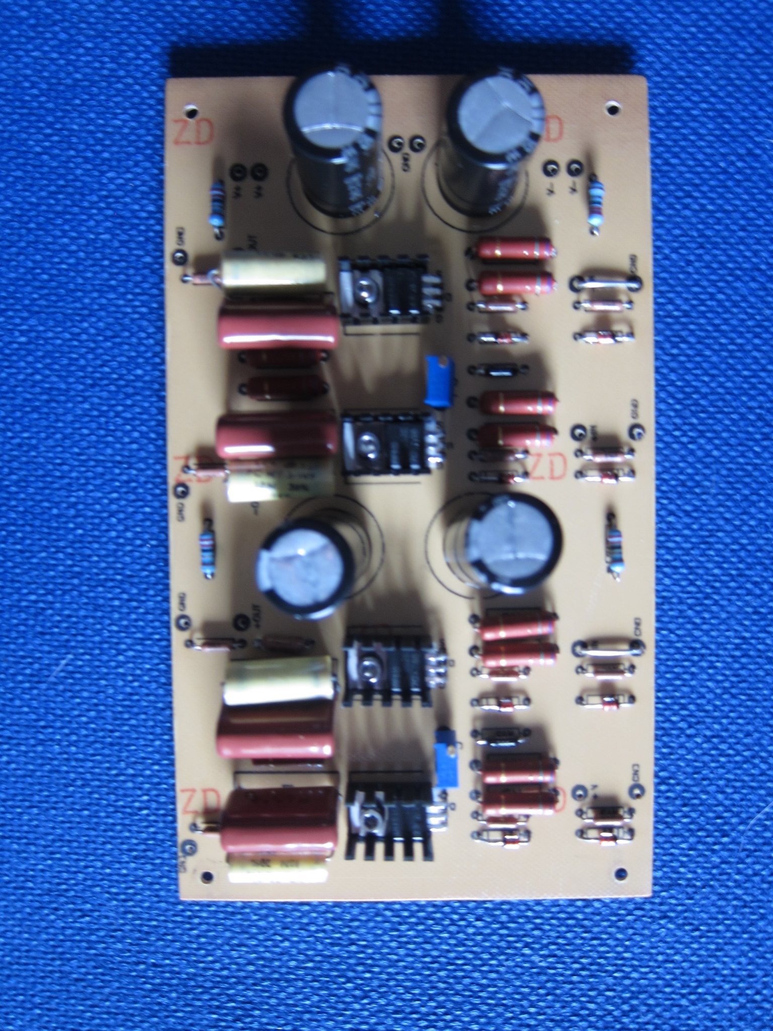

Help. Just built this preamp and have a problem, When I power the PCB from a -59 and +59 power supply. When I switch on one of the 22.1 ohm resistors R16 or R17 overheats. I have tried all components and they are correct, I have changed both mosfets and it still overheats. The circuit is obviously drawing too much power, but where from? I am using pcb from the original passdiy article. Any assistance will be greatly appreciated
Overheat as in R16 / R17 smoking or did they feel hot to the touch? Were you able to measure the voltage drops across them?
only one of them at a time overheats to a point of near flame. You don't have time to do any testing
With the power off, check the resistance of the MOSFET source pin to ground. Then take pictures of the pcb, both sides if you can, and post them.
