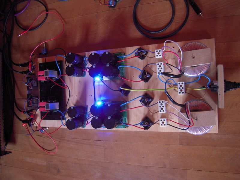

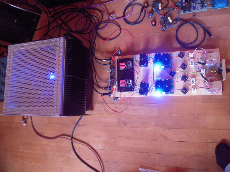

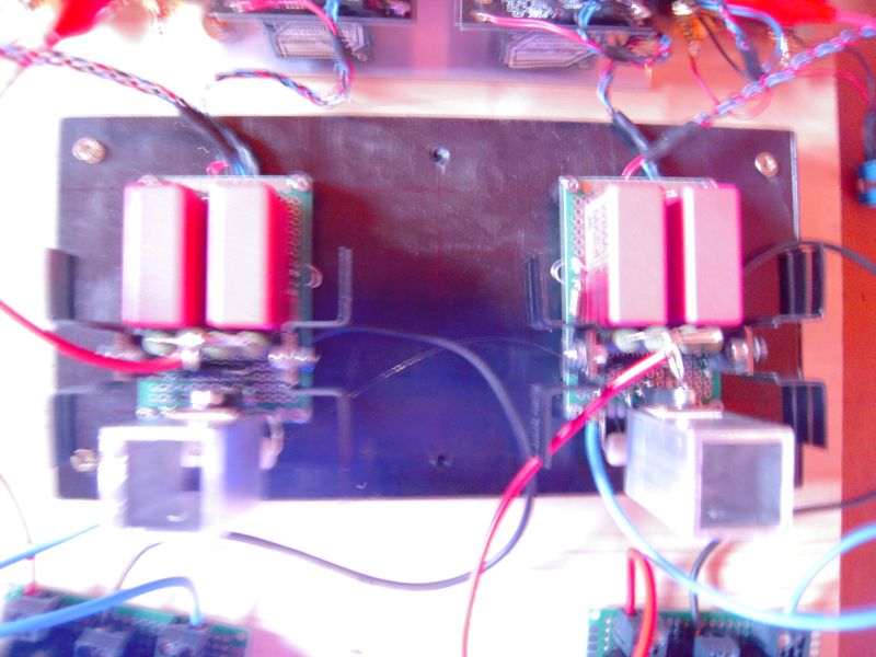

When I was reading this I put out my BZLS with added CCS and was hanging
it onto my M2X today (sure running se). Very nice! Old but gold! ;)
I am listening now for more than 2 hours. And it sounds really good.
But that 'baby' should get a nice warm house - ah, I meant a metal case.
It looks so lost on the piece of wood for the last 2 years. :D
And it has high railvoltage!
Greets
Dirk
