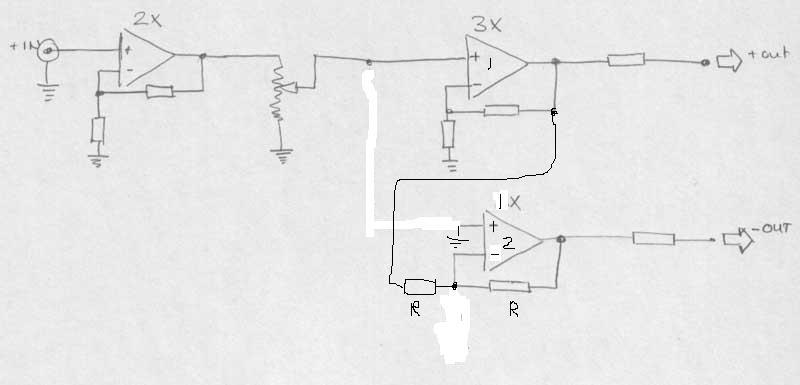

I´m planning to modify my preamp so it can produce a balanced output signal.
Since it is opamp based I think this can be done quite simple by using a second (inverting) output opamp.
Is it possible to feed two opamps with the same input signal without using resistors to separate the inputs? If not wich value would be appropriate? The opamps are OPA627, the first (input) has a gain of 2, the second (output) a gain of 3. The volume control is between the two opamps.
(see drawing if I can upload it)😕

wuffwaff
Your second (inverting) op-amp will not work with the arrangement you have shown (the feedback connections are wrong).
I suggest that you take a feed from the output of your x3 op-amp and connect it to the inverting input of the additional op-amp via a 100kohm resistor. Connect a 100kohm resistor from the output of this op-amp to the inverting input and another 100kohm from the non-inverting input to ground. This will cause the additional op-amp to work as a unity gain inverting buffer and will give you your balanced output.
email me if this is not clear and you need a schematic.
Geoff
Hello wuffwaff,
this circuit will not work, because the second opamp will oscillate. The feedback has to go to the inverting input, and one resistor from there to the volume control instead of the ground (standard inverting circuit); the noninverting input shall be grounded. The gain would not be A=1+R1/R2 but A=R1/R2 where R2 is the resistor to ground resp. to the volume control, so the resistor values of the feedback will be different despite of the same gain.
I´ll try to post a pic, not sure if it will work...
Ciao
AndyM

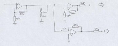

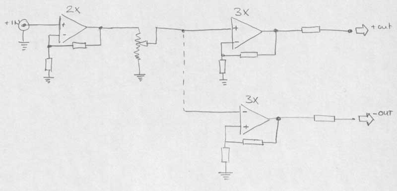

Thank you all,
this is what happens when drawing without thinking....
Here´s a new one. I would really like to have only two opamps in the signal path so I would like an inverting amp with a gain of -3.
I´ve added the actual resistor values of the existing circuit. The volume control is an elma stepped attenuator of 20k.
william
Now your volume pot has a 20K ohm load, so the attenuation per rotation curve is not what you'd expect. Stick a buffer after the pot (a dual JFET source follower with current sink would be nice) OR choose your switched attenuator resistor values with the 20K ohm factored in to give you the desired attenuation. The JFET buffer would drive both opamp inputs.
Now, you know the frequency response, distortion, noise gain, transient response, etc for both gain paths is NOT the same, don't you? 🙂 Have fun adding compensating caps, trimming, etc. for best match or buy a converter from AD or Burr Brown.
Good Luck!
Michael
