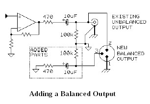

I'd like to convert my 3-way active XO to balanced inputs and outputs. It seems like the best solution would be to add the Jensen transformers, but, that would cost over $600 for the XO alone, not to mention the power amps the XO is connected to.... I'd like to avoid that.
Outputs:
Using the circuit Peter just posted would create two paths with the same phase and equal impedance, right?
D. Self seems to recommend Fig. 5B for home hi-fi. As I understand it, Fig. 5B from Doug Self's article would require 2 opamps and 4 resistors be placed in the signal path, just before the RCA jack. Impedance is set by Rs. I believe this produces an inverted signal to be compared with the in-phase signal at the input on the amp, which seems to be a very different solution. How do these two methods compare?
Inputs:
If I use Figure 9 from D. Self as the input, will it cause any problems when connected to the balanced outs from an Aleph P 1.7 or Borbely balanced line stage?
Finally, are there any special recommendations for a differential op-amp to be used in these circuits? What values for R and Rs in D. Self's Fig. 5B?
Sorry for all the questions.... I'm new to this and don't want to kill myself or my gear.
Thanks.

What, you mean this?
<center>
<img src="http://www.q-audio.com/images/xlrphono2.jpg">
</center>
This doesn't do anything with regard to common-mode noise rejection because the source impedances are left unbalanced. The whole point of using balanced interfaces is to reject common-mode noise. The cable adaptor solution can help reduce noise caused by interchassis currents (i.e. ground loops) but you're right back to square one with regard to common-mode noise rejection.

Again, the cable adaptor in Fig. 15 does not balance the output impedances and does not provide any real benefit in terms of common-mode noise rejection.

Steve,
I'd like to reduce common-mode noise rejection and capacitive crosstalk. According to D. Self's site re the cable in Fig. 15 "The rejection of capacitive crosstalk therefore depends on the unbalanced output impedance, and will be no better than for an unbalanced input, as at 1); the main benefit of this connection is ground noise rejection, which solves the most common system problem."
I said I'd like to replace the phono connectors with XLR jacks in my last post not because I've taken a fancy to the way XLR jacks look, but because I think the benefits provided by using balanced connections are, at least theoretically (having no personal experience with them), very appealing.
dc said:I'd like to reduce common-mode noise rejection and capacitive crosstalk.
I think you mean you'd like to INCREASE common-mode noise rejection. 🙂
As for capacitive crosstalk, what sort of crosstalk are you referring to? If you mean interchannel crosstalk, I wouldn't lose any sleep over it.
Try this:
Play a piece of music and sit in your normal listening position. Mute the right channel and plug your left ear. What you're hearing is interchannel crosstalk. 🙂
But whether you're talking about interchannel crosstalk or capacitively-coupled interference on the line, then a transformer input still gives you excellent common-mode rejection even if it's being fed from an unbalanced source.
That's because first, the transformer's input floats and doesn't have any fixed ground reference point and second, because the transformer's common-mode input impedance is exceedingly high.
So again, with something like the JT-11P-1, you'll get about 100dB of common-mode noise rejection (whether its capacitively or inductively coupled into the line) even if you feed it from an unbalanced source. Feeding it from a balanced source only improves by about 7dB.
Thanks. Now I know where you're coming from.
It's been my personal experience that using a good quality input transformer fed from an unbalanced source gives the best result. You get true galvanic ground isolation, better common-mode noise rejection than even fully balanced active interfaces, and last, but not least, reduced overall circuit complexity.

Thanks, Steve, for being gentle with the overzealous newbie (me).
So, in sum, you're suggesting that the best possible solution would be to use unbalanced outs on the pre-amp to JT -11P-1 input transformers on the active XO network, then unbalanced out (phono jacks) of the XO to more JT-11-P1 input transformers on the amps?
I believe the Aleph P 1.7 offers both unbalanced and balanced outputs. In such a case, would you still recommend using the unbalanced outs?
Well, "the best possible solution" as it relates to what has given me the best personal, subjective result.
The beauty part is, beause you can feed the input of the transformer from a balanced output just as easily as an unbalanced output, it would require very little effort on your part to give it a try both ways and decide which result you like best.
