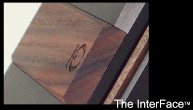

Yes I was right..... And it was a quite a show too. Such a strong proponent of transformer coupling should introduce a product to exploit the virtures of such an interface.
Whoops, it appears I am a little late with that suggestion....
http://www.q-audio.com/home/index.html

Thanks for the plug. Beautiful, isn't she?
se
