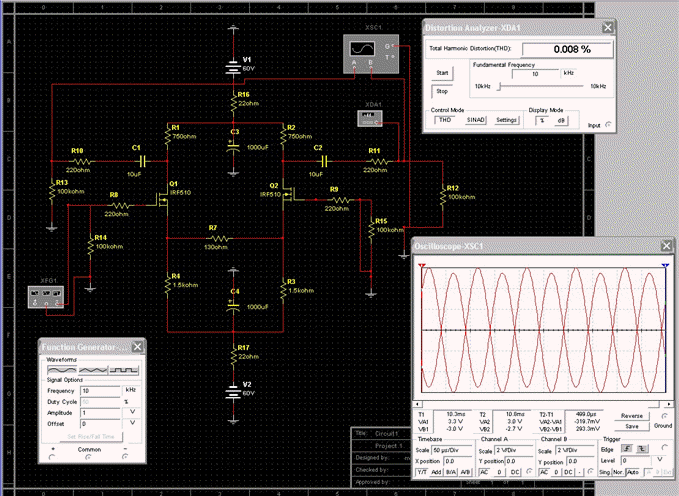

I'm simulating the balanced line stage using the demo version of Multisim 2001 and i'm finding behaviors i don't understand:
1) If I enter with the signal source common in the negative input I obtain a perfectly balanced output but with a poor distortion performance (0.26% THD @ 10KHz)
2) If I ground both the signal source common and the negative input of the circuit I obtain a little unbalanced output (about 1Vpp difference on a 11Vpp output) but with a great improvement in the distortion figure (0.008% THD @ 10KHz)
The theory tells that the correct configuration for use with unbalanced input is that of 2, but this seems to be not applicable if i want to drive an amplifier with balanced input or to bridge a conventional stereo amp.
So, what to do ?
I attached the image of point 2 to explain the low distortion but the unbalanced output
Thank You

I find that measurements referenced to ground are a real good idea for Spice simulation. The circuit you are analyzing is really optimized for a differential input, and will have compromised performance when driven single ended. Connection to the negative suppy with a current source will help the single ended performance.
"1) If I enter with the signal source common in the negative input I obtain a perfectly balanced output but with a poor distortion performance (0.26% THD @ 10KHz)"
This is driving the input differentially, but there is no ground reference for the input. I have been burned like this before. Drive one input with the method in part 2 and the other input with a voltage controlled voltage source with a gain of 1 and the phase reversed and you should get more acurate results.

I don't trust its distortion and loop stability results on an absolute basis, but relative results can be informative. HH's advice on using ground-referenced signal sources for distortion measurement has certainly proven valid in my experience with Electronic Workbench (version 5.1).

Distortion simulations should be no problem. The best way to view it is to look at the intercept point of all the harmonics. This will show you the relative levels of each harmonic, whether they are monotonic with input/output level and whether you are operating in the simulator noise floor. The fundamental should increase 1dB for every 1dB increase in input, the second harmonic 2dB for every 1dB in input, the third 3dB etc ... If they don't follow this trend then the simulator tolerances need tightening &/or the transient timestep reducing. THD simulations (or measurements) will not tell you any of this.
If you are simulating a balanced circuit then even harmonics will cancel perfectly so you should add a sensible amount of offset/mismatch to see what they will really be like (probably still way below the odd harmonics).

The way to measure performance is I guess in unbalanced mode to short the other input to ground,then achieve your measure ON THE REAL CIRCUIT ASSEMBLED balanced at the output.Sure you will get a nice powerful voltage swing with low distortion,assuming you measure DIFFERENTIALLY at the output😎
