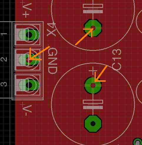

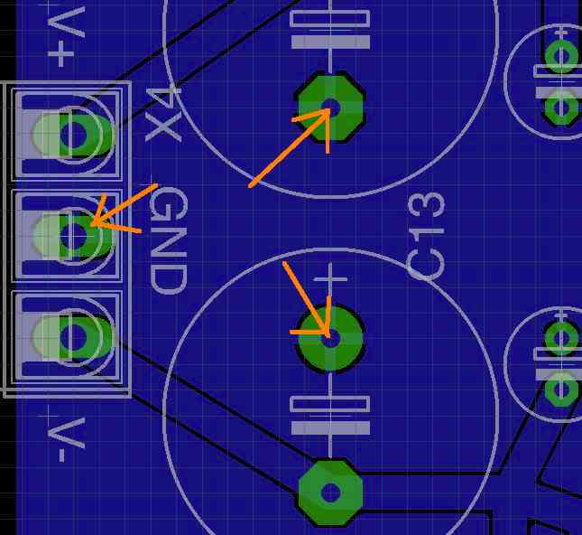

For the component grounding connections:
i guess the blue or red show's up depending upon which layer is active.
Guess both ground planes are connected, which seems logical, since both have the name "GND".
Blue = Bottom layer
Red = Top layer
See pics. I hope its ok. Never noticed this before, since I wasn't sensitive to it till now. 🙁
Chris

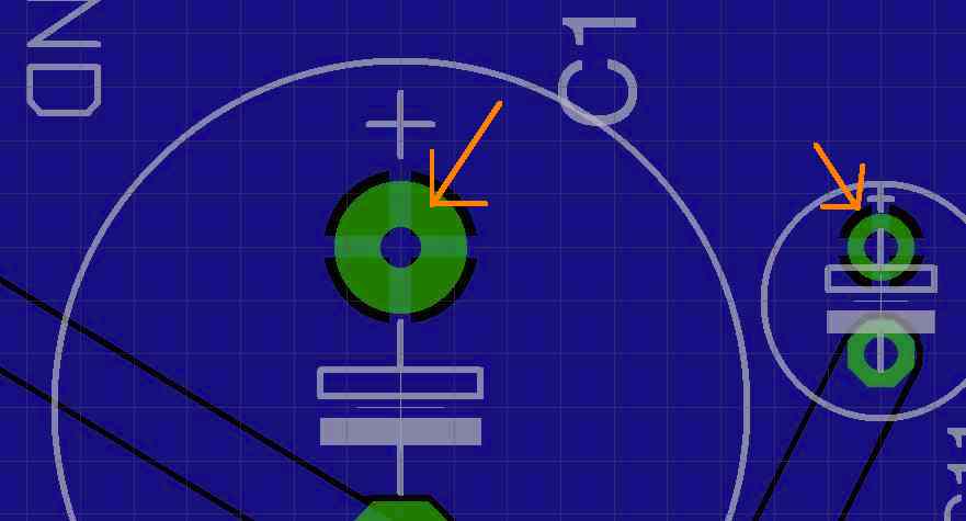

Unless I'm missing something, it looks OK. Anything that connects to ground will do just that when you have a ground plane. This looks like exactly what is in your pics where both ground planes connect to the ground pin of the caps and the 3-pin connector.
Hi AndrewT,
actually i think what u mean is something called "thermals" in eagle terminology.
These are little islands or circles around the component terminals that are place on the ground planes per default eagle setting.
They should make soldering to the ground plane easier, i hope.
Is this what u mean?

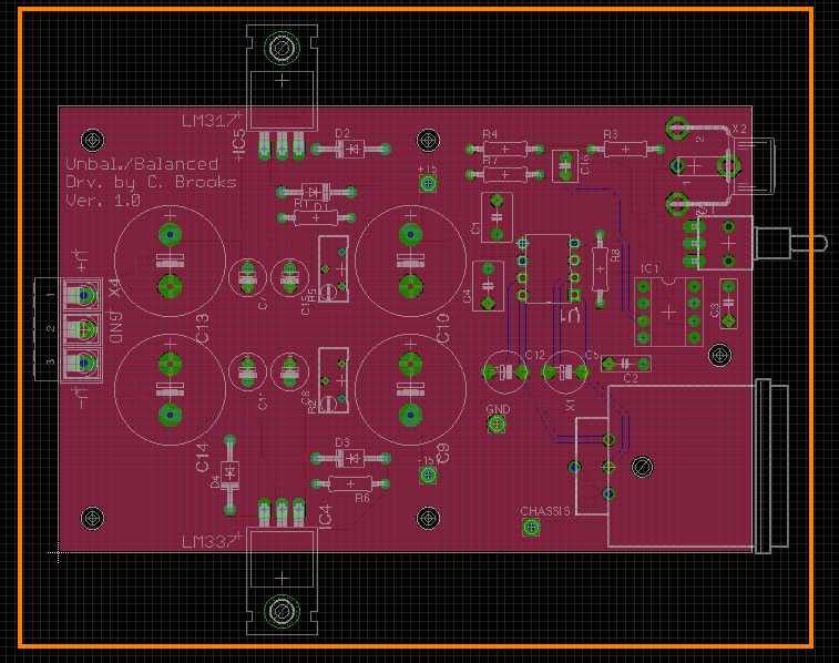

I made a trial gerber run and viewed it.
It looks like it thinks my board dimension is larger than what i intended it to be. See orange outline in pic.
Is this really the physical board dimension?
In eagle i get something like 4.05 x 2.60, e.g. lower left edge of board is 0,0 upper right is 4.05,2.60.
Looks like my gerber file or viewer is including the regulator symbols into the board area.
Is this defined in some tDimension layer or something in gerber or eagle?
Do i just edit that in gerber, e.g. in the dimension layer?
Or can i do it in eagle, e.g. smash part or something?
I was assuming that the regulator symbols would be part of the silk screen which i could edit in gerber...
Chris
There is board dimensions in eagle, its a white box that goes around your design. Is that what the orange box is?
Each component has a value and name, I think they are t_value and t_name or something. You can smash components and delete them if you don't want them. Or you can just not include those layers in the gerbers.
Hi maxw,
no the orange box i painted in the snapshot but that's about how gerber is viewing it.
The problem is coming from the regulator mounting holes. They are included and that's why it thinks the board is bigger.
Actually the regulators will be upright but that's how eagle draws the symbol. Maybe i can tweak it in eagle somehow to make them "vertical".
Chris

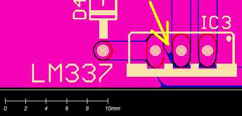

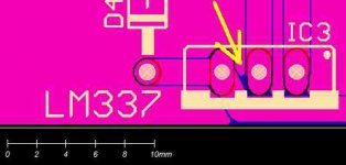

Here's a snapshot of the gerber results. I'm curious what some of you might about the spacing between the thick trace below the regulator. Is the spacing there too small. It doesn't appear to be less than the spacing between the traces and ground plane. The lowest horz. blue space is about 0.166 mm high.
I ran a board houses DRU file w/o errors.
Thanx for looking at it.
Chris

Just take care when you solder it so that you do not get a solder bridge.
0.166mm is very, very small (about 0.006"). It may pass DRU, but generally, such tight keep-away distances are reserved for high density digital boards with surface mount and ball grid arrays where sneaking traces between pins is an absolute necessity.
Also, board houses do make mistakes and I have seen occasional open traces, shorts, and bad vias. I have some recent boards where they simply missed one trace altogether.
Thanx peranders...
I cleaned up the layout a bit and did a dru.
Eagle has a default of 10 mils. This passed so I changed the settings for objects, pads, drill/holes etc. to your suggestion of 15 mil's and it passed again.
Chris
