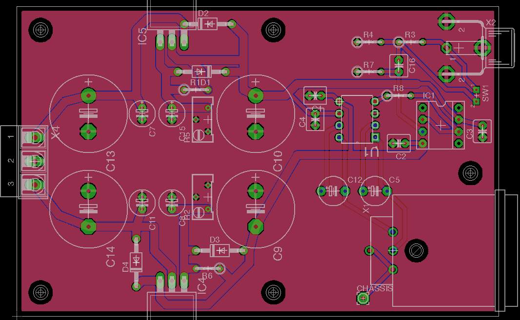

Thanx everyone,
guess I'll be tweaking it for a while still... Here's another update with GND plane, hope its more readable now.
I will be working on it a bit every day, staring at those traces and the schematic.
After a design rule check:
dimension, e.g. parts not lining up to grid points
overlap, looks like i have some tracks on tracks/pads, etc...
drill size issues
After an ERS check:
Power pin IC1 V+ conected to +15V
Power pin IC1 V- conected to -15V
Power pin UI -V0 conected to N$4
Power pin U1 V+ conected to +15V
Power pin U1 V- conected to -15V
Part FRAME1 has no value
Part X4 has no value
Only thing above which may be an issue is the -V0 to N$4 as far as i can tell.

Yet another layout version
Thanx peranders,
those prev. versions were def. junk! Thanx for the pointers!:)
The diodes in this next version should block vin from being connected to vout.
Gonna also fix those traces where the parts go through the middle of them!
Chris

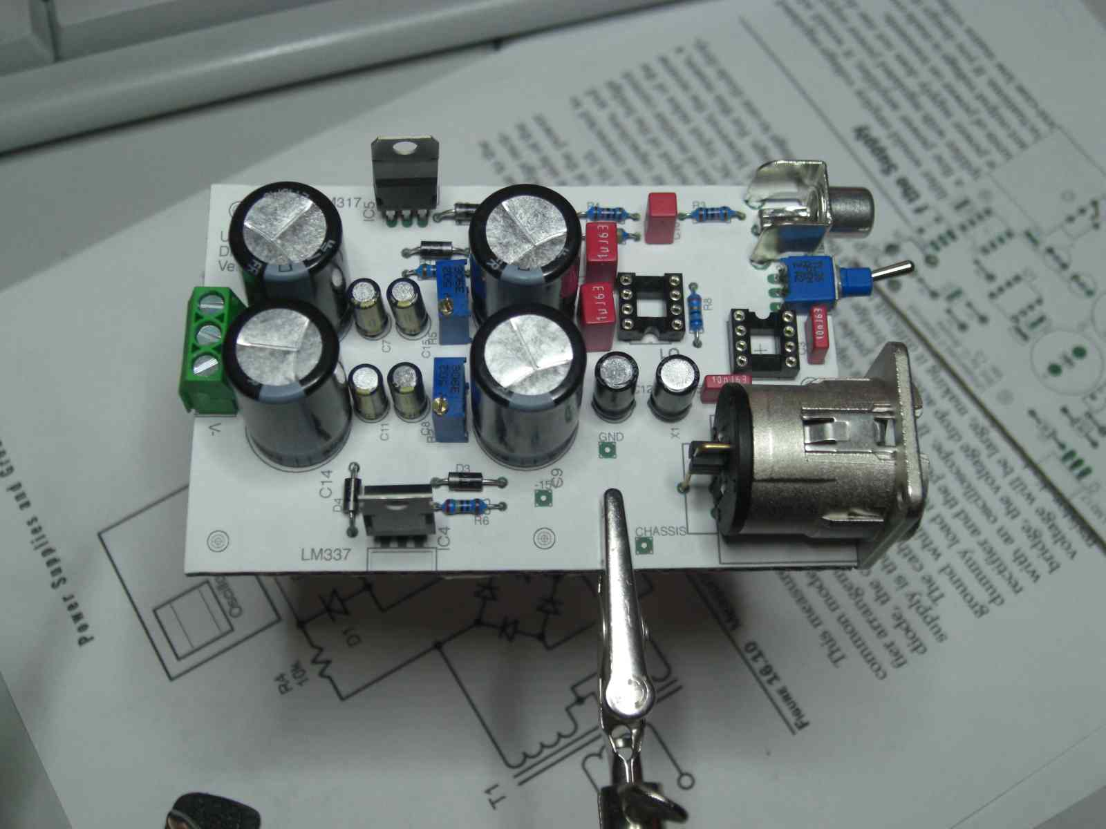

This thread is funny in that I just completed the same design - almost.
The only real difference is that I did not require an input cap for my application, but I can easily wire one from the input connector to the PCB if needed. My input impedance is 470KΩ.
The board sits in a metal box and has two XLR connector pigtails exiting the box and two RCA jacks mounted to the box.
The power supply is a simple wall wart that produces ±15VDC and I added additional filtering inside the box.
Here is the ground plane layer:
I put it into service yesterday and it seems to work fine.
I had 3 PC boards made at ExpressPCB for about $80.

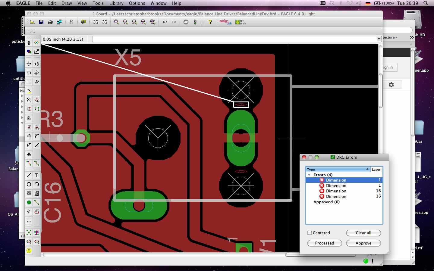

Some Eagle Errors
I got these dimension errors in eagle. My RCA jack is violating some minimal spacing distance between the ground plane and its connector....
Not sure how to fix it, since the part itself defines the spacing of its terminals??
Maybe I'll have to find a different brand to use.
Chris

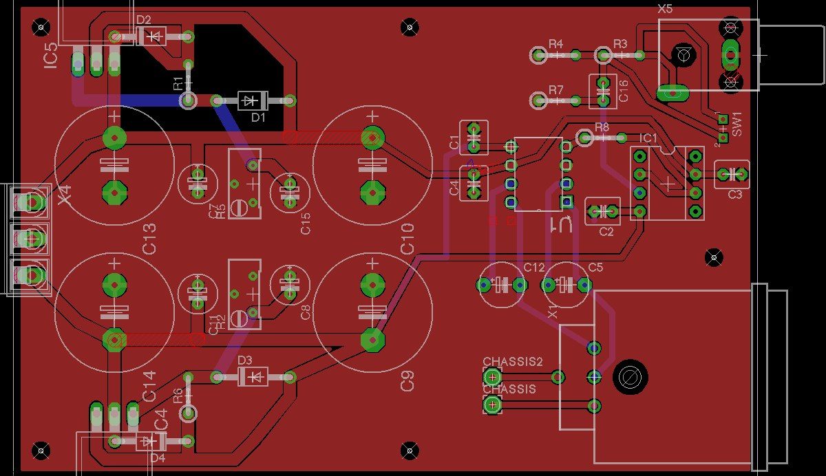

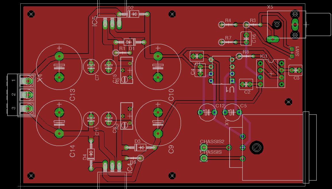

Almost done....
Hi everyone,
I'm getting close to finishing up the layout. Now all of my dimension errors are gone. I replaced the RCA jack with another one to accomplish that.
I also added a ground polygon to the bottom layer, which only has a few signal traces.
I made the traces to the op amp and driver stuff a little thicker but retained most of the thin ones for their pin connections.
The thicks traces are 0.066 and thin ones are 0.032. There's still quite a bit of room to increase them on the regulator side of the board, any suggestions?
Chris

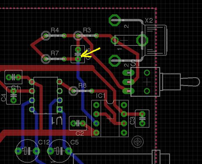

Hi Everyone,
I'm getting to the point were my board layout is just about finished.
My question is:
Do I require a via where the yellow arrow is pointing or is "eagle" smart enough to put one in?
Logically, I would think so, since the capacitors terminal should be connected to both traces.
Would appreciate any comments on that.
P.S. the red lines are on the top layer and blue ones are on the bottom.
Chris
Hi Everyone,
My question is:
Chris
It should be automagic.
Worse case is you may need to solder both sides, but generally, al boards have plated through holes.
