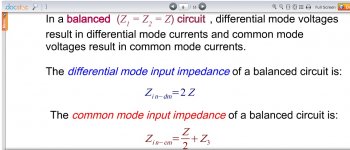

The wiki gives no formulas for Zin (not for differential and not for common mode). So I looked it up, the Zin you are referring to is called 'Common mode input impedance' and this one is not important for the cartridge (it is for the common mode signal). It is the differential impedance that is important for the cartridge and it is (in the given case) 102.2ohm.
The information and the formula's can be found on:
Differential Amplifier Common Differential Modes
Frans.

In this case you did build a high Zin differential amp, and then lowered the deferential input impedance of the circuit by adding resistors parallel to the input of the amp. This works fine, but was not selected by me, due to the fact that I like a as low as possible components count (and this configuration adds at the least two opamps, and one in the signal path).
The configuration that I selected has a low differential input resistant and thus does not need the two ‘extra’ opamps. This is not the best solution in regard to common mode rejection, but it is more of a compromise. I used the following reasoning; the ‘standard’ circuit has no common mode rejection at all, the selected one has (using the .1% resistors) around 80db (or more), and that is a good thing, especially as no extra components are needed (compared to the ‘standard’ solution).

In the example I posted, and using the definitions in your link, Z1,Z2 and Z3 are infinite with ideal op amps, in reality they will be limited by the op amp input characteristics but will be much higher than 100 ohms to well above 20kHz.
In the example I posted, the cartridge and its 100 ohm load would be connected between pins V1 and V2, which places the cartridge in parallel with the 100 ohms. Gerhard's design works like this.
