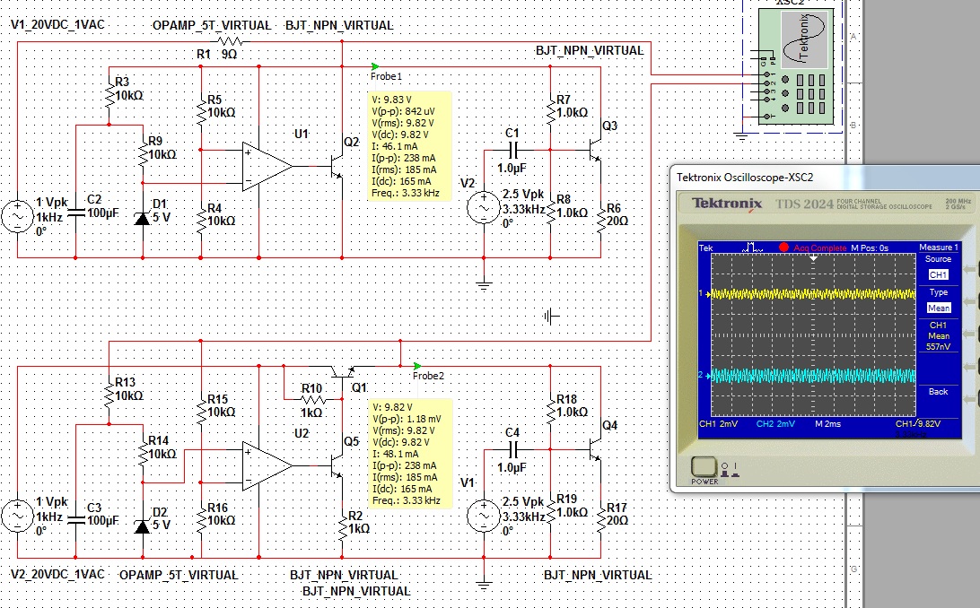

Now I have to try it 🙂 I will replace the series regulators with shunt regulators. The current boards do not allow for a discrete build, and thus I am getting a few drop-in replacements. To fit them in their current spot TO220 models are needed (with fixing hole) and I found NewClassD (NewClassD UWB Regulator) with the types that I need (but only up to 15V). After exchanging some mail with the very helpful people there they offered to supply me with 24V versions (custom build). And that is what I am going to do 😀 keep the fingers crossed.
The quick simulation that I did last night convinced me the shunt regulators could be an improvement. I have the schema of that simulation attached. The schema is not optimized in any way, but it was the most simple implementation of a series and a shunt regulator, both with about the same type and amount of components.
Frans de Wit.
You are really dedicated to make somthing good. It will be very interesting to know if the application of a Shunt brings you any benefit. I have seen the design you will use and i am curios how it will work.
I aso did a little circuit that uses your MC input scheme but has lower noise. You could also try the LME49990 that has even less distortion and better PSU rejection.
In the case of the LME49990 i whould use 10 Ohm and 300 Ohm resistors because it can only drive 20mA in comparison to 40mA of the AD chip.

I will install the LME49990 in the diff input stage. 😉
I am not convinced about the lower values resistors. Using lower values will reduce noise, but, it will also make for a mismatched impedance to the cartridge. The MC preamp is used with a Koetsu Rosewood Signature it is specified as needing a 100ohms load impedance and will then deliver 600uV.
The question remaining, and that I would like to see answered, is this; is using lower value resistors a tradeoff between noise and impedance matching? and to what effect?

I think the only way is to listen. I found that also the type of resistor is important.
The best sound i got so far is with DaleRN65E. I the case of a conventional input i landed between 150 and 300 Ohm in parallel to the cartridge with Lyra Titan i.
If i understand your circuit right you have not the same impedance in both legs. Taking my variety of your circuit the positive leg whould see 5 ohm and 150 Ohm in series when i ignore the ( high ) input impedance of the positive input of your opamp. The negative leg goes to a 5 Ohm resistor and then to virtual ground so your Koetu whould be loaded with 160 Ohm because both inputs are in seies. Do i see that correctly ?

The 5ohm resistor is the internal series resistance of the cartridge, and not part of the circuit (sorry I forgot to take it out before publishing).
In my opinion the input impedance is 102.2ohms (51.1+51.1). As the voltage difference between +in and -in is virtually zero, it may be seen as a shortcut, and thus the feedback resistor and ground resistor are no part of the input impedance equation. Mmm… (I think).

And I checked (due to the Mmm... 😀) and found:

Or am I way out of line here, and did I read your post wrongly? 😱
You are right.
Differential Zin (between the two input pins) = R1 + R2 (Note: this is approximate)
