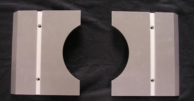

This is the hifi2000 design you were talking about, with 10mm front plate ?
http://www.modu.it/pesante_diss_10mm.jpg
For me too thin. See how thick the PL front plates are .....
Our design is better, that I can say for sure. But of course always a matter of individual taste.

Don't you think that such a good F5X design from me also does not deserve a gorgeous looking enclosure from the same designer ?
Plus that by buying from the forum, you are supporting this place and not some business. As said, we already volunteered to do this for no profit.

It is actually very easy to work out, just count the number of power MOSFETs.
Both Nelson & I design to about 32W dissipation.
So the enclosure we are designing e.g. can take 8 power MOSFETs.
Q.E.D.

I talked to Variac just now and he was worried that people would not be prepared to spend USD 600+ for a case. So we are trying to see if we can find local manufacture in the US to save shipment costs. But I doubt we can get much cheaper. As i said, aluminium has its price.

Patrick have you taken in to account heath spreaders for the mossfet.
May be worth fitting the power fet on to a copper plate so to ditibute the heat on a larger area of the sink and maybe a further plate on top so to help with heat disipation and putting even pressure on the mossfet thus not relaiing on the fitting holes only.
May be worth looking in to it now as maybe if the sinks are anodised may be worth having an area of those bare and lapped.
As juma mention there is a fair bit of power involved

The Conrad sinks are blank on the flat side.
The back face is about 10mm thick, so no real heat conduction problems.
Any spreader plate less than 10mm thick is not helping at all.
There are tricks to get heat spreading much better, but you don't want to know !!
Too complex, way too expensive, and then people would say over-engineering, not worth it.
Patrick
Definitely !
I am very much interested in a nice case. I like especially heavy, thick, machined, pass-style CNC-parts on the case.
I'm totally up for an EUVL quality chassis.
Can I ask that the heatsinks are all pre-tapped, ready to pop the pcbs onto and bolt the FETs too?
... willing to pay for quality, don't care if 50 other people have the same, qusp let your ego go!
You read my mind. EUVL will tell you that I am trying to get all PCB's to have a mounting standard, so I asked him to also conform to the standard.
Mark
Don't forget that pre-tapped holes on a general pattern means more holes than you might need, and hence more costs.
Patrick
PS Thank you Mark for your kind words. I am glad you like the case design.
We shall publish it when the forum is ready to organise a group buy of some sort.
