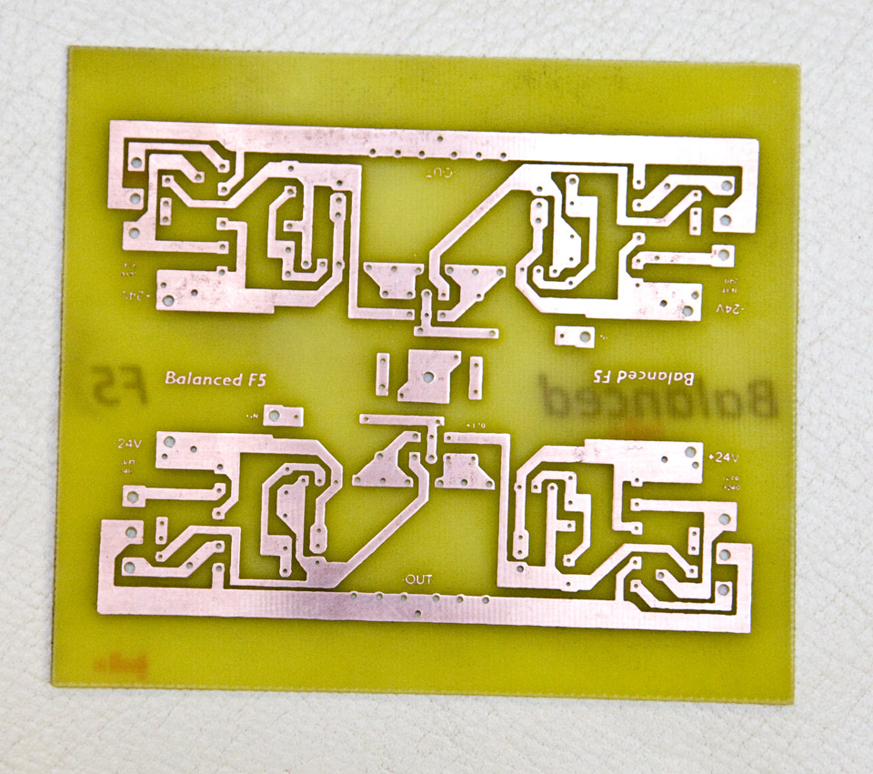

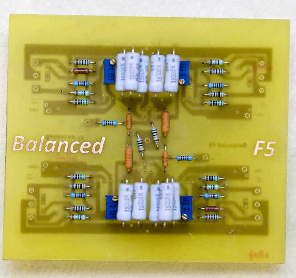

Half way to one channel
Well, I've been pretty busy with my day job, so progress has been slow.
I settled on a design 3 days ago.
I etched the PCB two days ago.
I'm about half way stuffed tonight.
In retrospect, I wasted months trying to glean information from a few folks to no avail. Finally, NP was gracious enough to answer my basic questions (a few days ago), and I was off to the races.
The design is straightforward. Most of my concerns were easily addressed by NP, and the build is quite easy. I'd guess I'll be testing a channel by tomorrow. My biggest mistake to date...not moving forward months ago.
By the way, I welcome "unnecessary discussions". I think its the best way to learn. While I'm swamped at my day job (18-20 hour days lately), I find DIY Audio relaxing and enjoyable. I'm not the most savvy fellow with electronics, but I take risk for a living, so I like to experiment.
