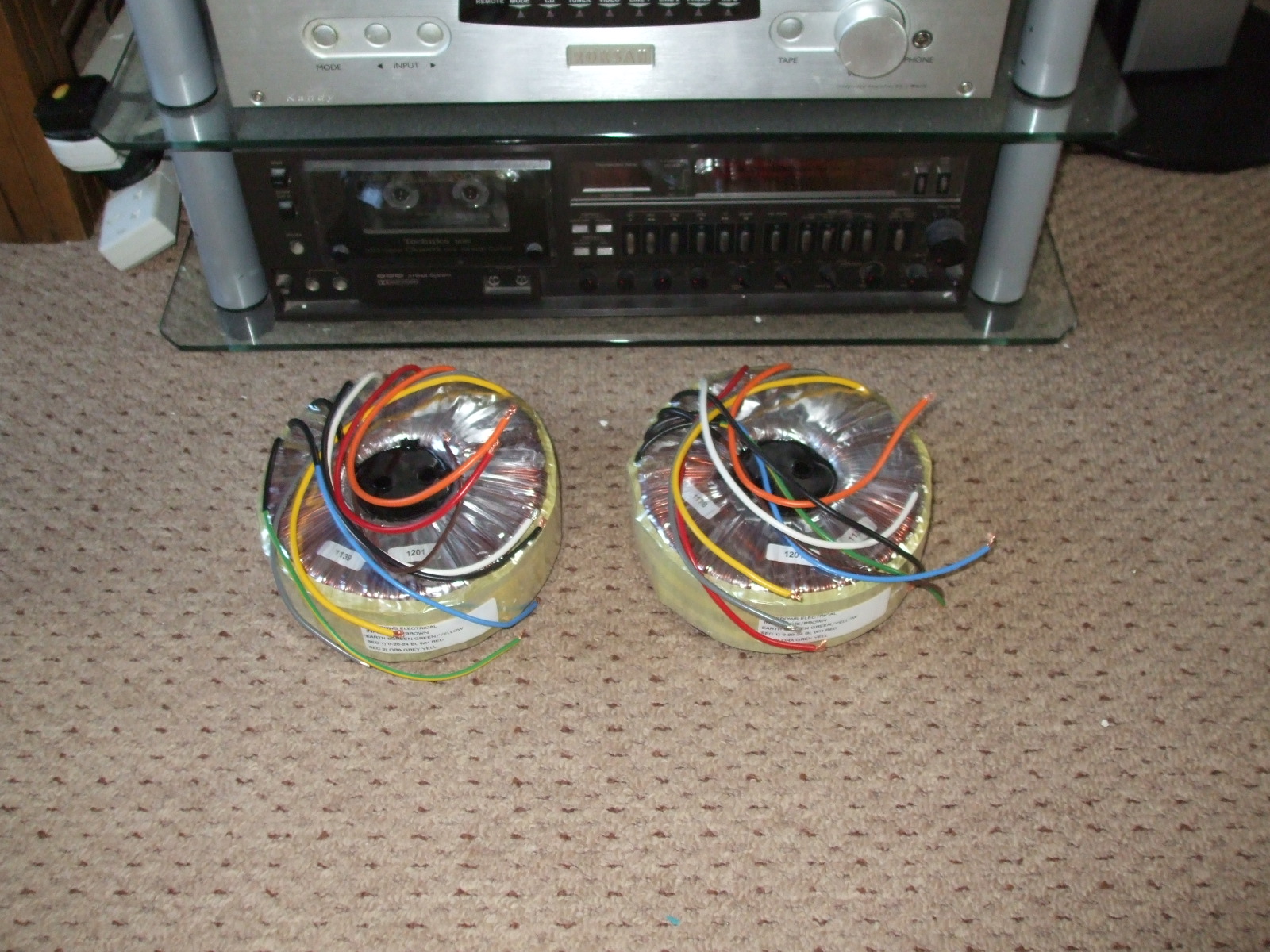

ones in picture are 1000VA 24V with tap at 20V.
Minimum order 10
And Exactley same cost as to me (P&P extra obviously)

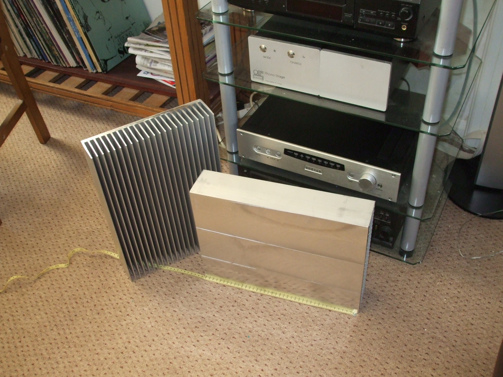

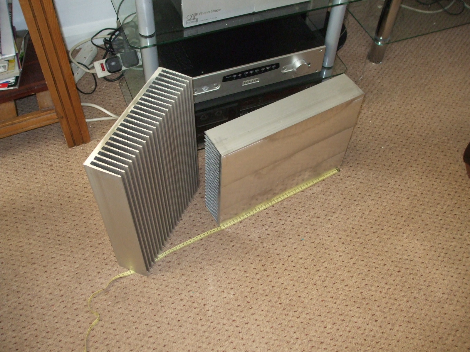

We have now the regulator and capacitor boards done and checked. We also have the protection & control boards done and checked. I am trying another method of conversion for the amp board. Hopefully we'll have results next week. The documents for the schematics and bills of material are available as first drafts. And we have ordered parts for the prototype for the case, including heat sinks.
The team (of 7) is well organised as to who is going to do what. So hopefully, we shall be able to give you a clear picture before Christmas, with photos.
