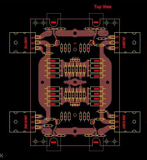

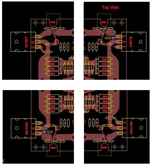

F5X PCB layout options
Given the heatsink and enclosure issues, has anyone considered breaking the PC board into smaller pieces could be placed at the optimal heatsink locations, in a larger variety of enclosures? For example, consider fracturing EUVL's layout from post #109 as follows.
EULV's original layout: F5X-layout.jpg
Fractured layout: F5X-fract.jpg
The issue is whether wiring issues between the pieces can be resolved to make this work well.

The idea is good, but if you would read posts #326, 327, (339) and 341, you might also agree that it brings very little.
At most 2~3°C, at the expense of larger PCB and long signal path for the X.

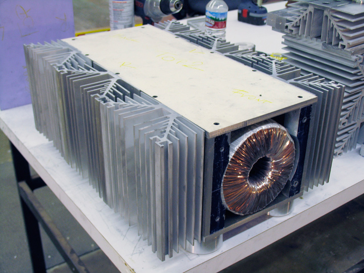

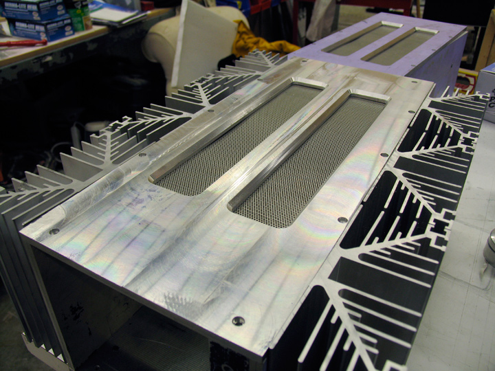

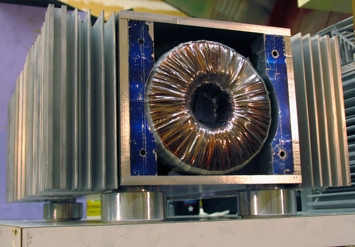

Since the conversation is about heatsinks and proposed case design, I just wanted to share with you cases I made about five years ago to give you idea of size and price that goes with that. As far as I remember, I paid something in the range of $ 600 - 800 just for heatsinks. It took me around 6 months of almost daily labor to produce these cases. All that I could say is, if Patrick stay in the rough price range for the cases he is trying to make for the diy comunnity, that would be the bargan. Just a labor alone to put together case, and machinery needed to do it properly will worth the price. Aluminum used in my cases, was expensive, very expensive, but I do not remember the number. Than add, finishing, nice screws... It really takes a lot to do it.
