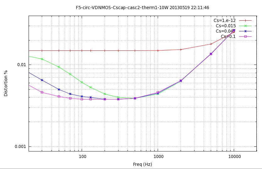

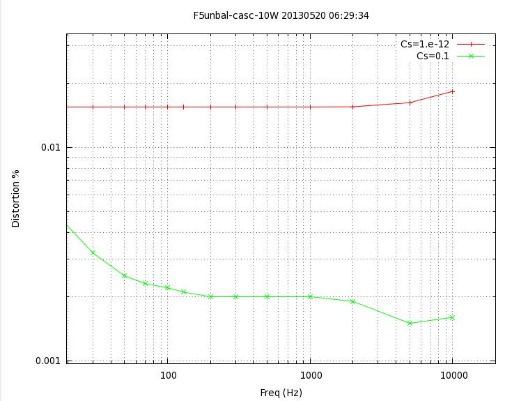

I did a simulation of an unbalanced cascoded configuration with a 4 ohm load. The left plot shown below is a plot of the 3rd harmonic with 1pF and .1F caps. It is nearly identical to the 3rd order plot for the balanced configuration. Of course, with the unbalanced configuration, there is much less even order harmonic cancellation, therefore the THD (not shown) is much higher. This result suggests that the caps with cascoding would be helpful for the unbalanced F5, particularly if the N and P channel MOSFETs are better matched in transconductance and internal Rs.
In the right plot shown below, is a similar simulation for a cascoded F5 circlotron with caps across the source resistors which DOES NOT show a reduction in the 3rd harmonic. I believe that this is due to to topology of the global feedback loops. In the balanced F5, the 2nd harmonics are mostly cancelled by the push-pull outputs before the feedback loop. In the F5 circlotron, each feedback loop receives the output from a single-ended output stage with is highly polluted with 2nd harmonic.
The lines in the right chart shows some reductions ? Those are h3 lines right ?
What I meant to say is that the cascoded circlotron does not exhibit the same behavior at high frequencies as that of the balanced and unbalanced push-pull output stages. Another plot (not shown) shows H3 vs. frequency for an UNCASCODED circlotron with the same values for Cs. That plot is nearly identical to that for the cascoded circlotron. I do not fully understand this result. Clearly something more than the Miller capacitance is involved.

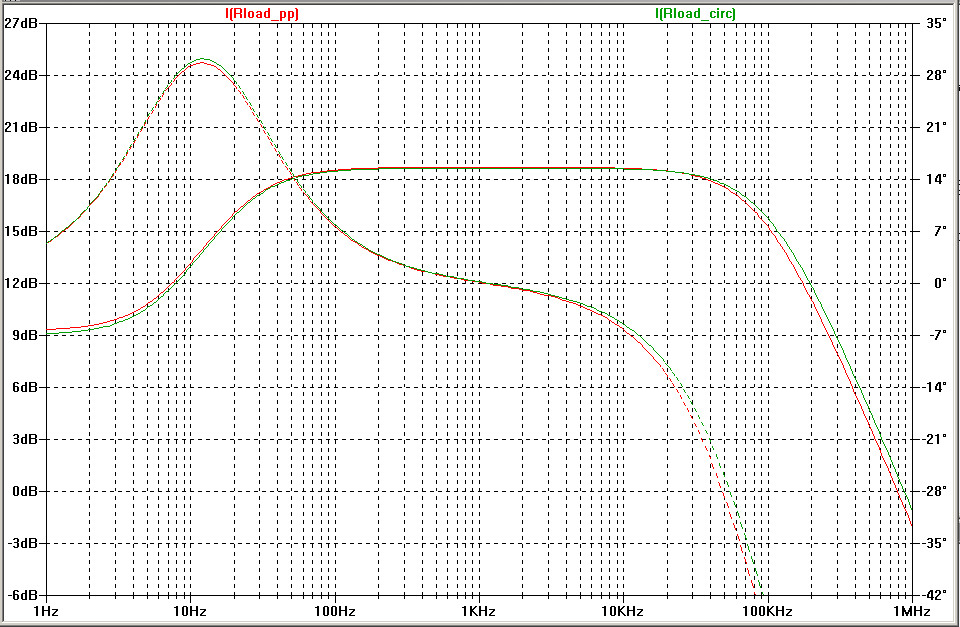

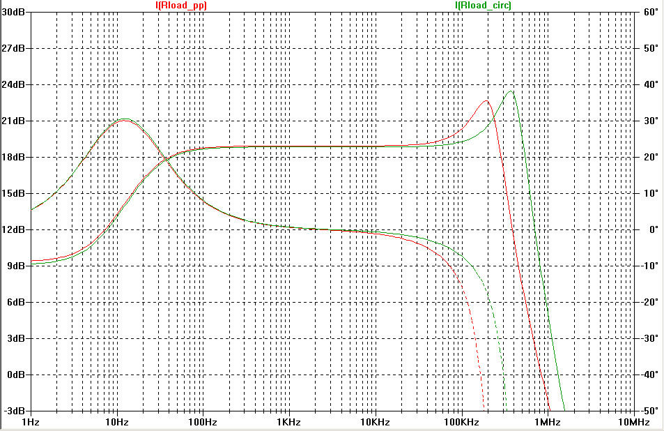

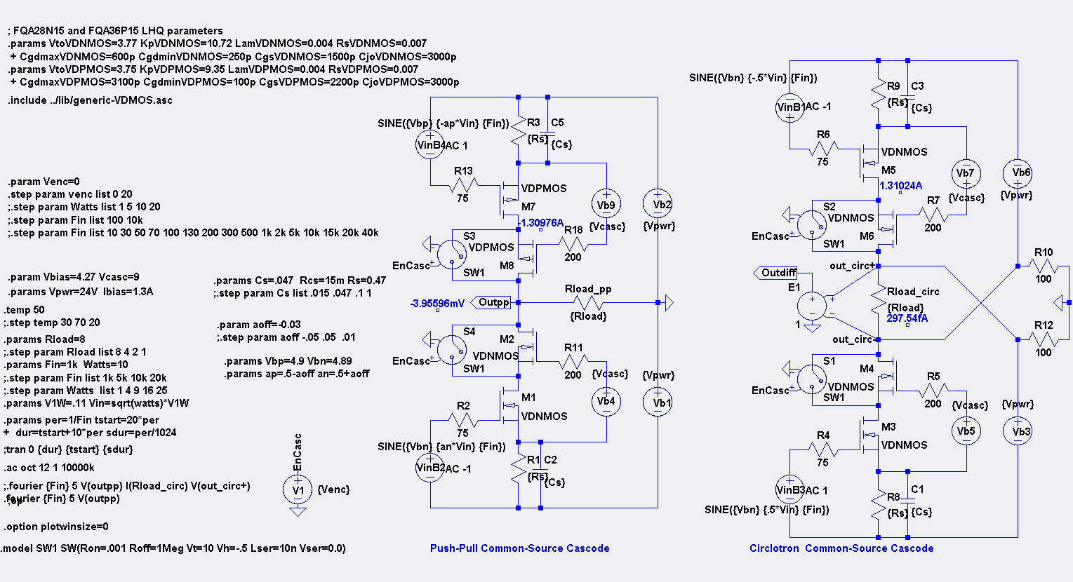

OK, I have clue to what is occurring to cause the 3rd harmonic to be so low with cascoding and caps across the source resistors. Here is a simulation of an F5-style push-pull output stage only, and an F5-style circlotron output stage with and without cascoding. The switches S1-S4 are there to allow the simulation commands to enable or disable the cascode FETs. From left to right the images are the schematic, AC analysis with cascoding, and AC analysis without cascoding. In both plots 0.047F caps were across the source resistors.
As you can see, with cascoding there is a significant peak in the output stage gain at high frequencies. When global feedback is applied in the full amplifier, this means that there will be a higher feedback factor at higher frequencies, thereby decreasing the harmonic distortion components.

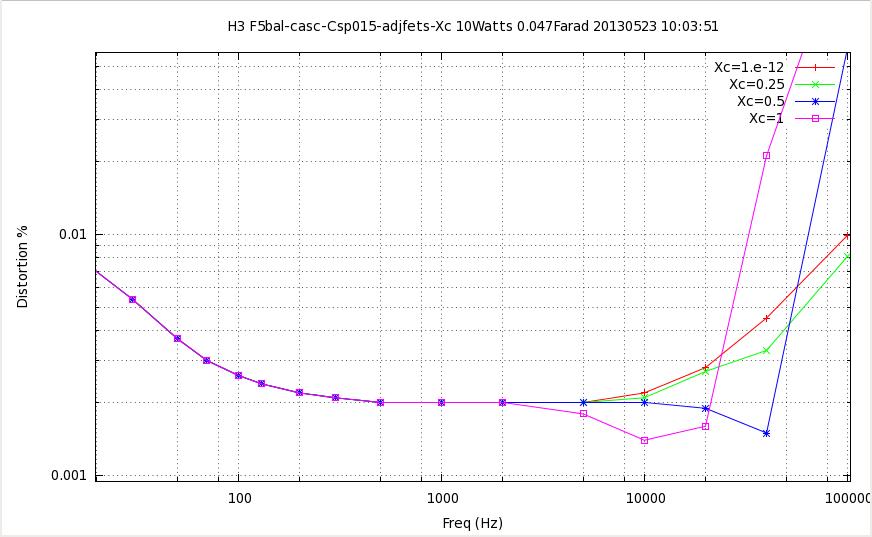

I no longer suspect that the simulations are in error. After more simulations and analysis of the cascoded F5 circuit I think I understand why there is a major decrease in the 3rd harmonic at high frequencies. The FQA36P15 PFETs have significantly higher Cgd and Cgs capacitances than the FQA28N15 NFETs. This might contribute enough phase shift difference between the response of the upper and lower F5 feedback loops to result in some 3rd harmonic cancellation at high frequencies.
I need to do some simulations with varying values of the MOSFET Cgs and Cds parameters. This should confirm my suspicions.
More evidence that the differing MOSFET capacitances and the resulting phase responses are the cause for the "anomalous" low 3rd harmonic at high frequencies as shown in post #138. In the plot below, each MOSFET capacitance of the cascoded, Balanced F5 is multiplied by the parameter Xc. The input JFET capacitances are left alone. With Xc=1, the "nominal" MOSFET Spice model capacitances are used. With Xc=1e-12, the caps are essentially set to zero. As you can see, the "anomalously" low 3rd harmonic is obviously related to the value of Xc.
in the models.More evidence that the differing MOSFET capacitances
