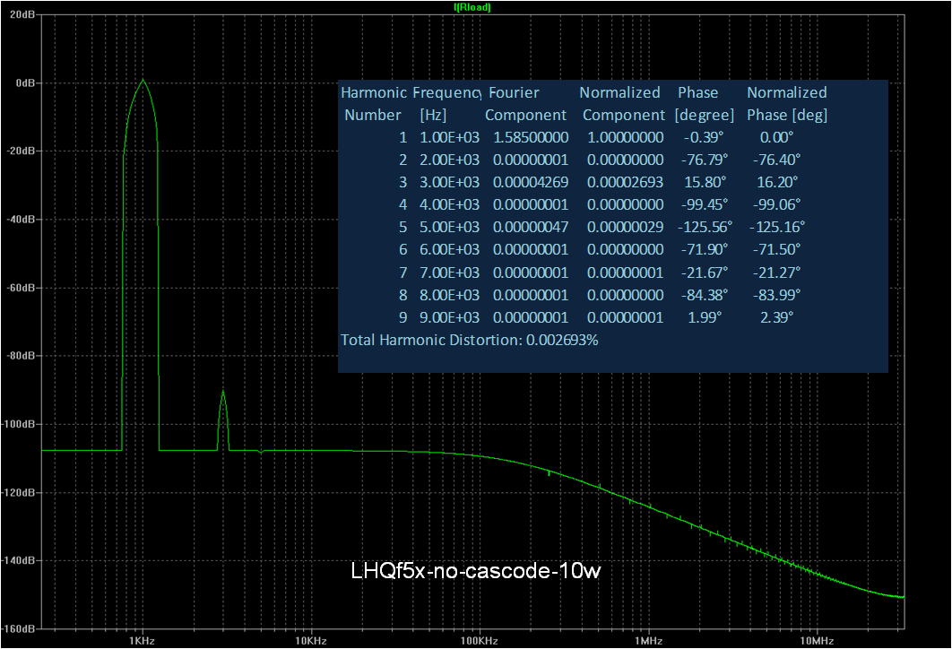

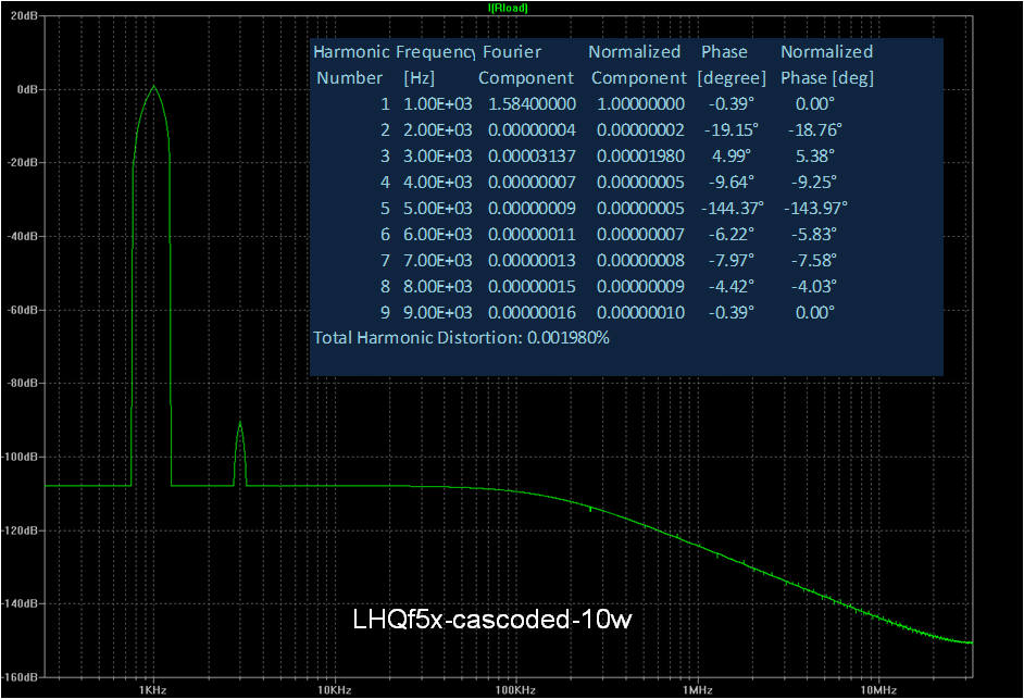

I added the models for the jfets to your asc and ran the sim and the results for your amp were very pretty indeed 😀 - i guess folks can try and retrofit and listen for preferences as well.
I tried 10 watts 1khz with 24volt rails and results are as attached - let me know if you think they look off.
BTW your 'test-bed' parameters and setup alone makes this asc well worth downloading ! Very efficient way of playing with spice. Thanks again.

Oops, I forgot to include the JFET models. I will provide an updated .asc file so that you are using the same models.
Your results appear to be better than I got with 17.6V rails. Be sure to check the MOSFET bias currents when you change various parameters. You must iteratively tweak the values of the parameters R5 and R8 to get the desired idle current. My results are with 1.3A.

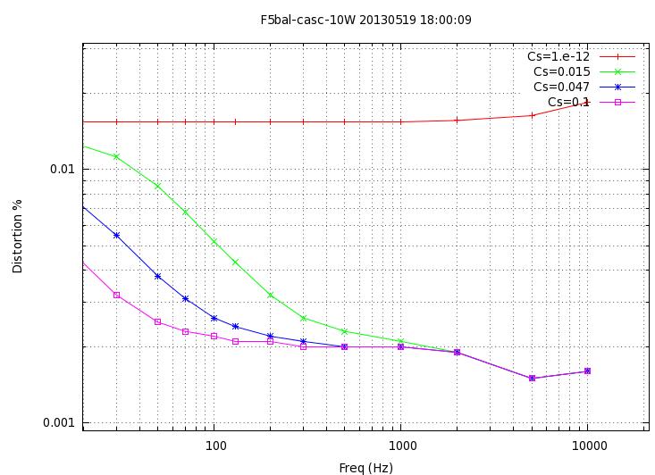

I have some simulations of your suggestion of adding capacitors across the source resistors. Here are two plots of THD in the Balanced F5 using FQA28N15 and FQA36P15 VFETs at 10 watts output into 8 ohms with various values for the caps: 0pF, 0.015F, 0.047F, and 0.10F. The first plot is without cascoding the output FETs; the second plot is with cascoding. The series resistance of these caps was 0.015 ohms, taken from datasheets of available low-Z caps. Because of the balanced F5 even order harmonic cancellation, THD data is totally dominated by the 3rd harmonic.
Obviously, the simulations indicate a path to lowering 3rd (and other odd order) harmonics while preserving the thermal stability provided by the source resistor. The next step for me is to order appropriate capacitors and bench test this modification.

Absolutely rigorous analysis as always from you lhquam 🙂
The real world measurements may well be only half of what the sims suggest -
but the interesting thing in your simulations are the VERY significant difference in HF impact of the caps in the cascode vs non casc implementations.
What do you think thats attributable to, given the small difference (bw casc and no casc) for the no caps versions ?
