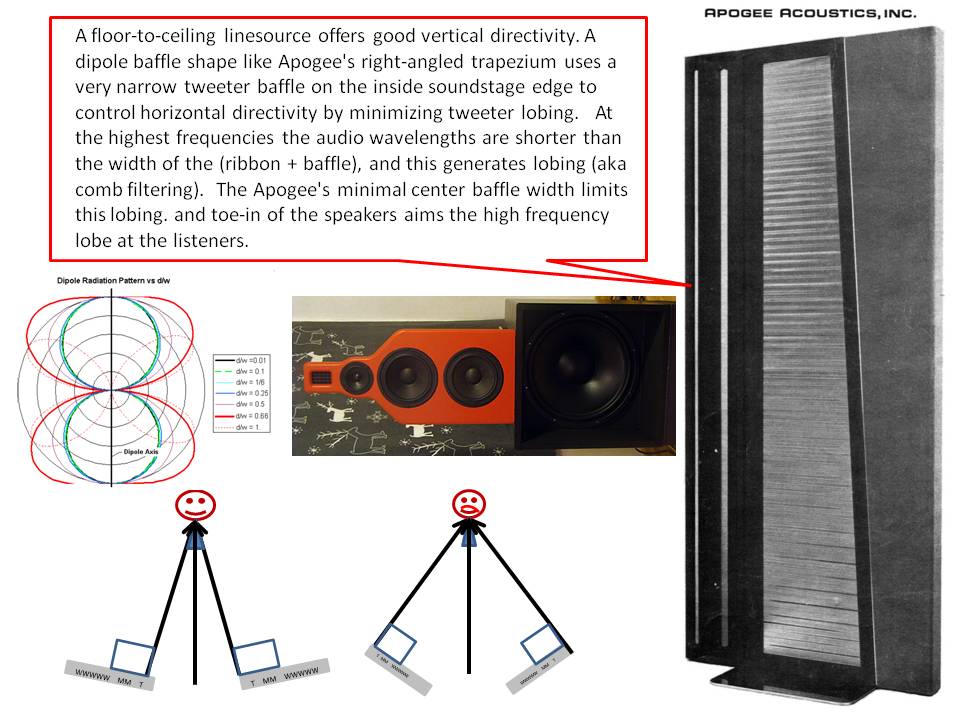

"In the left picture IMG_022 you suggest to move the ribbon speaker close to the woofer baffle. Could you please explain why? "
1) To minimize lobing, I always attempt to keep the driver physical separation below a quarter crossover wavelength, which is 17" C-C for 200Hz. 2) The ribbon-woofer gap will create some additional local dipole cancellation around the ribbon baffle at certain frequencies. This should show up in measurements as a dip around 3Khz, the wavelength width of the ribbon baffle. It should be easy to fill this gap as an experiment.
A floor-to-ceiling linesource offers good vertical directivity. A dipole baffle shape like Apogee's right-angled trapezium uses a very narrow tweeter baffle on the inside soundstage edge to control horizontal directivity by minimizing tweeter lobing. At the highest frequencies the audio wavelengths are shorter than the width of the (ribbon + baffle), and this generates lobing (aka comb filtering) The Apogee's minimal center-tweeter baffle width limits this lobing. and toe-in of the speakers aims the high frequency lobe at the listeners. Stig and JohnK discuss using minimal tweeter baffle widths to optimize the high frequency imaging for controlled directivity. NaO NOTE sideways.

Separation: I just keep on trying the HolmImpulse-Frequency Allocator loop. And of course listen. As StigErik said, it good to have the two baffles separated so that their toe ins can be varied. I will re-invest in pipe isolation and cut it in halves, to close the gap to a minimum without having woofer vibrations influencing the ribbon baffel.

I agree that it is better to have a separate baffle for the woofers and mid-tweet as this allows tweeter toe-in and woofer toe-out experiments.
