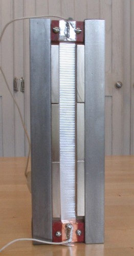

This is what the bare ribbon driver looks like using FEMM:
Air gap is 32 mm.
The area noted as air is actually quarter round wood at front and aluminium at the back. The aluminum is hollow and holds the return cables.
So I should have quarter rounds at the end of the baffle as well:
Then I would end up with 6 cm baffles.
Perhaps I should move the return cables to inside the U.

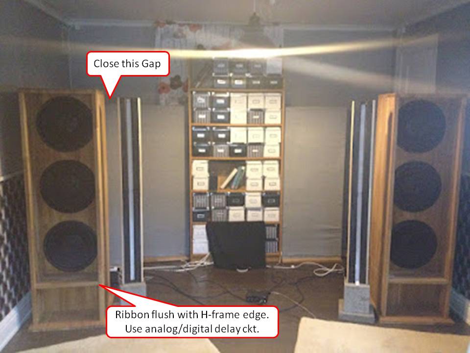

In the left picture you suggest to move the ribbon speaker close to the woofer baffle. Could you please explain why? (Doing it is not that simple as the previous changes).
I see that the ribbons are not flush to the woofer, my mistake. I have already a 0,73 ms delay for the ribbon speakers to correct for a flush mount.

Looking at the driver again, top view:
The ribbon is between the two middle dots.
A flux density plot:
The flux is uniform in vertical plane for practical ribbon excursions but not in horisontal plane (x):
I have solved by using the method with different widths of the aluminium strips giving different current density; wider at the ends where the flux is stronger and narrower in the middle when the flux is smaller.
So Bxi is somewhat linear over the gap giving the same resulting force over the ribbon's surface. But I guess you already know all this.
