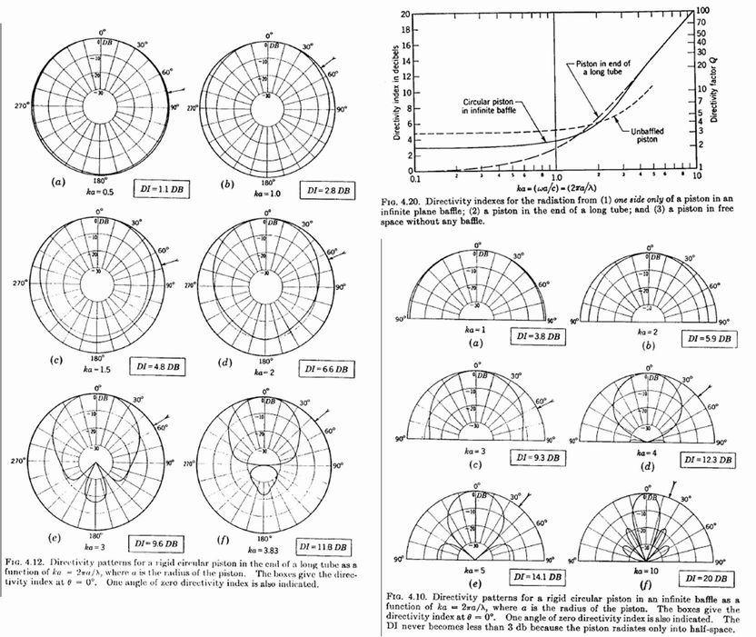

NOW, the effect of "beaming" seems like the next logical turn for this thread. Beaming (correct me since I am probably wrong here) seems to be a function of piston radius and frequency. As far as I can tell, it doesn't matter if the driver is in free space or half space. Maybe Beranek covers this...I haven't gotten that far yet though.
Yup, "beaming" is mainly a function of frequency and piston radius (ka).
But, interestingly enough, even at ka=3, the piston evidently can "feel" whether or not there is a baffle around it.
By ka=4 this ceases to be the case.
Yes, when the driver gets directional enough it stops "illuminating" the cabinet edges. At that point the 4pi to 2pi transition must be complete.

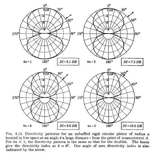

Note the beloved dipole. d.i. of 4.8 at low frequencies and it stays low when the others rise, primarily because it is firing both ways.
David S.
Surely a dipole constructed of dynamic drivers on a baffle must also start beaming at high frequencies and thus increase its overall DI above 4.8dB ? The dipole configuration just sets a lower DI limit of 4.8dB while a monopole eventually falls to 0dB well below its baffle step frequency.
Edit: The image bolserst attached does seem to show this, I just realised that "unbaffled piston" in the top right graph refers to a dipole, showing that above a ka of 2 it does rise but not as much as the other cases.
I presume that graph assumes symmetrical high frequency radiation from the front and rear of the dipole too, which wouldn't be the case with a dynamic driver where most high frequencies would be front firing only, so practically speaking a dynamic driver dipole could still attain quite high DI at high frequencies, and higher than that line would suggest. A symmetric ribbon dipole would probably more closely match the theoretical figures.
That was my take on it, that the unbaffled piston narrowed essentially the same as the baffled piston but directivity would be based on both forward and backwards beams. I don't think "transduction principle" has anything to do with dirctivity.
Note that the text books will say in small print that every driver has twice the air loads shown (not dipoles, of course) but the rear radiation is ignored because it is absorbed within whatever cabinet form is used. You can get away with this if the air load is insignificant, but Keele implys it isn't, giving 1dB error at 0.6% efficiency.

If you look closer at the radiation patterns for infinite baffle and piston at the end of a pipe you will see that as low as ka=2 the baffle is felt. Look at the 90 degree level. With infinite baffle it is down about 5dB, When at the end of a pipe it is down 10dB.

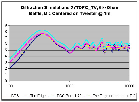

Also, it should be recognized that these polar plots and "beaming" assume that the observation point is far from the source. Thing change as the observation point gets closer, but that makes these analytical solution difficult to obtain. Thus we always see the simplifications that the distance is large compared to source size.
Uh, failing to account for diffraction of adjacent drivers is a problem with the modelling, surely ?
Thanks for helping to prove my point for me anyway, as apparently even the best simulator of the 3 tested has an error magnitude of +/- 1.5 dB through the transition region, (+/- 2dB for the worst one) which is pretty high when you consider the overall transition is only 6dB, that error magnitude is far too high to design a crossover against without measurement.
It would have been helpful if we could have seen the actual measured response and simulated response overlaid rather than just a differential error so that we could see the true nature of the errors.
For example the fact that the error deviation went negative then positive by a similar amount through the transition region suggests that the slope and/or the corner point for the transition was incorrectly calculated.
Likewise in the region above 2Khz we don't know what the source of the error is from only an error difference graph. My guess is that the simulation predicted narrow band ripples that simply failed to materialize in the measurement due to a simplified (or non existent) geometrical driver model that failed to predict the correct driver directivity.
As I've said on other threads discussing similar points, its a useful "first pass" to simulate possible "what if" cabinet scenarios but its not accurate enough to design a crossover against without measuring the driver on the actual baffle.

Nothing replaces direct measurements, that's the truth! These tools allow experimenting with different driver placements and baffle shapes before cutting wood. I'm not sure I prove your point though, you're putting too much faith in my analysis. 🙂

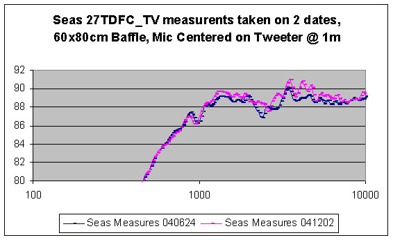

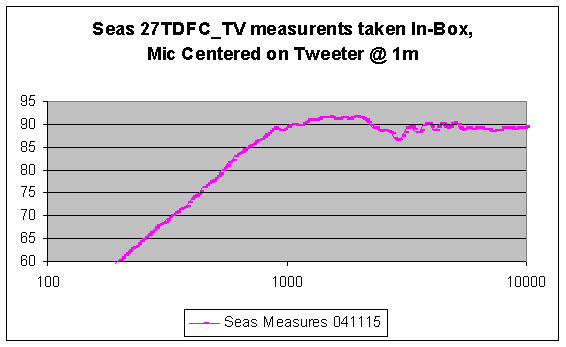

I think I should better explain my analysis. Bjorn at Seas provided a wealth of data for drivers measured in the Seas test box, within their anechoic chamber. He also provided data for a 27 TDFC-TV measured on a 60x80 baffle, in their anechoic chamber. All mounting and measurement coordinates were provided, along with Seas test box dimensions.
My analysis "backed out" the 60x80 measure to a theoretical 2 PI, using model predictions. Three popular free diffraction modeling tools were compared. I then "added in" a model of the diffraction in the test box and superimposed this on the 2pi estimate, to arrive at a predicted "in - box" curve. This was then compared to the actual in-box curve. So, some comments on the sources of error. I'm not convinced these are necessarily due to the modeling tools, but some may reside in the measurement or analysis.
1. There were two opportunities for the model to introduce error, once in the 60x80 baffle simulation, once in the box simulation. Was this error additive or subtractive with itself? I believe it was subtractive (ie nulling out), but that involves too much thinking for a Saturday morning
2. Bjorn took the 60x80 baffle measurements and provided them to me for this analysis. It's not certain that he used the same tweeter in the test box as in the baffle. I believe he did, and that was the intent, but needed to take this on faith since no serial numbers were provided. You can see that turn-over point and slope error creeps in below 800 Hz. This could very well be measurement error caused by using two different tweeters for baffle and box measures with different fs’s. The tweeter fs is in the 800Hz range. If two different tweeters were used, this could also explain the high frequency error. For example, see the comparison of the two different on baffle measures taken on different dates in the attached. I speculated that high frequency error was due to the presence of an adjacent woofer, but have no way to verify that. Using a different tweeter in each measure may have caused the error. This analysis is several years old now and there’s no way to understand if the same tweeter was used for both measures
3. These diffraction-modeling tools only assume the baffle dimensions, and have no accounting for the box depth. At low frequencies the box depth must impact the diffraction signature as the wave wraps around and re-diffracts off the rear corners of the box. Perhaps this is what Ivo was alluding to in his comment that a sphere or rectangular box was more accurate at low frequencies. However, without an anechoic chamber or outdoors to measure in, I can only speculate on the magnitude of this error.
Given these caveats, I would use these tools for modeling just below and upwards of the baffle diffraction peak, without hesitation. I don't have enough data to truly understand their accuracy down to the dB several octaves below the diffraction peak. I am however confident that they are accurate enough to take a near field measure, add the diffraction signature on top, and then splice to quasi anechoic results at ~ 300 Hz.
These also don’t model diffraction off adjacent drivers, which could be appreciable so prudent mounting geometry and final measurements are always warranted. There are ways to reduce this with felt (see my JR rebuild attached) but not everyone likes the look of a speaker with a mustache! It’s my Movember speaker. 🙂
Finally, an observation about the models themselves: The Edge has a fundamental error in one of its model assumptions.
The Edge always assumes + 6dB asymptotic baffle gain at high frequencies. This is only true in the far field. In the nearer field (eg 1m, even 2m) it can be less than this. The error is larger for larger baffle sizes (i.e. the larger the baffle, the further out the mic needs to be placed in order to be in the true far field). The DBS and the BDS don't have this error as they both correctly assume 0 dB baffle gain as the frequency asymptotes to DC. On an IEC baffle, The Edge incorrectly models over half a dB baffle gain as the frequency approaches DC.
I personally would chose either of the other two over the Edge if I was taking the leap of faith to use this to model BDC and not just signature at and above the dipole peak.
Dave
Yeah, I really should have stated the simplifying assumption used in the calculations that produced the plots published in Beranek.
Perfectly rigid piston radiator driven with constant velocity(ie independent of frequency) and measured at an infinite distance.
For completeness, I should have also included the directivity patterns for the unbaffled piston(ie dipole)...attached below.
