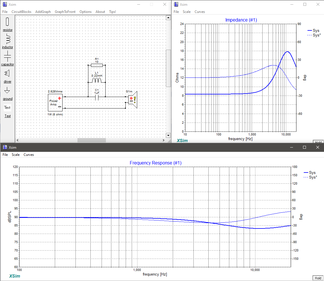

I did some reading and found out something called Zobel network. It flattens out impedance curve meaning BSC filter should work better (its effect should vanish slower as impedance would grow slower). Some even advised to just put resistor in parallel with the driver.
But I am not sure if that would work and what another issues it would cause.
What people do to tame the top end, is an LRC filter in series with the driver, not just a resistor, but a reisistor, capacitor and inductor in parallel with each other in series with the driver, that creates a notch filter to tame peaks. The value of the capacitor and the inductor determines what frequency zone is cut down, the resistor how much. I attached an example (on a fixed impendance not existing driver) as example.

Thanks for providing solutions, guys.
I will first try to employ zobel network to see (hear 😊) what happens.
Then I may want to try more complex solutions if zobel does not solve the issue.

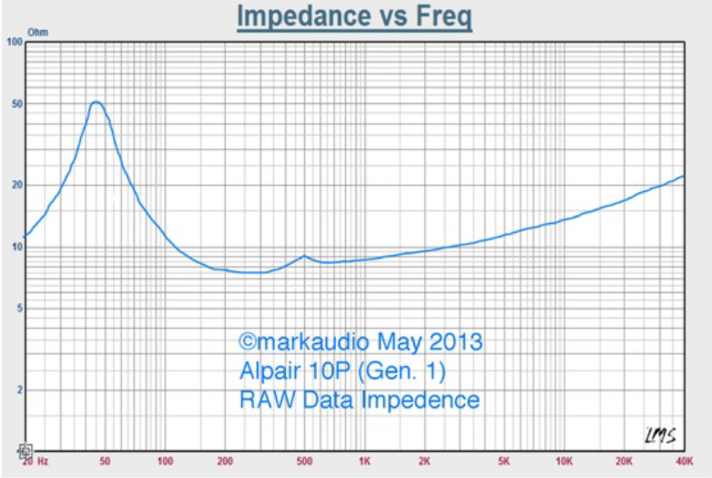

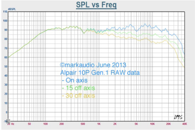

Anyway, if I wanted to use some simulation program like xsim, I would need zma/frd files, but they are not provided on mark audio web page. Just plots that are difficult to process.
Thanks for the favor Allen.
I am wondering how you do that. The specialized and very robust image processing program would be needed for that. I am just attaching the images extracted from the pdf provided here:
https://www.kjfaudio.com/wp-content/uploads/2017/02/Alpair_10P_Gen.1.pdf
You can see x and y axes are not linear/equidistant and the graphs include the text that needs to be ruled out in case of impedance or even taken into account in case of frequency response file.

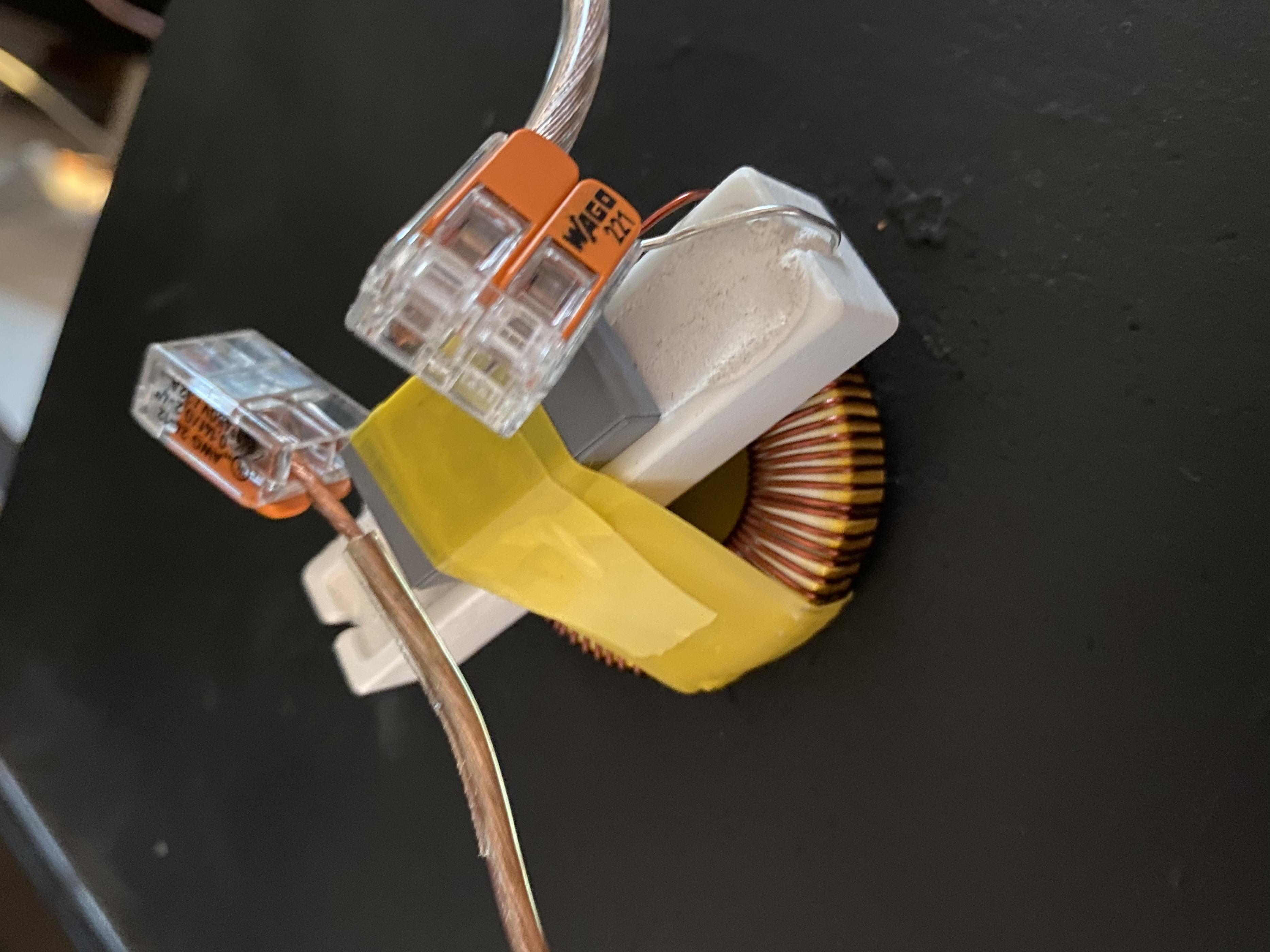

For 8ohm speakers in typical 8in to 10in wide baffles, my go-to standard starting point is a 1mH coil and about 4.7ohms 10w in parallel. That can be added to the outside of the speaker using Wago connectors and adjust the resistor to taste. For more bass, use 6.8ohm, for more sparkle use 3.3ohm etc. adjust to taste. Either air core or iron core can work here. Sometimes I have used 0.8mH or even 0.68mH of you want to move the beginning of the shelf up higher. For 1mH it’s around 800Hz to 900Hz. Just try it and you will hear a difference immediately. Then measure it with REW and a calibrated mic.

Vituixcad and fp graph tracer will attempt automatic tracing, and SPL-trace gives you more control for the difficult ones.
Did you want the 15 and 30 degree files?
Many thanks for the files. I am just OK with the on-axis response file. I will have to try Vituixcad myself (if it works in Wine on Linux). Already tried XSim and it works so can try to import the files 🙂 .

1.5mH is a bit too much. You can always unwind the coils if you need to. Wago is fantastic. It lets me build a complex prototype XO in 10 minutes. It sounds good too. Very secure connections. No soldering or strip panels needed. All P2P with connectors.
Here is a very “Wago’d out XO” I just mad the other day.

I got some wago connectors and it is much easier to switch components in a filter.
My final parallel lrc in series with the driver is 0.5 mH, 10 ohm and 1uF.

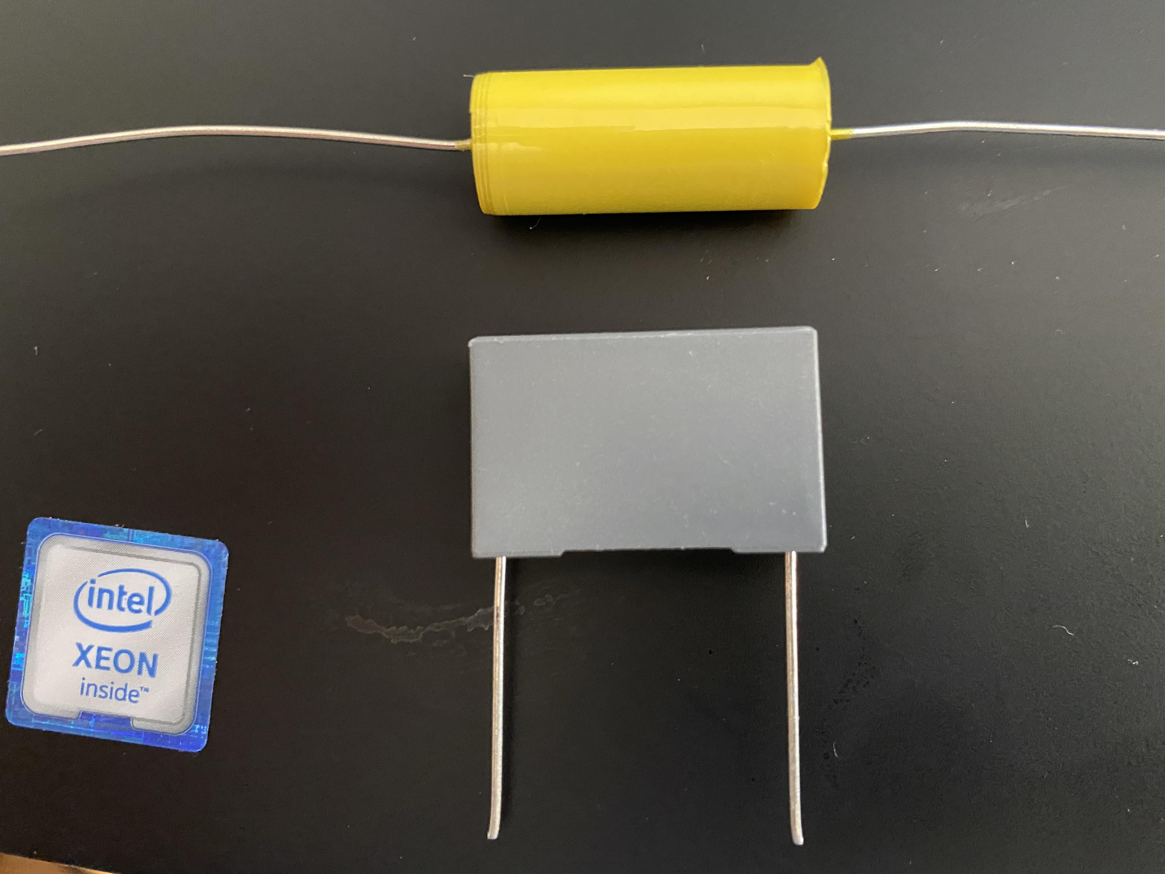

Comparison of cspacigors
I cannot hear the difference when switching the air core and iron core inductors with the same value. But found out that switching capacitors (cheap one vs more expensive one) makes difference. The yellow one (in the picture) costs one dollar and sounds quite bright compared to grey one which costs just 50 cents. In fact, I like the sound of cheaper capacitor more.
Looking into the specs, the yellow capacitor is marked with mkt while the grey capacitor is marked mkp 62. Both have capacity around 950 nF (measured with multimeter).
Not sure what conclusion can be made as there are probably too many external variables in this test.
