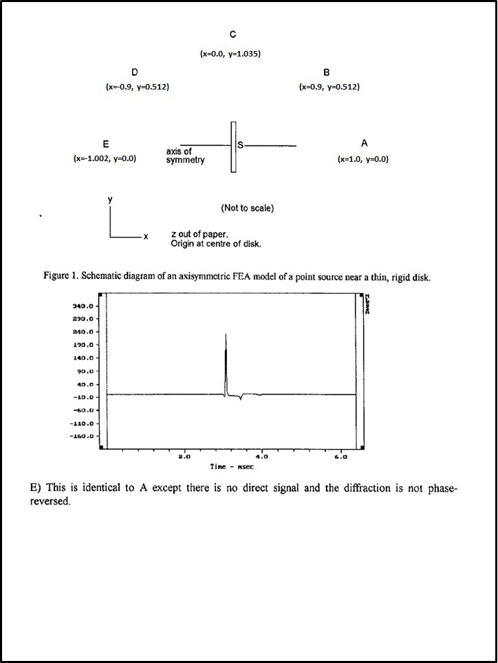

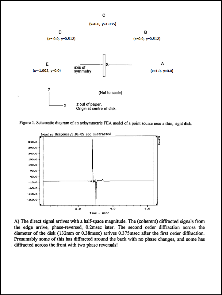

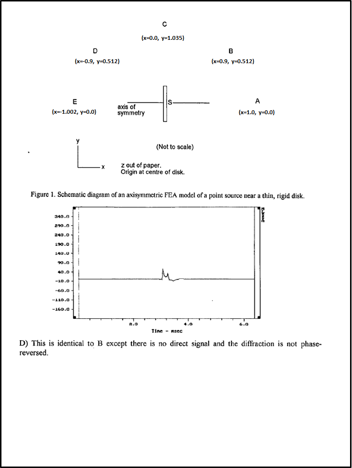

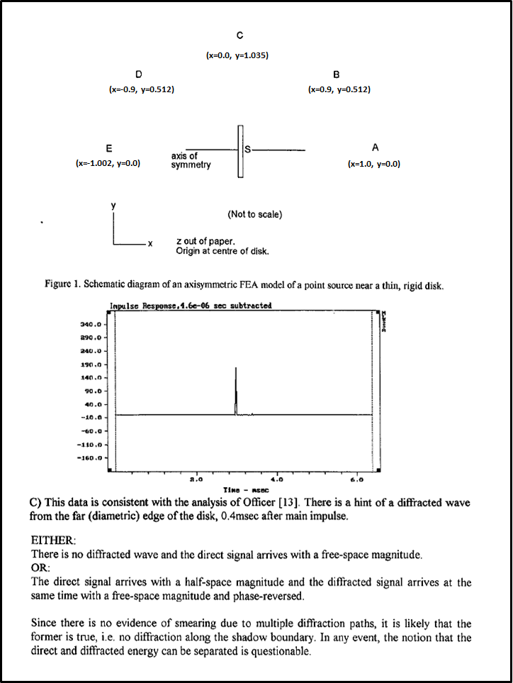

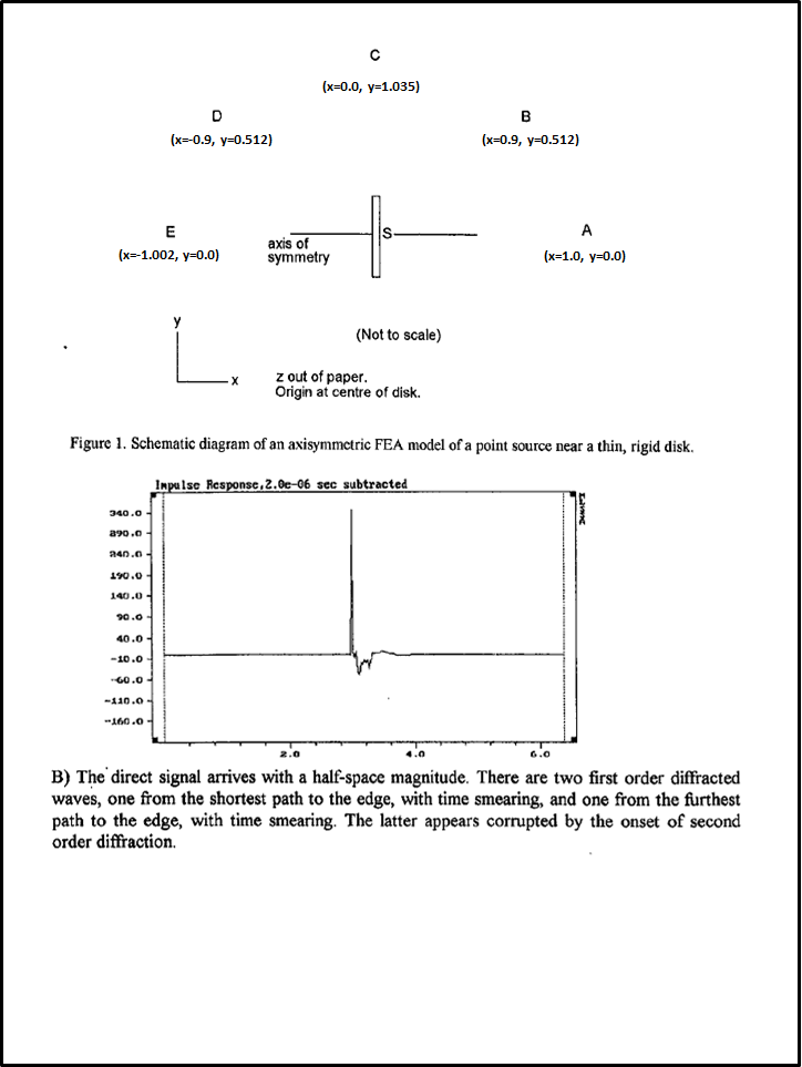

I pulled together figures and comments from the paper for angles of 0, 30, 90, 150, & 180 degrees.
The comments for C(ie90deg) are … interesting.

And how would you explain the picture C (90°) from Wright and showed above by bolserst ?
Because in the dipole diffraction model that I showed, it fits with Wright's comment : there is no diffracted wave and the direct signal arrives with free-space magnitude.
…the dipole diffraction model that I showed, it fits with Wright's comment : there is no diffracted wave and the direct signal arrives with free-space magnitude.
This isn’t quite true. The model you posted had the direct signal arriving with half-space magnitude.

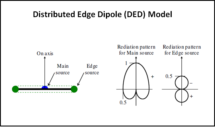

Note that in the DED paper, the model uses a direct signal magnitude that is a function of listening angle (Ps=(1+cos(θ))/2).

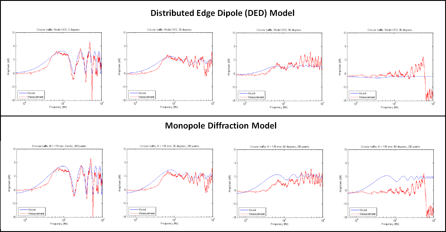

Doesn’t this produce a rather large discontinuity(calculated) in average SPL level as you move across the shadow boundary? For angles < 90 degrees you would be summing the primary source( strength = 1) and the delayed diffraction source (strength = -0.5) resulting in an average SPL of 0dB(ie strength = 1) with oscillations above and below that level. When your reach 90 degrees, your average SPL level would suddenly jump to -6dB(ie +0.5)

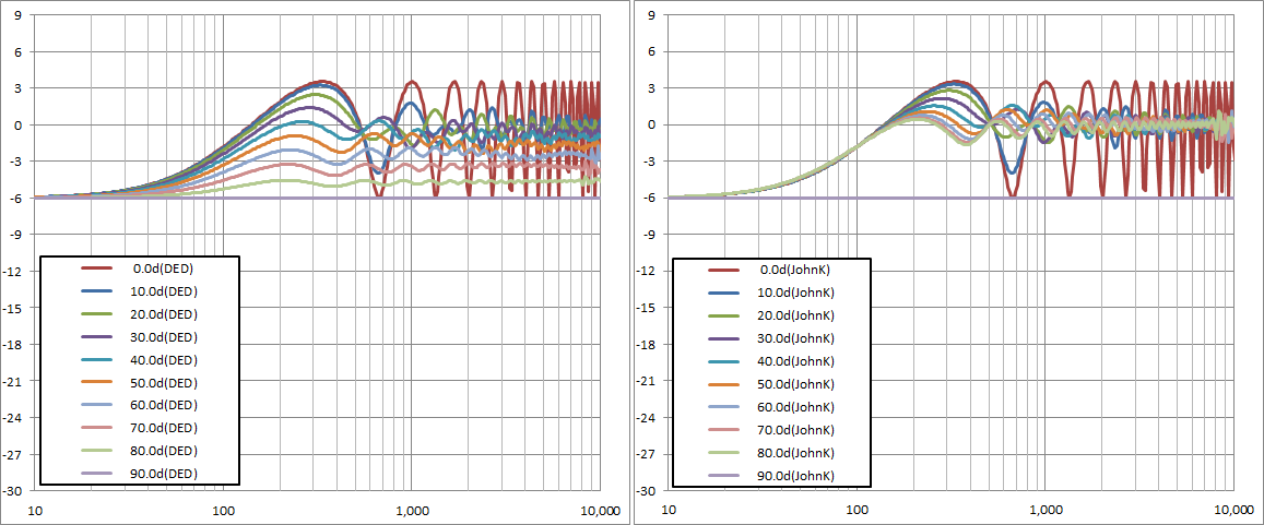

The DED model smoothly adjusted the primary source strength with angle and combines with a dipole diffraction source. In my experience this more closely matches measurements for angles > 30 degrees. NOTE that I am not suggesting the concept of this model represents reality, just that its results provide a good approximation of measured data.
Attachment 1: Comparison between DED model and your monopole model.(point source on 1m thin baffle)
Attachment 2: Comparison of measurements to the DED model and a monopole model.(tweeter on 34cm thin baffle)

Remember the DED is a "model", not necessarily a physical reality.
The magnitude of the diffraction sources are not dependent on the strength of the primary source directed along the baffle toward the edge.
Instead, the magnitude of the dipole diffraction sources are set to 0.5 of the magnitude of the primary source at 0°.
The combination of these primary and diffraction sources that are functions of observation angle result in a good fit with measured data, on and off axis.

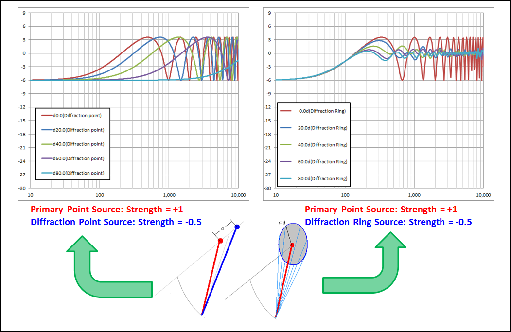

Question: (this is on my list of things to measure this year)
If a point source is placed on a 1m diameter sphere and a 1m diameter thin baffle:
How would the response compare at 0°, 90°, & 180° degrees?
In particular, would you expect the impulse magnitude measured behind the sphere to be larger than for the thin baffle since there wouldn't be a diffraction source subtracting from the primary source?

The DED model raises another question : as the diffraction model at the edge is a dipole, there is no radiation at 90°, so there should be no higher orders diffraction modes (diffraction at one edge due to diffraction on another edge). Does this fit with actual measurements ?
