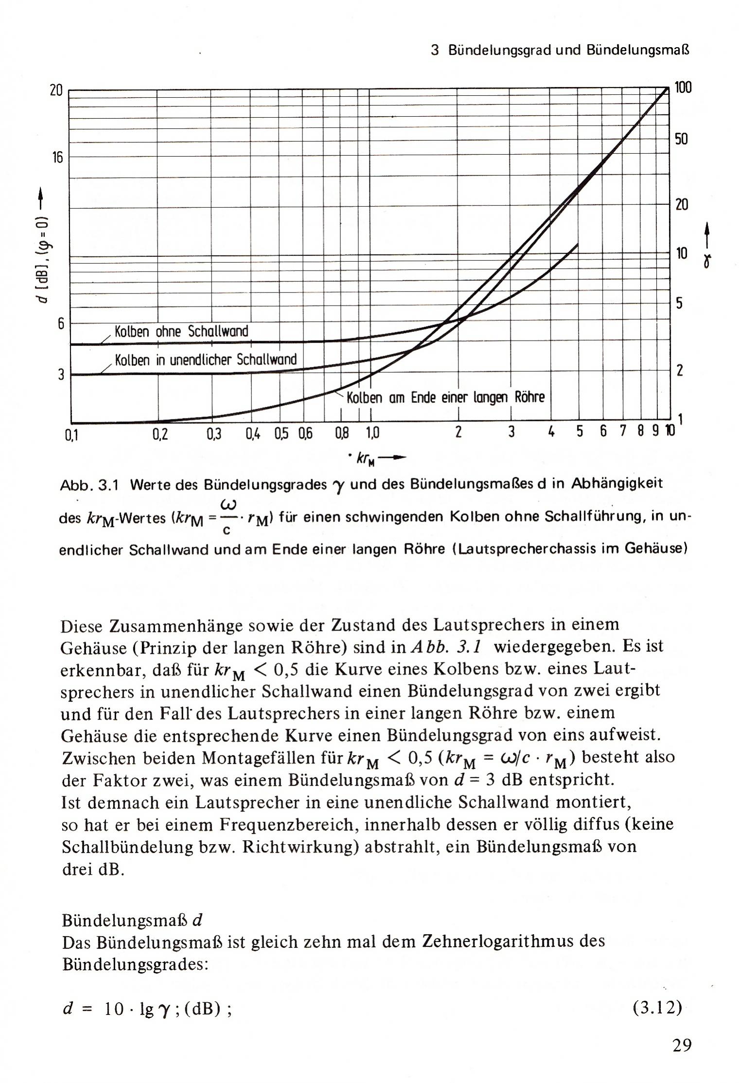

speaker dave said:
As I mentioned before, the edges only know the 90 degree response of the transducer.
Which is the 90 degree radiation as observed at the baffle edge caused by a concrete baffle applied to a concrete driver ...
Figure 3.1:
Here directivity indices of ideal pistonic drivers are shown under different idealized mounting conditions.
- parameter is Krm
- directivity index is at the left axis
- upper curve is "pistonic radiator without baffle"
- middle curve is "pistonic radiator in infinite baffle"
- lower curve is "pistonic radiator mounted at end of infinetely long tube"
from
Heinz Sahm, "HiFi-Lautsprecher", Franzis 1978
It seems interesting, that the baffled driver has even lower DI
than the "tubed" one without baffle e.g. for Krm = 2.
