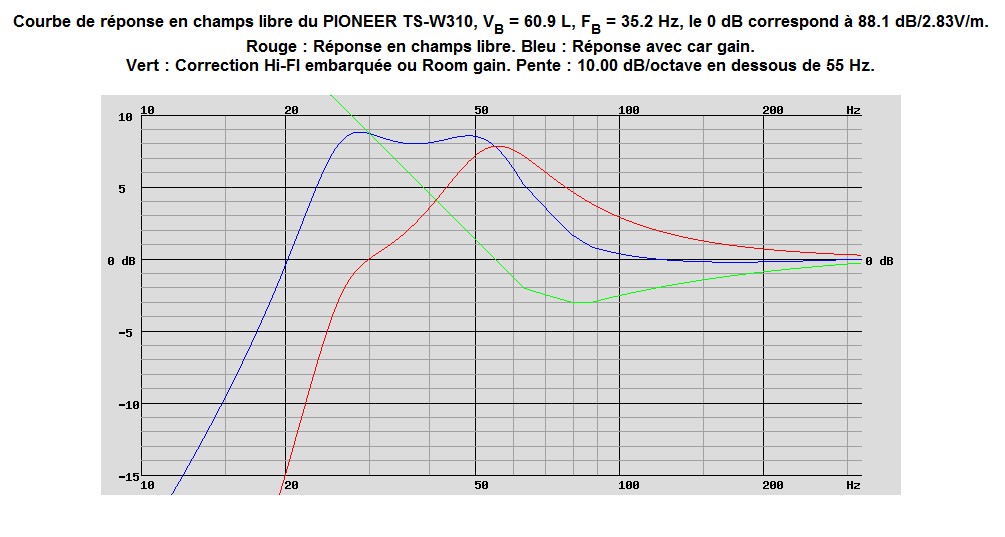

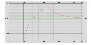

This is the driver/speaker as is:

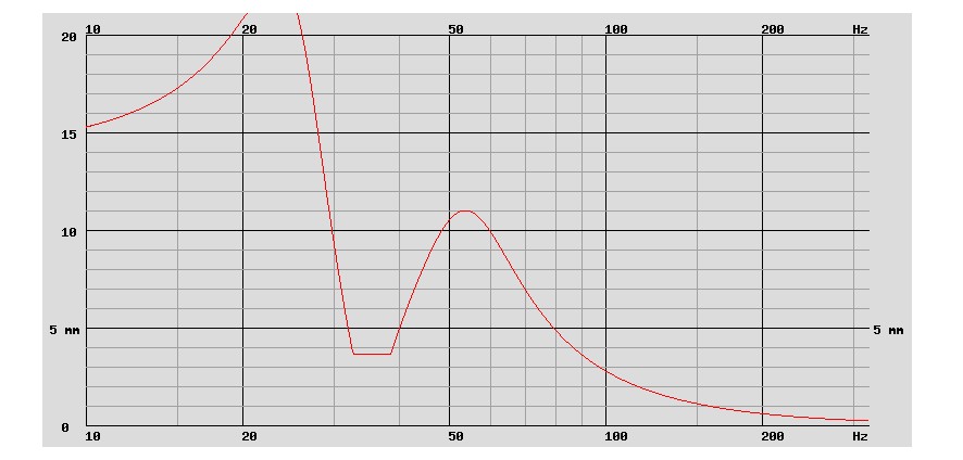

(1) PIONEER TS-W310, VB = 61 L@35 Hz, 88.1 dB/2.83V/m. (2) 54.04 V. or max. excursion.
The port is very long, already said for that kind of "bad behaved driver" and has a (port) nasty resonance at ~200Hz. Stuff the port a little (?!?)/a lot, good or not, test...

Just a theory.
It is possible that he's having an issue with "phase cancellation"; backwave nearing 180 deg "out of phase" at the "port opening". To eliminate the possibility of that being the cause, just (temporarily) block-off the port (stuff it with a pillow) completely. If the level increases, mystery solved; Just curious.

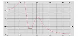

Hey guys, i recently bought a Pioneer TS-W310 to try out what kind of sound I could get for the price and after building the box I was only able to push out 105dB continuos.
Some things to help out would be the internal volume is 2.15 in3 and the cross sectional area of the port (slotted) is 43.5in2.
I should also note that i am getting excessive port noise for some reason, I have designed it in WinISD and according to everything I've been reading i should have no port noise at all with the dimensions of the box.
Before i was able to get 115db continuous out of a crappy 10 inch sub (no brand). Which leaves me to wonder why this one is performing so badly.
Any thoughts?

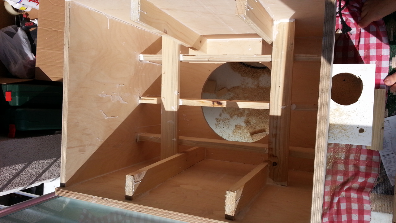

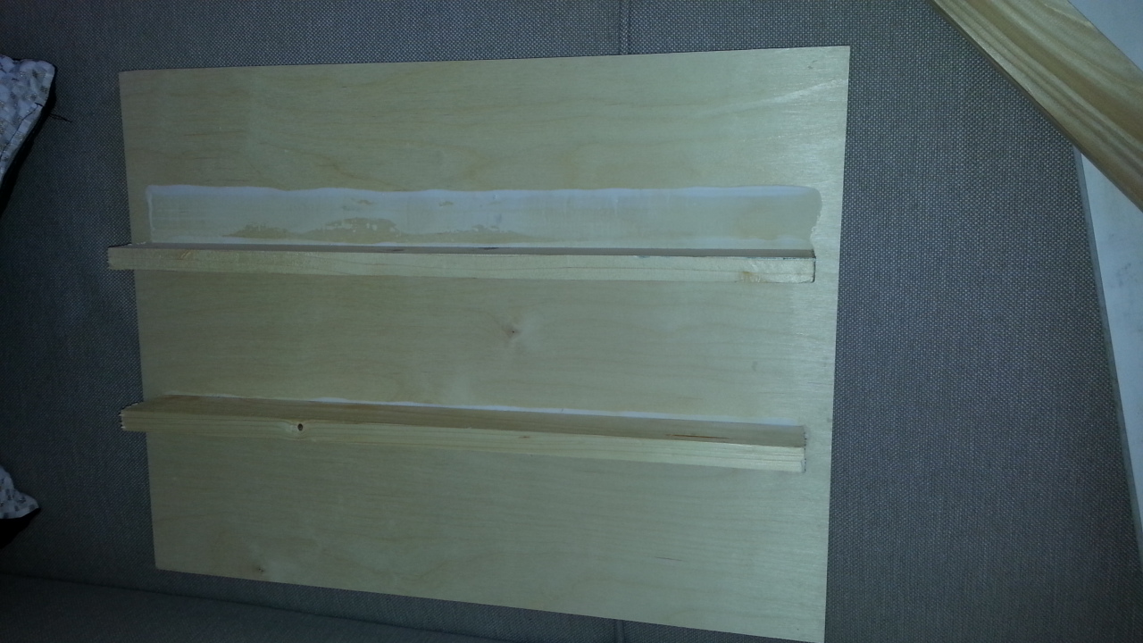

The edge on panel brace is good. BUT it must be very securely attached.
If and when the panel tries to flex the stress on the joint is very high.
Glue alone may well not be enough.
The plywood may shed a layer, when trying to remain attached.
The side to side brace is good. Very good in compression (it won't need any glue). Absolutely useless in tension.
You MUST secure the side to side brace to support both compression load and TENSION load. Otherwise it is useless.
The panel supporting the driver could do with some help.
You should try to stop the panel "panting" when the driver chassis reacts against the cone moving.
BTW,
screws into end grain do not hold well.
Use very long screws (60mm to 100mm long) with a coarse thread into a pre-drilled hole to prevent splitting.
Screws into the side of softwood grip very well. 20mm to 40mm of engagement is good enough.

I added some more wood .Here is picture
And I heard that driver side should be thicker right? Should I add and paste one more sheet on the bottom (it will be downfiring sub )
And what spikes do you recommend? I think it will be around 25kg total.Is it not light for a 12 inch sealed subwoofer ?
And i Will use linkwitz correction.I am not sure I need 20hz.Maybe i will make it 30hz cutoff
