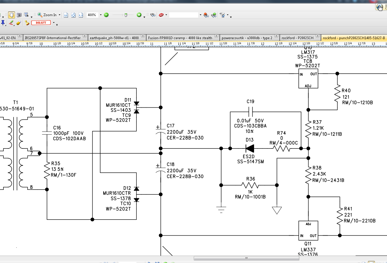

Get the diagram from Rockford but as far as I know, one of those diodes connects between the RCA shields and the primary ground. How could you read 0 ohms from the shields to the primary ground but not across one of those diodes?

Unfortunately, while I wasn't able to get a diagram from those suckers, I DID find a THIRD ED D5 diode that WAS shorted (diode D13). I unsoldered it and tested it outside the circuit and sure enough, I got continuity both directions through it. It also connects the rca shields to the ground. I tested the resistance between the ground and the rca shield with the shorted diode removed and get 0.966 kiloohms (with a fluke 117 multimeter). NO beep on the continuity/diode check this time.
I think that's what was causing the zero ohm resistance I had earlier. Perry, thank you for getting me on the right track. Is there anything else I need to check?

Thank you for the diagram (I contacted Rockford a few times for it but got no reply). I'll look it over carefully. I will need to replace that bad diode for starters, though.
If you don't have the identical diode on hand and want to try the amp, any rectifier diode will work. If you have some 1N400x diodes, you can use one for testing.
Thank you. I'll have to do that for now. I'm not able to find any with those "ED D5" markings. I'm having a hard time reading the diagram because of the low resolution, though.If you don't have the identical diode on hand and want to try the amp, any rectifier diode will work. If you have some 1N400x diodes, you can use one for testing.
In post #26 it's the original PDF file from Rockford. Some of their diagrams are garbage but this one is clean. Download and view in a PDF reader like PDF X-change Viewer (not editor).

I was opening the file on my phone and it looked crappy. I opened it on my desktop and it looks way better.

I'm happy to report that my alternator whine is GONE after hooking it up to my running car. This old amp can now have a new life not collecting dust for once. Many thanks to Perry Babin and everyone else here for the help.
