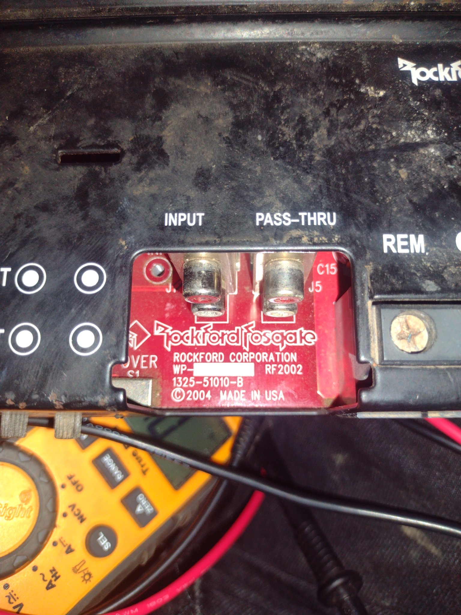

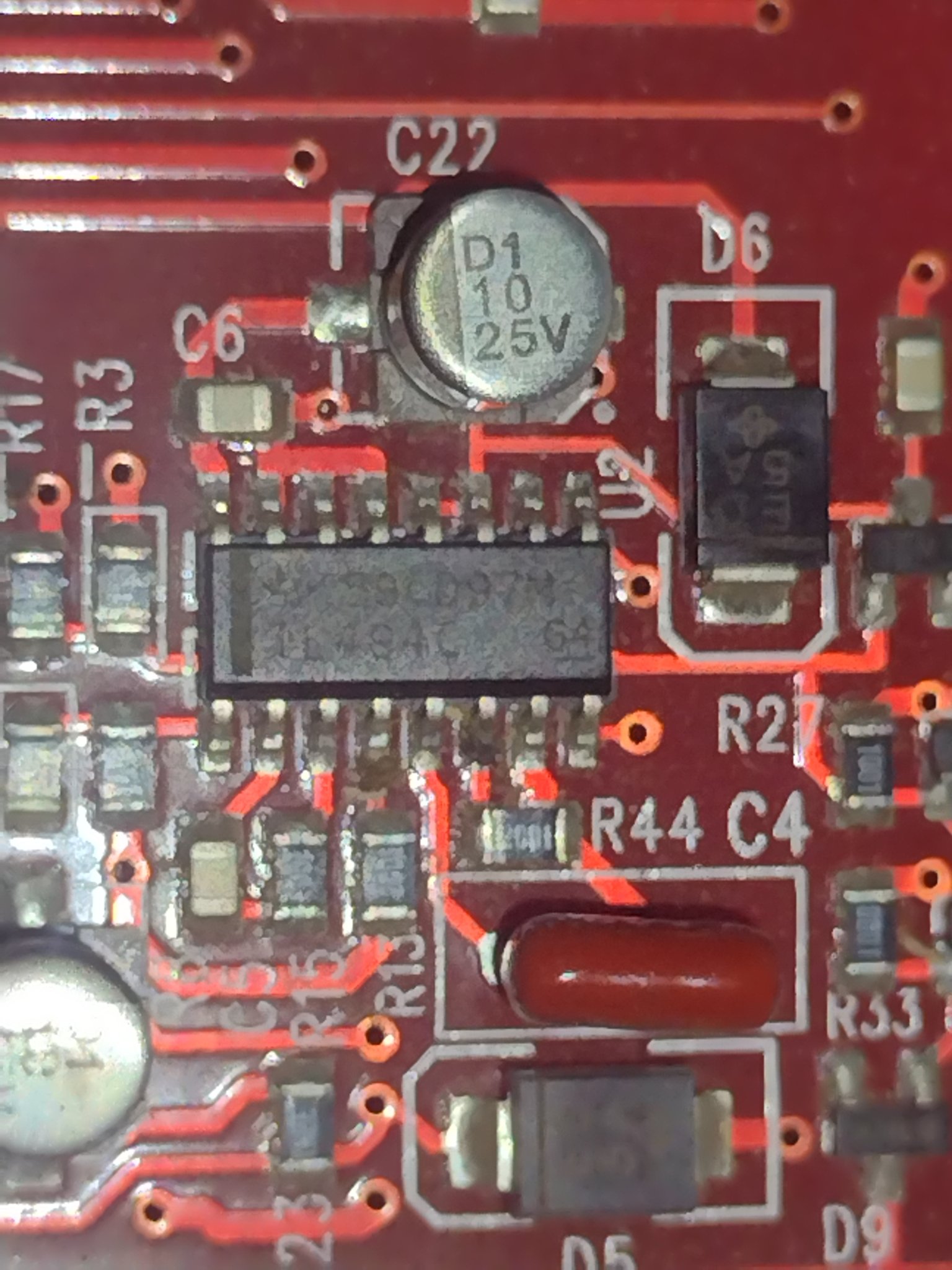

Well, I decided to take another stab at fixing this awesome amp.
Unfortunately, while I wasn't able to get a diagram from those suckers, I DID find a THIRD ED D5 diode that WAS shorted (diode D13). I unsoldered it and tested it outside the circuit and sure enough, I got continuity both directions through it. It also connects the rca shields to the ground. I tested the resistance between the ground and the rca shield with the shorted diode removed and get 0.966 kiloohms (with a fluke 117 multimeter). NO beep on the continuity/diode check this time.
I think that's what was causing the zero ohm resistance I had earlier. Perry, thank you for getting me on the right track. Is there anything else I need to check?
