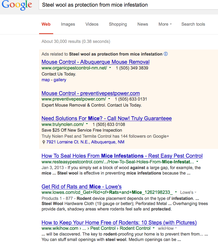

Indeed no results Googling the steelwool 🙂 I would not mind knowing a bit more about it.
Here you go:Indeed no results Googling the steelwool 🙂 I would not mind knowing a bit more about it.

Otoh it maybe a giant mousetrap.
