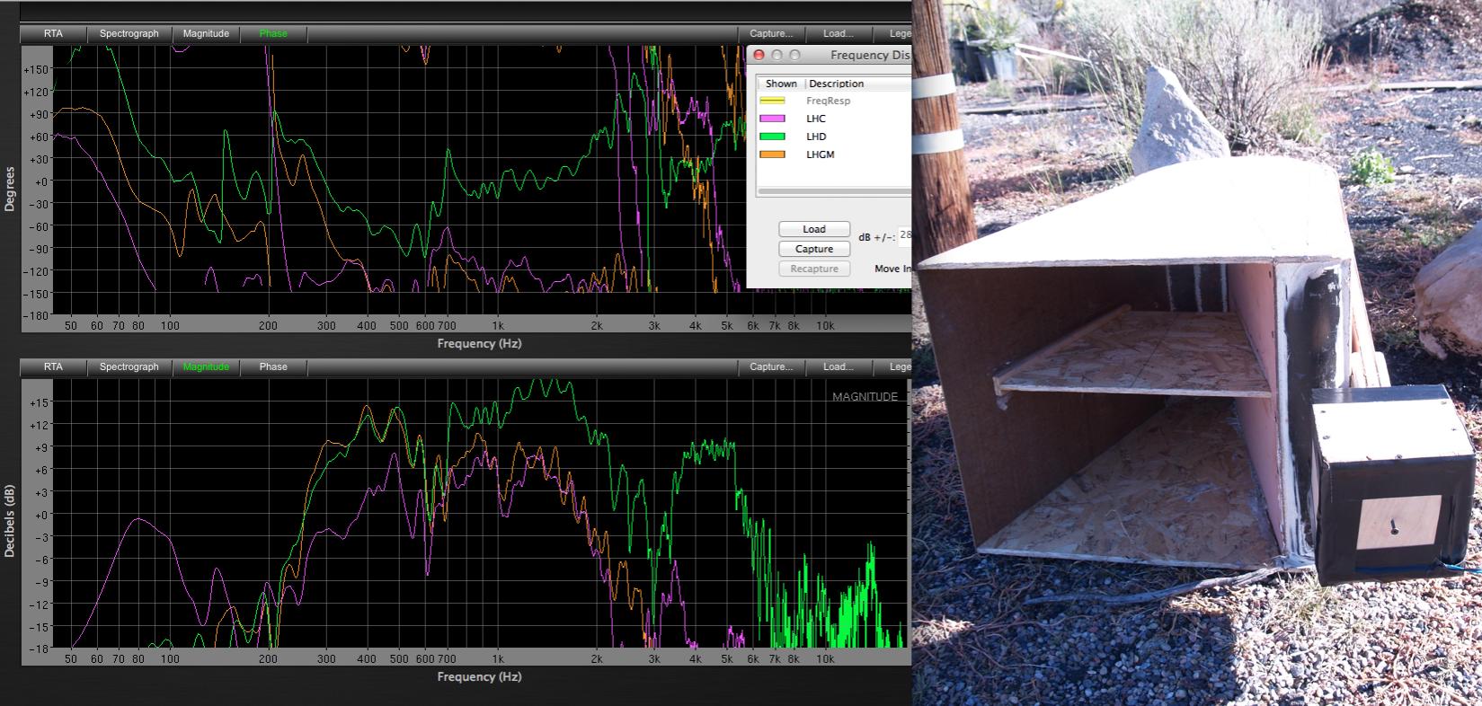

Check out the response of this four fold horn, I tried it with the speaker open also (like a BLH) response was little different.
LHC was a 4" speaker, LHD used an EVDH1A compression driver, LHGM used a sealed back 4".
LHC was the same speaker as LHD, with a couple 1/2" holes cut in the sealed back.
Thanks, very insightfull Graph, same effect as with the Jericho horn 1 page ago, the response seems to fall due to the mass roll off > valley > peaks, peaks, far into the midband. "Mass roll off" get's stranger by the minute. In a straight horn i understand midrange coming out of the horn "i can see", but in a folded horn with a backchamber (Jericho not the graphs above), where mass roll off should prevent or at least damp signal above 500 Hz, weird.

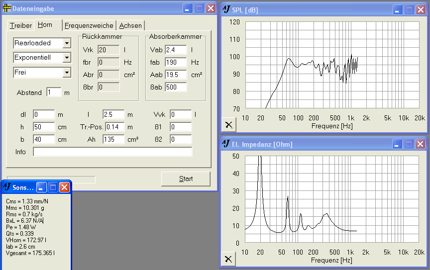

Hornresp should give you a reasonable idea of what to expect if you set the driver/mouth termination distance correctly for the combined response.
I don't expect it would be very pretty at 500 Hz, could you post the frequency and phase combined response sims?
Greenline = wall + floor placement
Redline = halfspace
Blackline = halfspace without x-over
Yellow on the x-over input screen = series LCR filter
Driver Oberton 8MB250
No ragged response around 150 Hz, where a normal BLH would have a problem. But there are some problems left around 400Hz. Please note Aj-horn is not very accurate 400 Hz and up, for a basshorn just like Hornresp.

My project is loosely based on what i have seen in Hobby Hifi and elsewhere. Klipsch La Scala is a good starting point for 3-way horns. The BK 201 (red horn) you show is one of the inspirations for the project. And at the same time the red horn is one of the reasons i choose the strange 1 /3 driver placement. It's purpose is to get the timealignment ok. This is at least a full midrange hornlenght off in most 3 way horns. I must admit i have no idea if this is an improvement:
About the peak at 270 Hz in the Aj-horn simulation. It's too far up to be killed by an Internal Helmholtz Resonator. I can flatten it with an internal resonator but i lost 2 to 3 dB from 50 Hz - 250 Hz 😡 It's my own doing it so far up in freq. brought it there myself with the 1/3 driver placement. Just as you pointed out in the difference between measurement and Aj-horn simulation seen in Hobby Hifi, i too hope reality is a little less harsh. Hope to learn how this all sounds IRL pretty soon 🙂
As can be seen i have a unhealthy obsession with driver to driver C-C distance. You can get the diy-er out of the fullranger, but you cannot get the fullranger out of the diy-er 🙄
