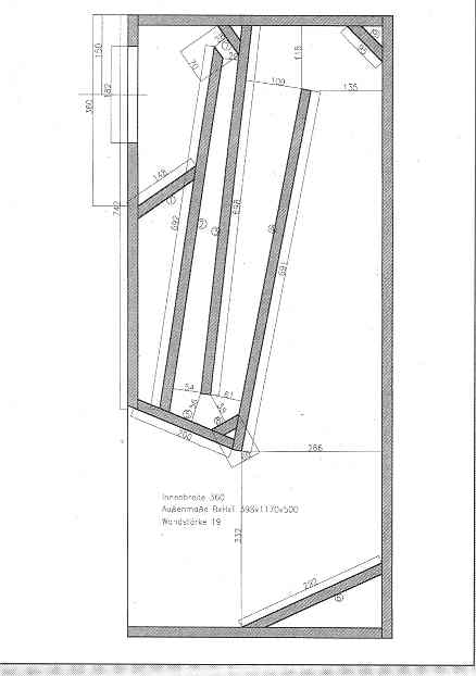

[FONT=Arial, sans-serif]These picture will probably better descibe my delusion 🙂 Both horns use the same Fostex FW208N driver; Re 5.8 Ohm, Fs 31 Hz, Qes 0.26, Vas 12 liter, Sd 204 cm2, Le 0.51 mH, Xmax 6.5mm. [/FONT]
Blackline; classic Fostex BK201 horn
Hornlenght 1.70 meter, Vb (compression chamber) 7.3 liter, exponential, throath 155 cm2, mouth 750cm2
Redline; back loaded horn with driver placement offset.
Hornlength 2.50 [FONT=Arial, sans-serif]meter, driver offset 0.865 meter from start of horn, Hyperbolical flare. No compression chamber, throat 70cm2, mouth 750cm2. Driver offset from end of horn -0.31 cm. [/FONT][/FONT]
[FONT=Arial, sans-serif]Let's pretend we can we shorten the “redline” horn to below 2 meters and thereby shorten the pathlenght in the horn. Making it more usable in the midrange...? Less delay...? Use a lower Qes driver etc?

None of those are really 'horns' tho are they? Top is more a BVR the second is an offset TL. Slightly pedantic but I was under the impression true horns were defined by pretty specific maths.
I am not that interested in the true definition of horns. I am interested in how the backwave is handled. There is probably a better academic for backwave... A study showing a horn with a low Qes driver with a smooth path compared directly with a rough path would be welcome. A link where this is done in transmissionlines would be welcome to. I am interested in the crossover point from backwave to driver, in what i would call a backloaded horn.

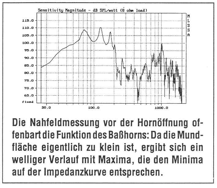

I am familiar with single fullrange speakers. And what they can do in Back Loaded Horns. From a recent link in a HM art thread i found these numbers for the summation effect. Two sources need to be under 1.5 ms from each other to sum correctly. There is little information (links welcome!) about this effect in regards to Spl and frequency.
It would be nice if we had a curve like this for hearing delay in regards with spl and Hz. The maximum length of a horn and where the high cut off (mass roll off, volume of chamber, etc) needs to be would imho follow from such a curve.

BTW I built something similar to the Jericho horn in 1997 ( a little late ! That project is from '96 ) with lateral mouth. Some drivers passed around ( replacing the dead ones 😱 )the first being Pioneer then Goldsound ( Similar to Pioneer's BOFU !?! ) which were 7" now it houses a Vifa 8". Now they're two ways with a 2" mid-tw in a BIG 8" waveguide ( made from a a dead speaker, guess...). Sort of mix between the jericho design and an expanding TL by putting some resistance at the terminus /mouth.
But real bass is another thing, or it isn't ?

Nearfield measurement of the mouth of the Jericho horn.
Seems the bandpass limiting effect of the small backchamber is not that great. -6dB at 1 kHz there is still an awful amount of noise coming out of the mouth. Pico, i just did a google search for lateral mouth (....) feel free to post a picture to show what you mean. Breaks down the language barrier!
